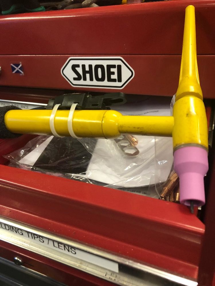

Hello Sergei
I have some questions about your torch:
1- wich size was the eletric cable 16(5mm copper)) or 25mm (7 mm copper)
2- The conection between the difuser and the torch screws well? i tried and felt that they are compatibel on size but not on thread so if i want to connect well the two i must but a 3/8 unf conection i not expensive.
3- the silicone hose that you use is a 12/6 mm? if using a 16mm copper wire plus some kind of isolation (teflon) it will not fit. The 16mm copper wire will suffice for 150 amps.
4- check this guy that made an all round cable so he can fit a 26/17 or 9 torch seeand
5 where do you get the hoose? any specification on it?
6- wich diameter has you plastic handle on the torch?
Thanks
On one of my videos there is a brand of cable (tag). A simple cable will not work. How suitable the audio cable, I do not know.Hi there
A have one more question:
Where to buy a cheap flexible copper wire in europe? audio cooper wire? any reference code on it? or simple welding cable?
