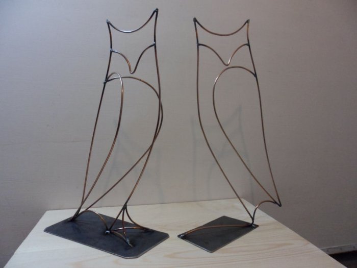

I have been asked to prepare a quote for a customer, they want a three metre tall metal owl like the one on the left here
Mounted on a brick plinth with a set of railings around it.The model above is made of 3mm welding rod and was knocked up in a few minutes, the full sized version will be made of 20mm bar and have a few braces included.
My main question, the customer wants a set of railings to keep people from sitting on the plinth. Do the railings have to have gaps no bigger than a 100mm ball? If they are not railings but more of an extension of the sculpture does this still apply? In this case I am thinking of a simple 2d abstract structure going around the edge of the plinth.
I am confused by the gapping business, I have browsed contemporary railings and there are some you can even climb through that are used on local government projects.
We are hoping to build something simple and elegant incorporating the owl motif in two dimensions.
An example of spaced out railings from Gateshead
edit, does this cease to matter if the spacing is above a certain size?
