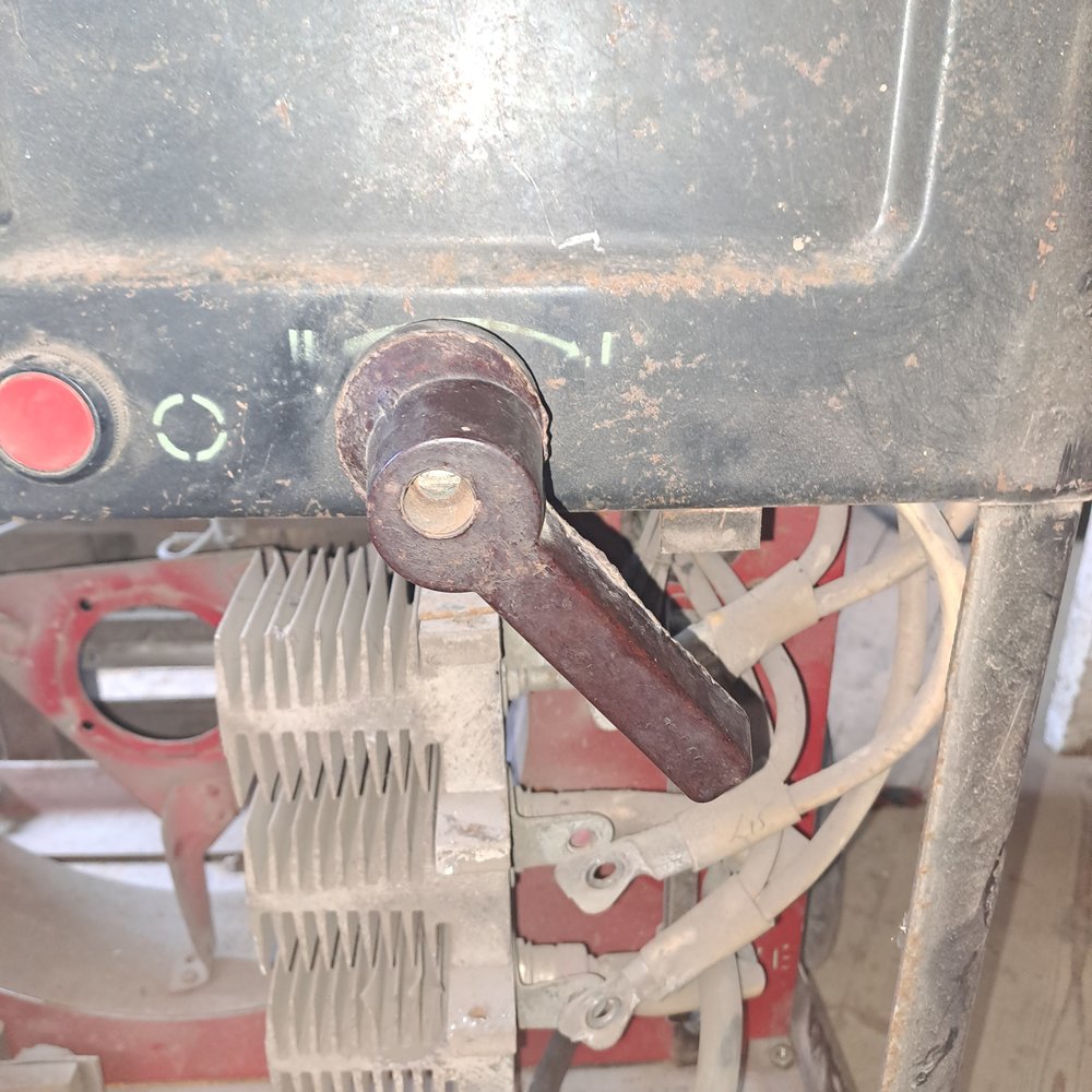

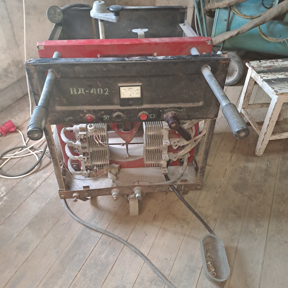

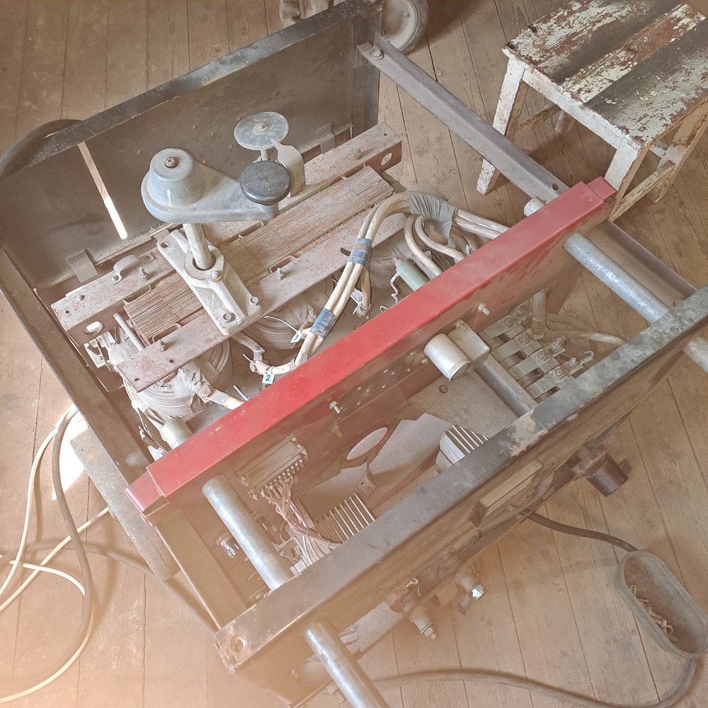

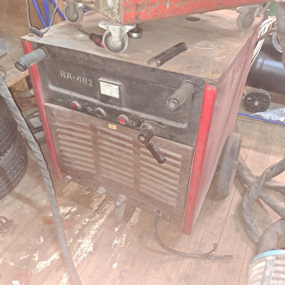

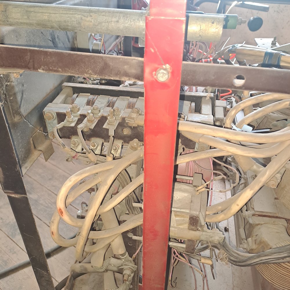

Hello, recently got this old welder basically for nothing, trying to fix her up. If someone has the electrical schematics for it or any information it would really help me out.
And does anyone know how the current adjuster in the last two images works? The main way to adjust the current is by lowering or highering the primary winding with a screw, however there is this second adjuster with two options right or left and I'm unsure how it works. It's not a tap to the windings since there are only 6 terminals on the primary and secondary (2 for each phase), could it be a rheostat? It seams like the current would be too high? It has 6 inputs(3 phases from the mains and 3 high amperage from secondary) and 6 outputs.
Thanks in advance for any input!
