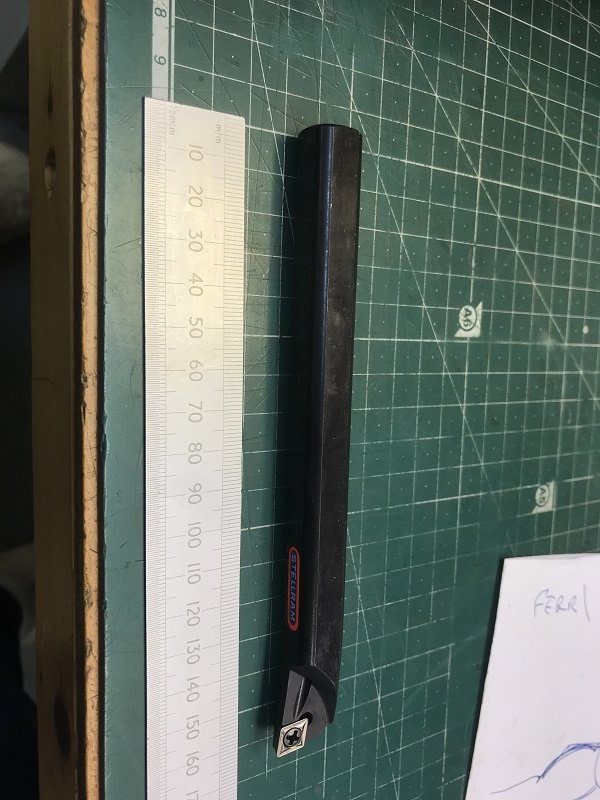

I have a lovely 16 mm carbide boring bar with through coolant - a STELLRAM E115V16L that takes "EP--0803--" inserts but I cannot trace a source.
So if anyone has any knowledge as to where some may be lurking please say.
They are VERY similar to a CCMT080308 except that the retaining hole is larger on the Stellram at 4.2 mm (as opposed to 3.2 mm)
Stellram, who were in Melksham in Wiltshire, seem to have vanished off the face of the earth, their phone numbers aren't answered and their web site doesn't respond so I expect that they've been gobbled up by another manufacturer
. . . any help would be appreciated
