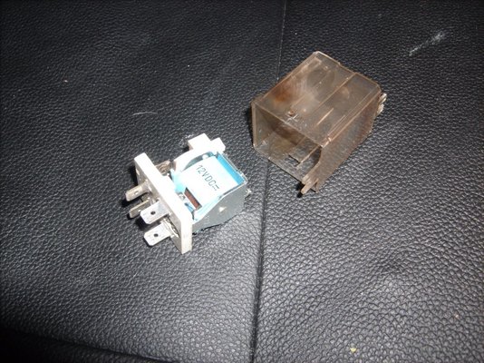

Got a prob with my SIP Autoplus180 mig. Sometimes when pressing the trigger nothing happened, sometimes it worked perfectly, today it was more not working and annoying, so I checked the contacts in the torch, cleaned them and they seemed ok, checked connections where cable etc connects to mig, all ok, then took the covers off the welder and after some searching for dodgy connections decided to try it with the covers off, I could see quite a bright flash through the transparent cover on the electro mag switch or solenoid or relay (sorry I don't know it's proper name) which feeds the wire feed motor and gas valve. When I bridged a screwdriver over the contacts the wire feed motor ran and the wire speed adjuster control worked as it should. Thing is, sometimes when I was bridging the contacts there was a little blue spark as I imagine should be, but sometimes it was quite a big flash, enough to burn the point off my screwdriver. Does anyone know why the extra current was and why only sometimes please? I have had the mig from new for over 20 years but I doubt if it's used 40kgs of wire in that time.
