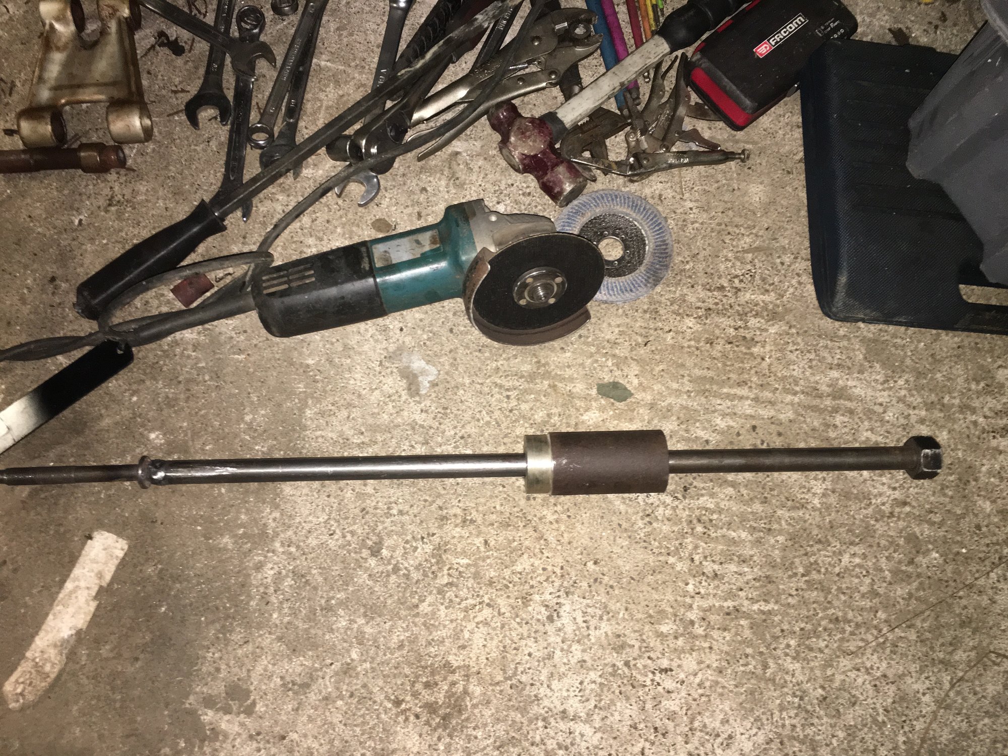

Working last night so thought I'd take advantage of a workshop full of equipment and some steel scrap.
I already had an m14x1.5 bolt here so knocked up a big eff off slide hammer.

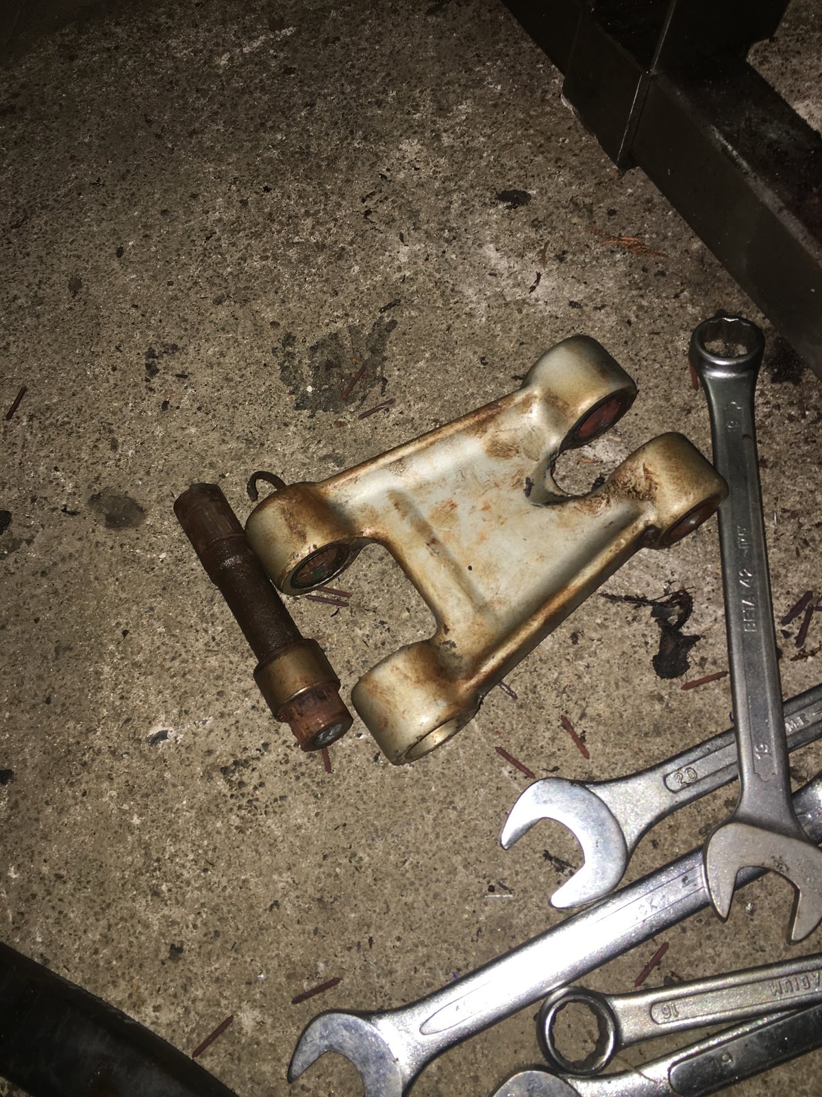

It certainly made a dent in removing the rusted suspension sleeve, unfortunately it removed about 4 threads of sleeve at a time, so in the end I resorted to a 1mm slitting disc and a 115mm disc cutter!! At least I can now move forward with the repair.
