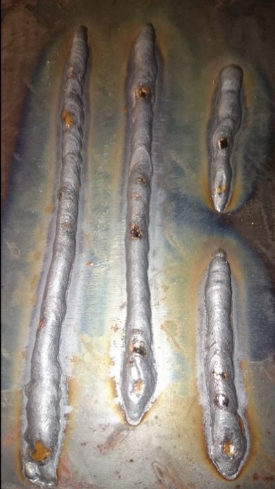

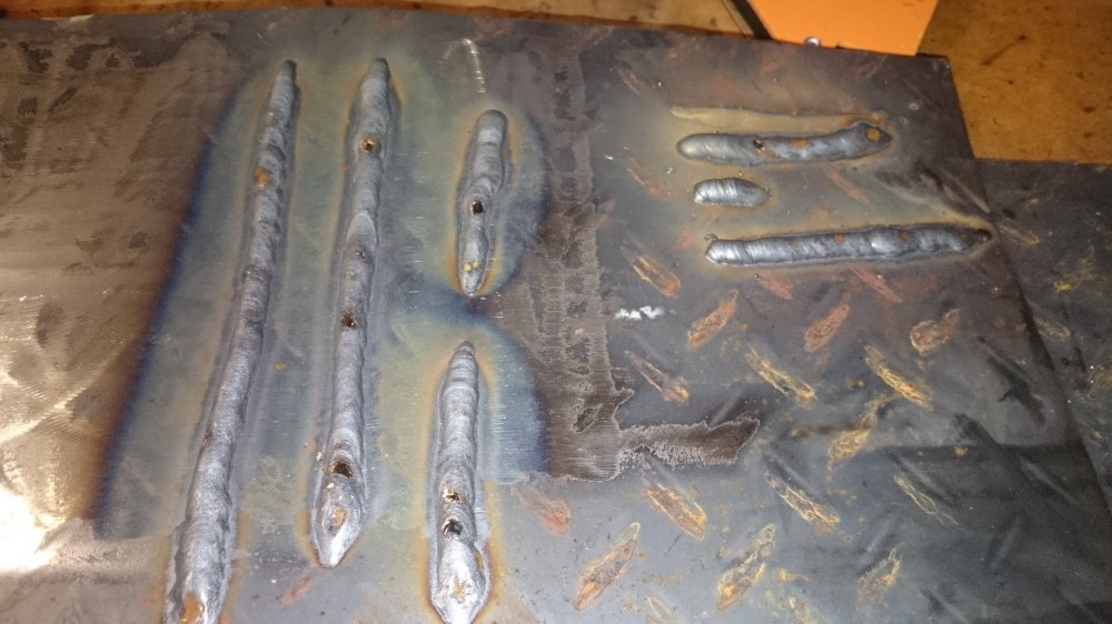

T TheRealTy New Member Messages 13 Location Brisbane, Australia Mar 16, 2016 #1 Hi guys, just did some more welds after my last fail. Started top right then went back and did another run below. Started getting better after the last one on the top run. Bottom left is me pushing instead of pulling..
cumbriasteve Moderator Messages 9,645 Location Cumbria UK Mar 16, 2016 #2 Your first attempts were far from fails, as a newbie to the game they were very good. Still think you are running a bit cold though and perhaps a touch too much wire feed, they are just sitting a bit high. It's very rare I 'pull' weld, the 2nd one up on the left hand bottom corner is looking closer to what you should end up with.

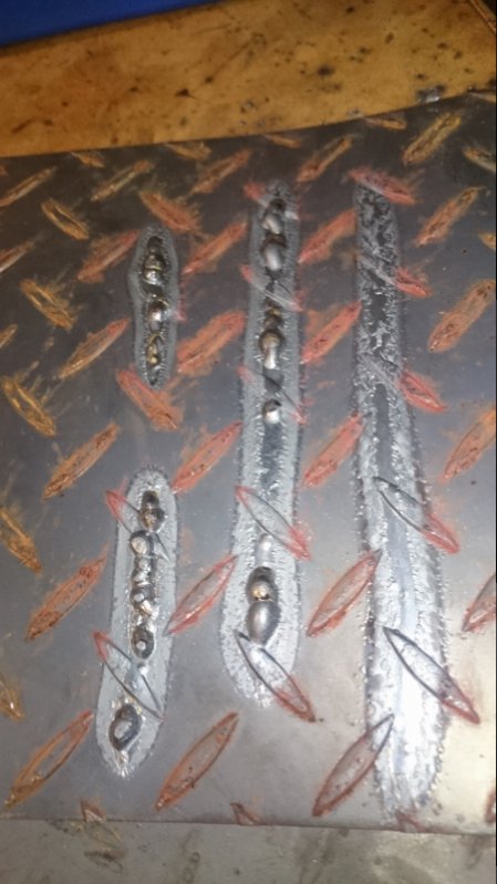

T TheRealTy New Member Messages 13 Location Brisbane, Australia Mar 17, 2016 #3 A bit more of a play, I am thinking maybe too hot? Weld hanging out the bottom.. Right to left.. close-up And the back
