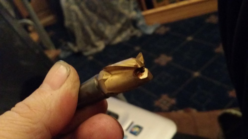

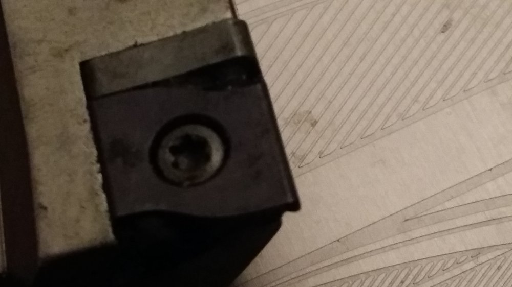

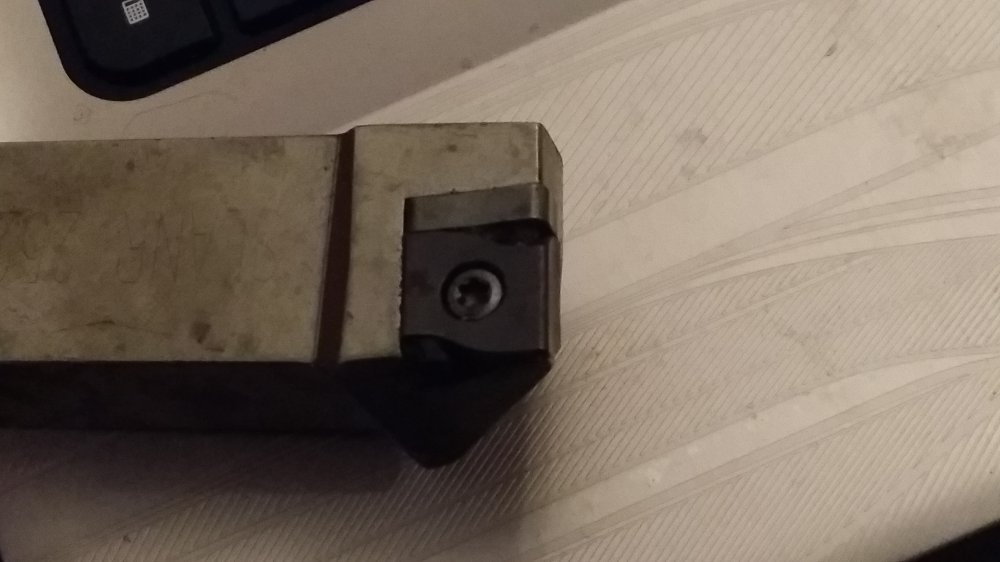

Yeah I know that bit but the tip is weird and it has a packing piece to the side of it..a lathe tip tool on its side![]()

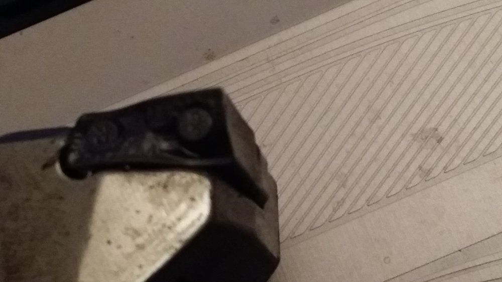

I often come across tipped tooling that has been packed out with a smaller tip and visa versa...ive done it myself when i have,nt had the correct coded tip for the holder and it needs jacking up.Looks like a broken carbide insert bodged in place with a smaller insert.
eggs sackleeIt's a kludge and your tolerances can go to Hell in a handbasket if you pack the tips, though. For roughing out it's OK but forget it for close tolerance work.
