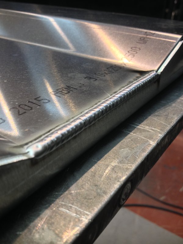

The Alu outside corner/lap looks very neat. Watch the crators on the run ends mind.

Yes they are very nice units. Produced in Japan by Panasonic iirc. Quite rare to see them around nowadays given it was 5 years or so since TA stopped badging them. Yes a phase down on the foot pedal will give the control over the speed at which the pool solidifies to prevent crators. I only mentioned it as it looks like one sat on the end of your nice neat run. Alu has a tendency to crack from there if under stress. Nice and tidy though. Look forward to seeing the other jobs.last of the sanrex type i think)
