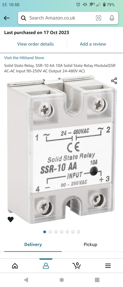

Hi folks,
In our downstairs loo, which we've recently done out so it's not straight out of the 1950s, I've wired a infrared panel heater, one of them slimline wall mount jobbies, to come on with the lights via a solid state relay, as I wasn't happy having it on the light circuit, so it's spurred off the socket ring, to a switched fused spur, which is screwed to the front of an adaptable box with the relay inside.
The trigger is basically a spur off the feed to the lamp (LED dome bulkhead type fitting, brand new), the power feed as I say is from the socket ring via the fused sour, and there's a flex run in conduit to the heater.
For some reason, it'll work fine one pull of the light switch, and won't for the next few tries. Basically it's intermittent (now I haven't had my Multimeter on the relay output, just going off the led indicator on the heater panel). I haven't used a solid state relay before, I know it's worked up right, so I'm wondering if its because it's a 10A relay, with a 350w load triggered by a very low current led lamp. Does it need to see a higher load, or higher resistance on the trigger?
Any help much appreciated,
Cheers, Dan
