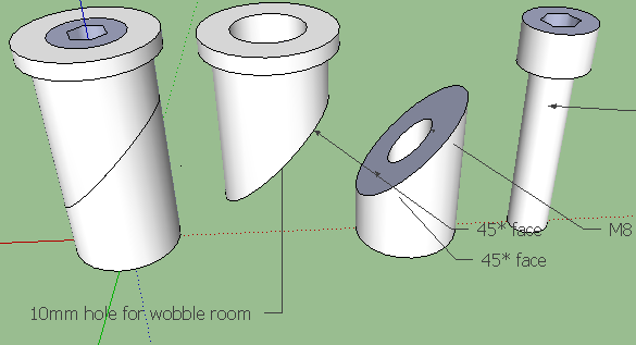

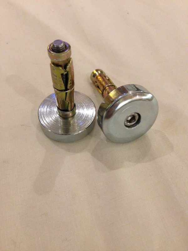

i am looking to make some bar ends for a motorbike proj ct. I need some rubber rod that is 8mm internal and 22mm ish external diameter that I can put a bolt through with a washer and nut on the end so that is it tightens it draws the nut up and expands the rubber inside the end of the handlebar and keeps it in place.
Any suggetstions?
Any suggetstions?
