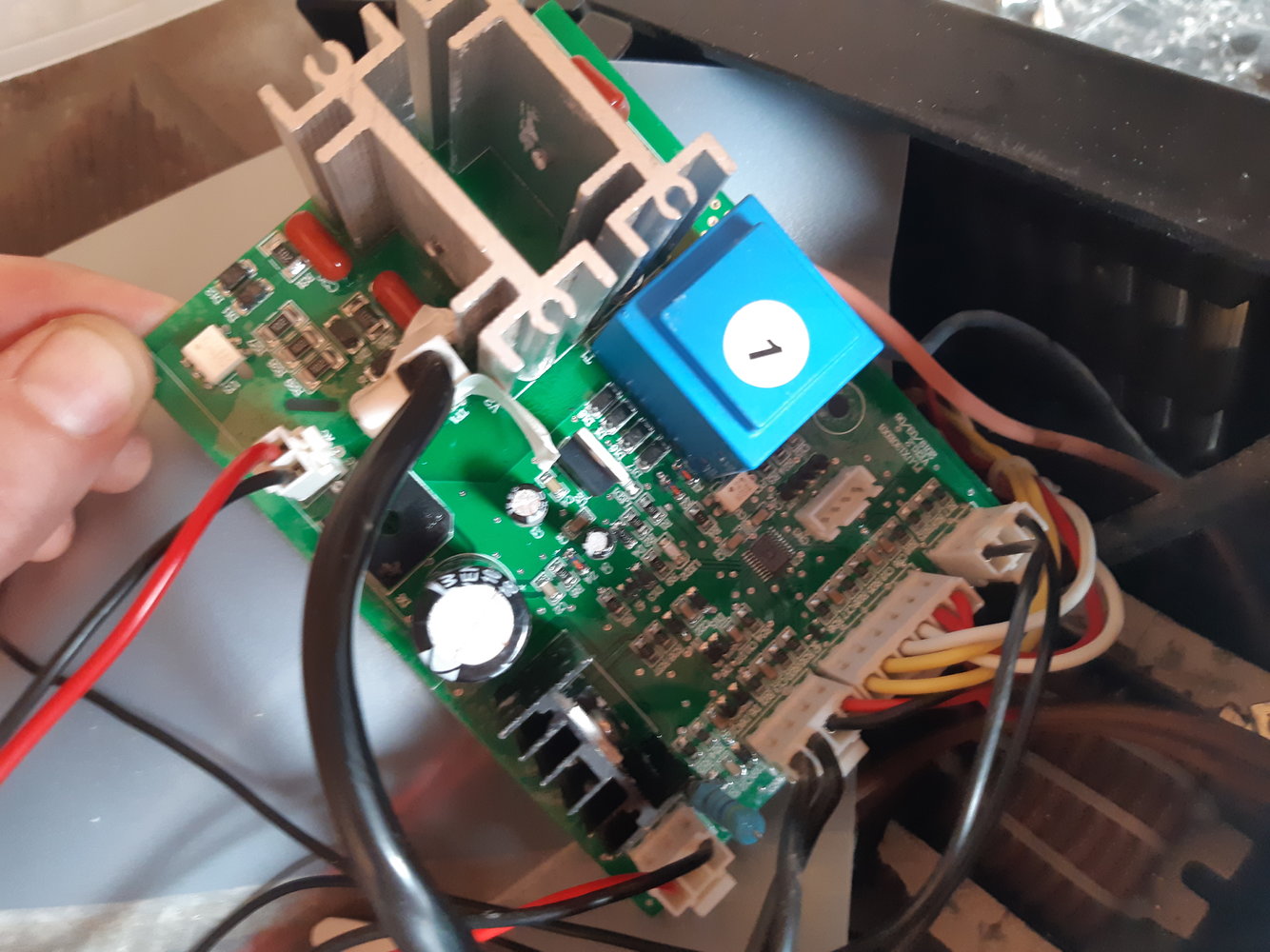

People may have read my previous post about modifications iv carried out on my welder, it's a lumber Jack mig master.
Mods I've carried out so far, fit a euro torch, fit a rectifyer (AC-DC), fit a coustom coil and made it so I can change the polarity for welding.
My problem is now the solenoid, I was hoping to run it off the 12v trigger return which is 12v but when I connect the solenoid it stops the welder from working, so the the wire feeder don't run and I get no voltage at the mig tip.
So now I'm a little lost on what to do,
I did wonder if running a relay off the mig trigger would work then have the solenoid run off is own PSU
The trigger wire is the bottom right any advice would be appreciated
