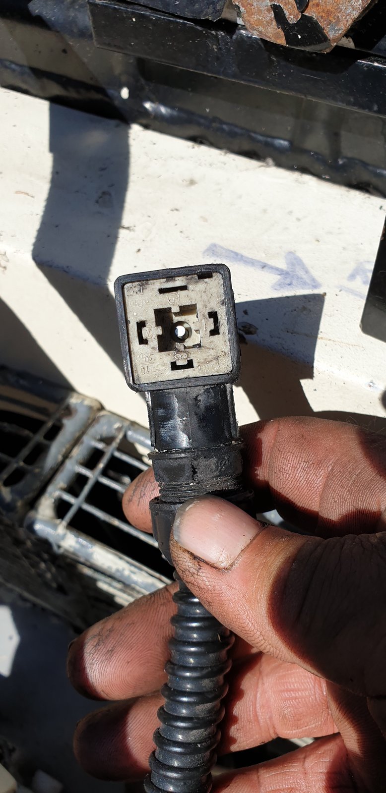

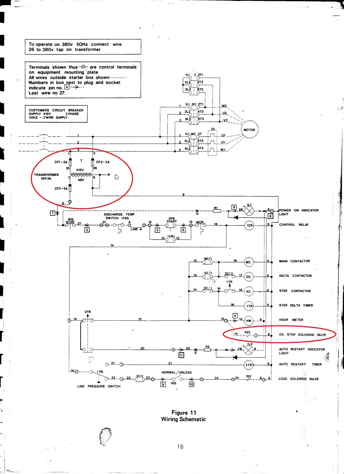

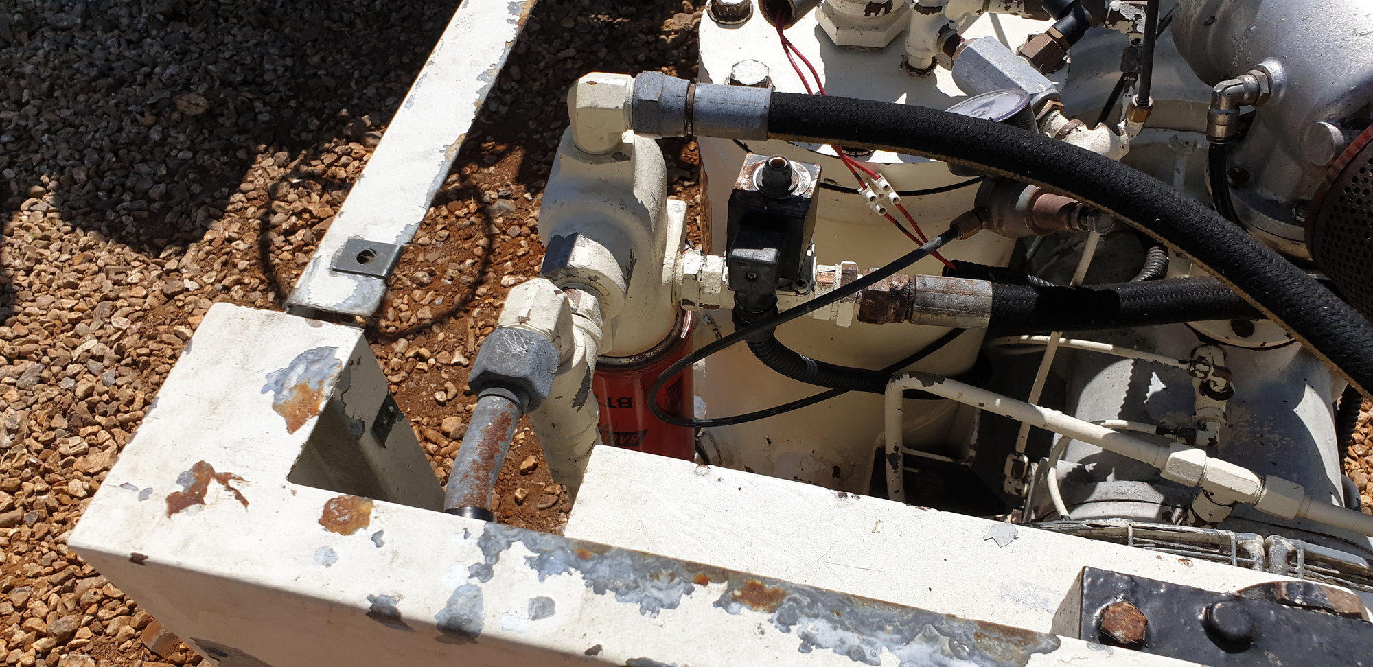

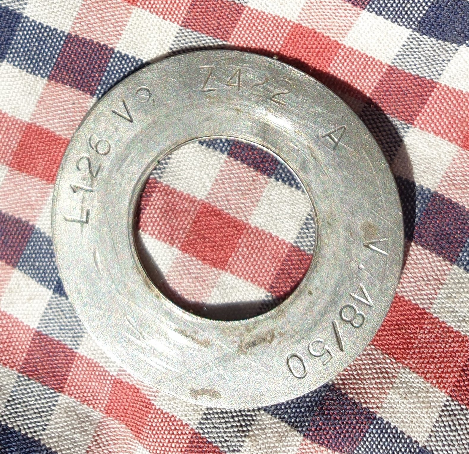

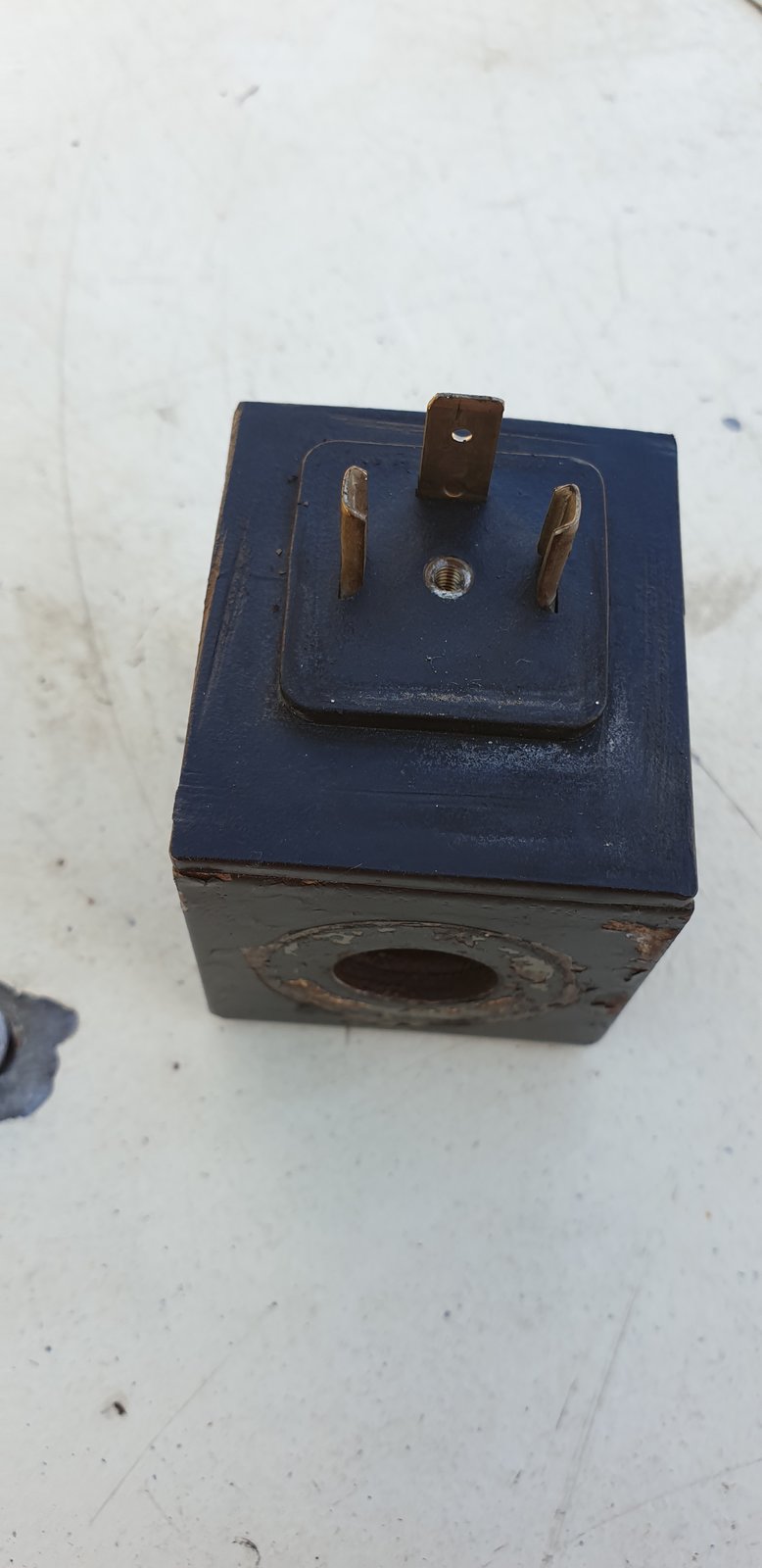

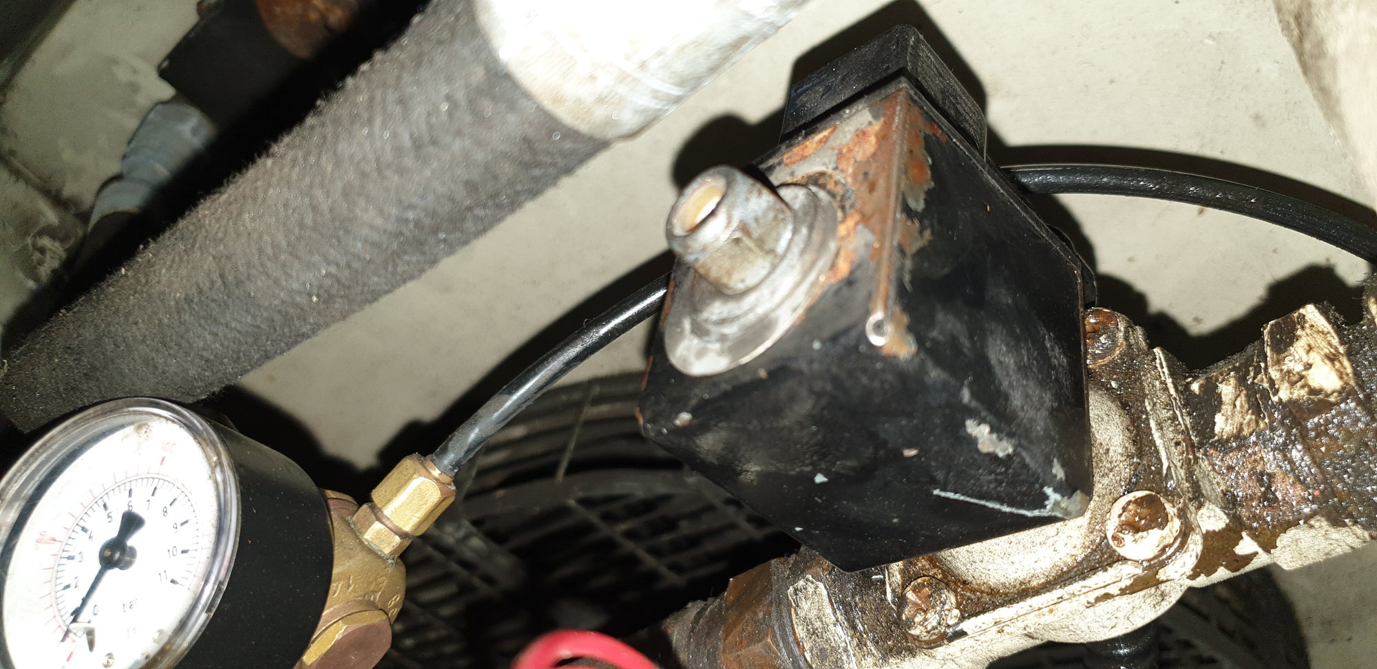

What's the power supply arrangement? Transformer or PSU?
What about putting an auto-ranging meter on the plug pinouts? It should automatically detect the voltage and whether it's AC or DC.
Psu - power supply unit - a dc power source to provide low voltage DC control voltage, in place of a transformerI know what a transformer is whats a PSU![]()
Any signs of diodes or capacitors if not then will be AC.Just having a look at the wiring manual there is a transformer
I’d say it’s an ac coil looking at the markings - 48/50 would mean to me it’s 48v 50 hz
more than likel they used to stamp it on all british stuff . presume u have tested the coil for continuity and voltage to the plugI did think does the 50 mean hz
will do tomo, thanks brightspark

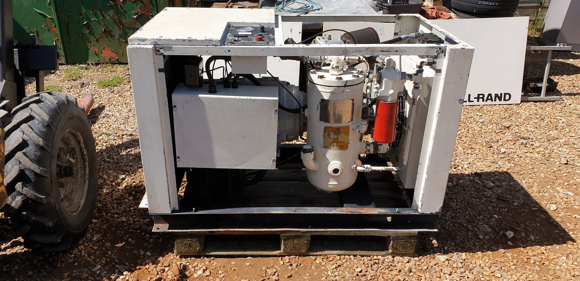

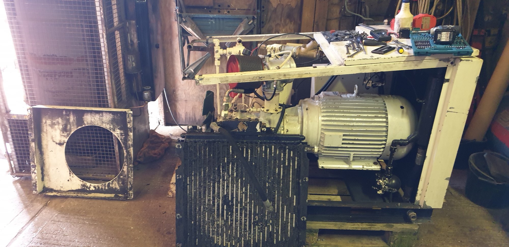

which means nothing to me. I have to disconnect my original compressor first to get this one on line, hopefully its on the cards over this weekend, time permitting. I am hoping to have this compressor up and running asap, as It is the same make and model as the one I am running now Ingersoll Rand SSR ML30. The one I use has 48000hrs on the clock

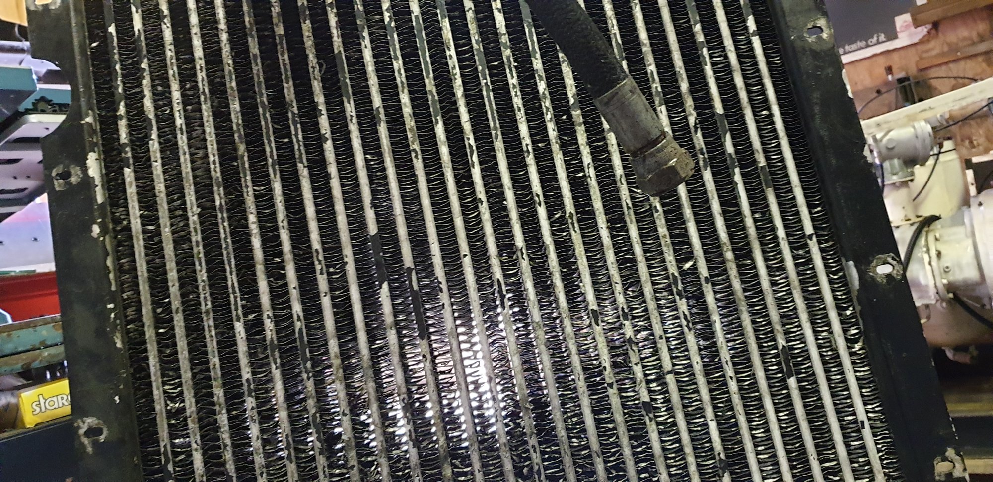

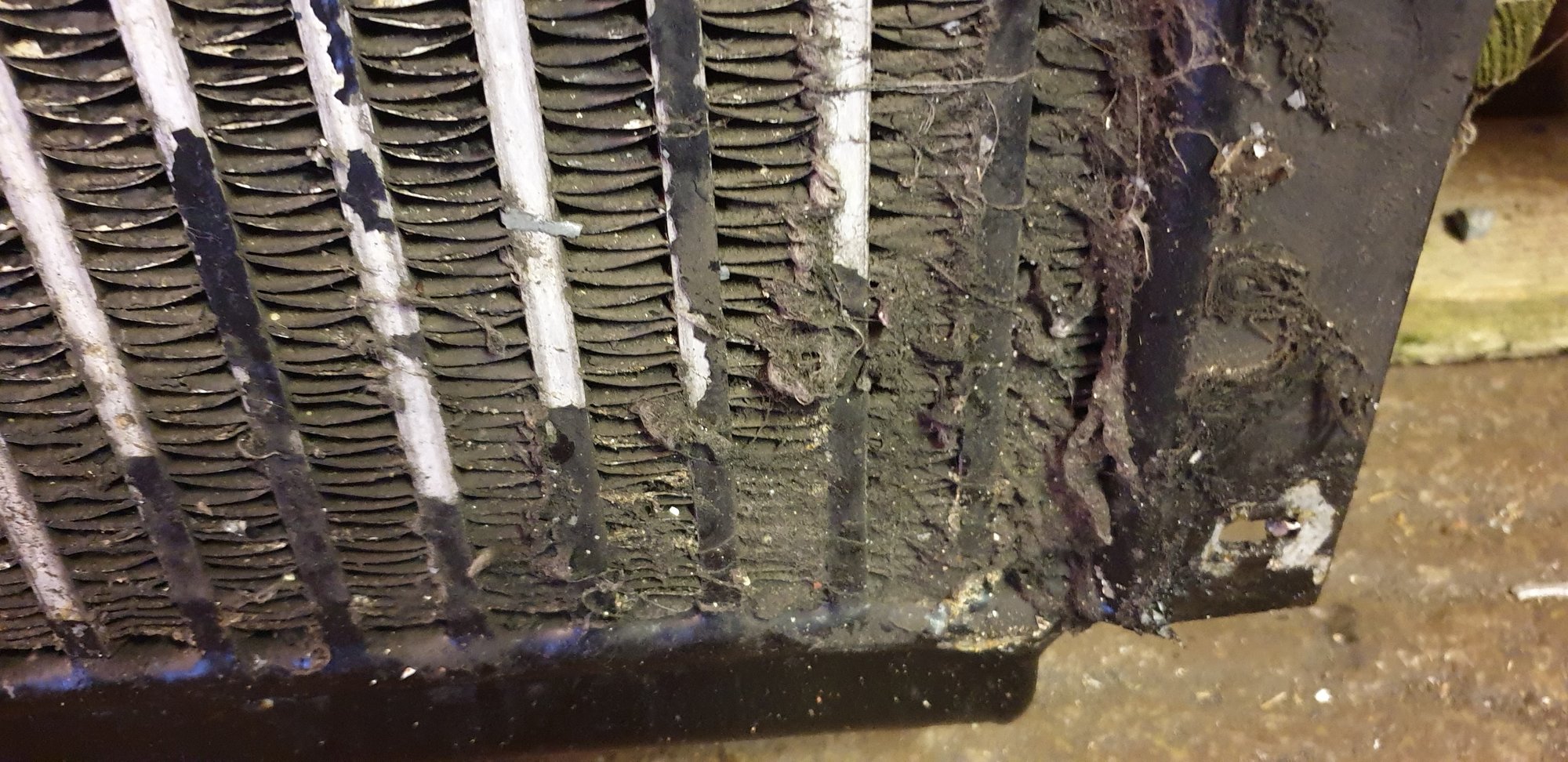

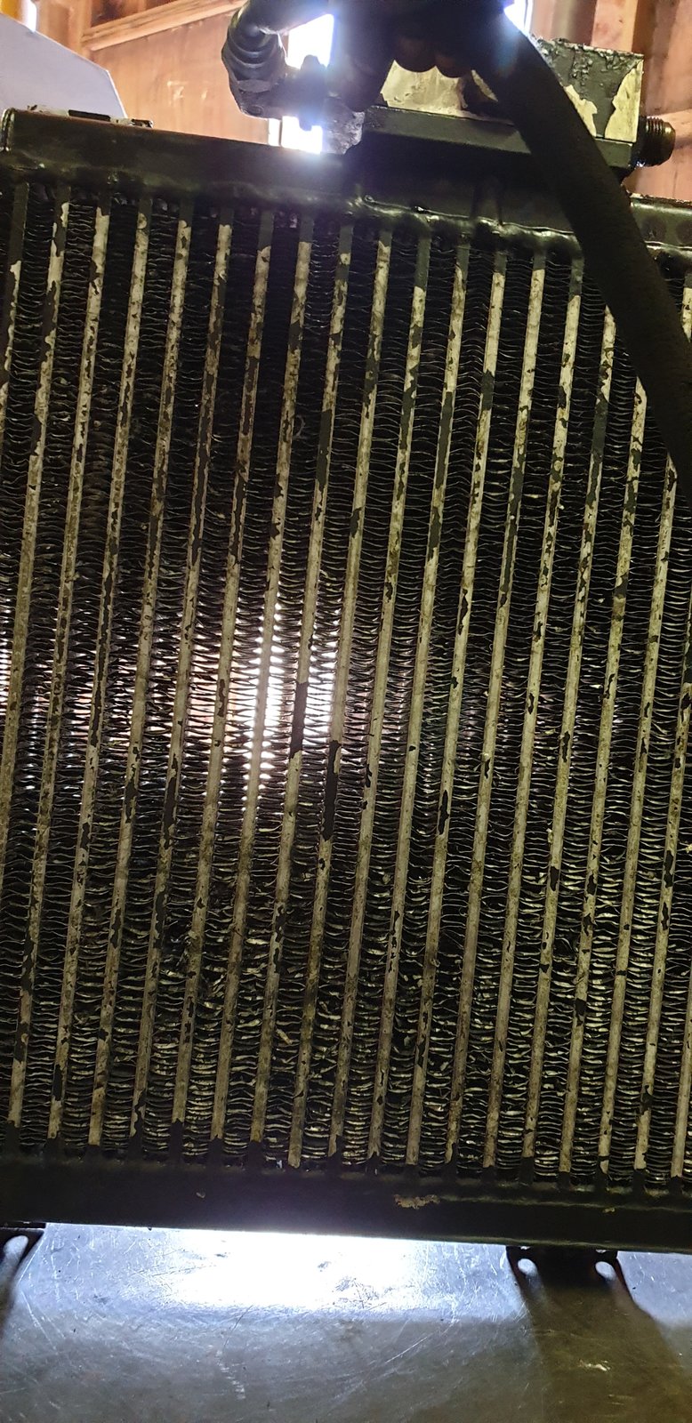

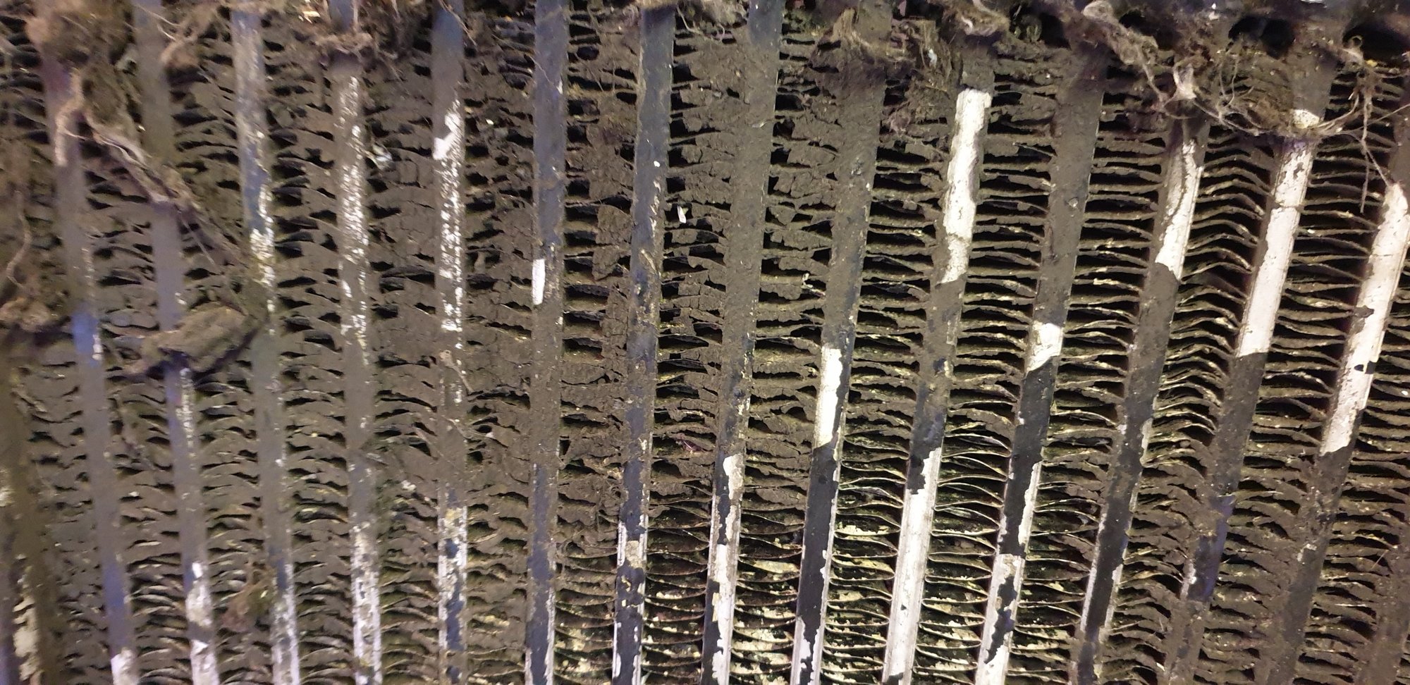

who ever did the servicing on this machine should be
sacked, although its turned out great for me.
air can get through it.
