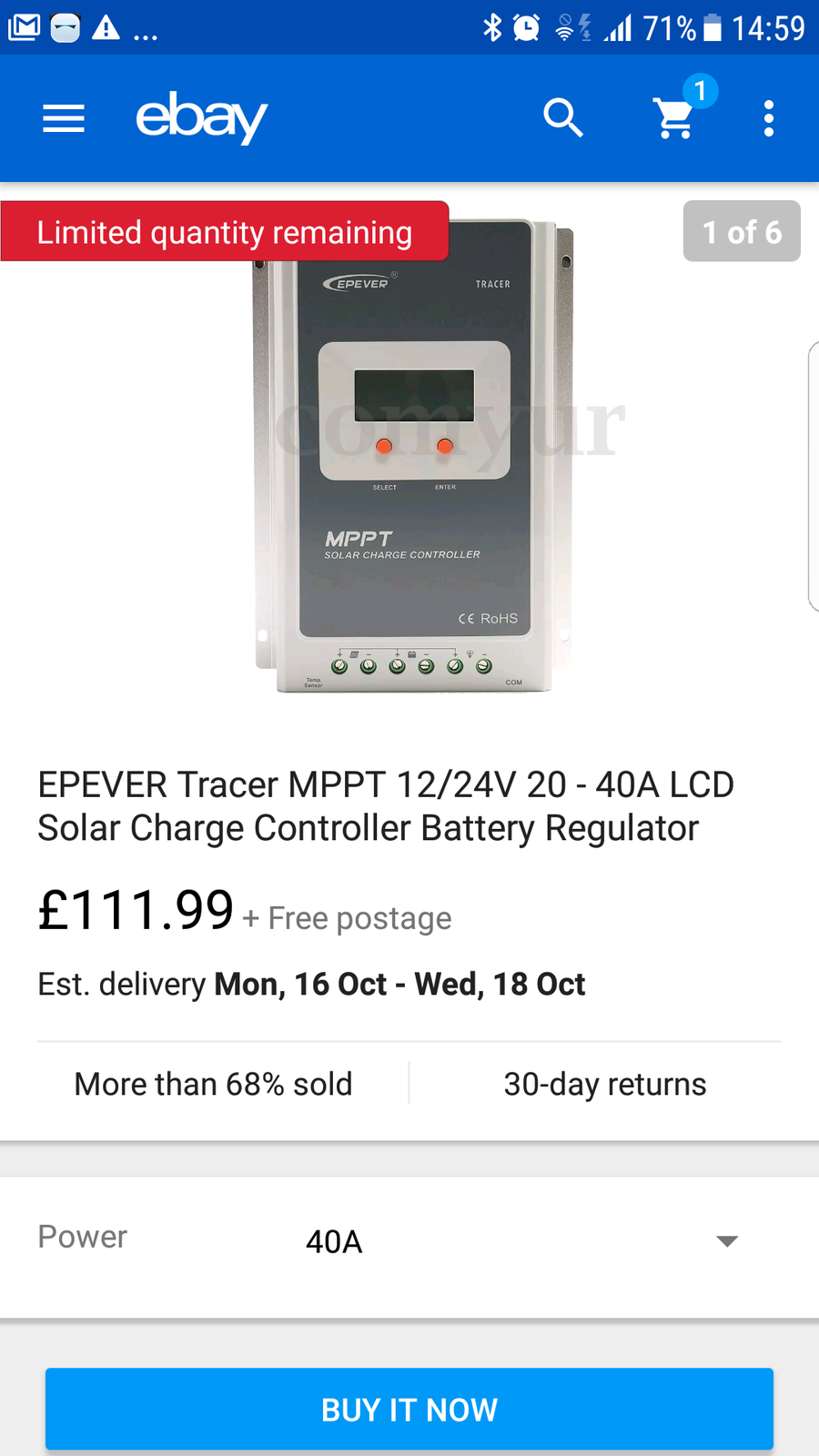

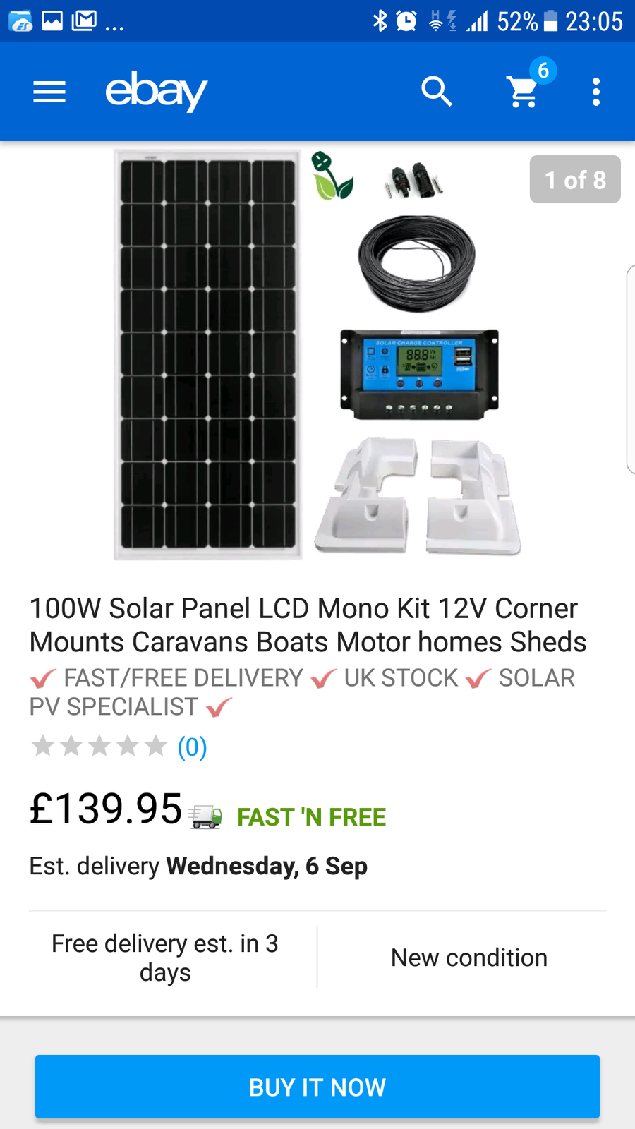

I missed this before. So i just checked and the problem is my panels are 31 volts and to get a victron one i need to get the 50 amp which is a fortune.They do last but only if you have to buy quality ones not the ebay cheap versions, I have fitted a fair few to boats. The main problem with the flexi ones are they are expensive for the amount of power that you get compared to the solid framed versions.
A charge controller is a must, it's worth getting a MPPT one and unless our customer wants some other brand we always fit a Victron Energy model as they're good kit and we've get no problems with them.
@ukracer since you're wanting it to keep your batteries charged up over winter you better fit a bigger system as they produce a lot less than the advertised power with the limited hours and strength of the winter sun, also you'd be better angling it to suit the low sun angle or the efficiency will suffer.
