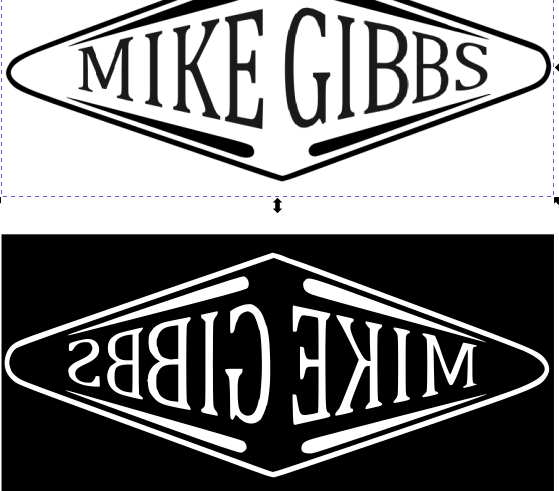

Can you draw a rectangle a bit bigger than it; covert the rectangle to nodes (stroke to path); then select the rectangle, hold shift and select your design and then path -> difference?
You’ll then get a negative. Which may help.
You may have to play with path-> exclusion or difference. There doesn’t seem to be a logic as to which works when.
