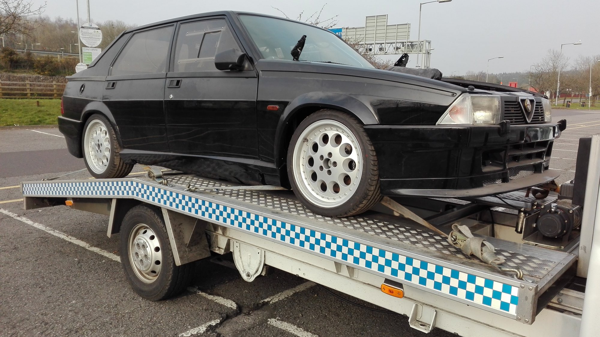

For some years now I have been restoring/building a car to my own requirements. One of the things I carried out was an engine transplant using an engine which was never fitted to this car. In fact it was never fitted to a RWD chassis, this means there is no off the shelf exhaust for it. Solution? Build one!

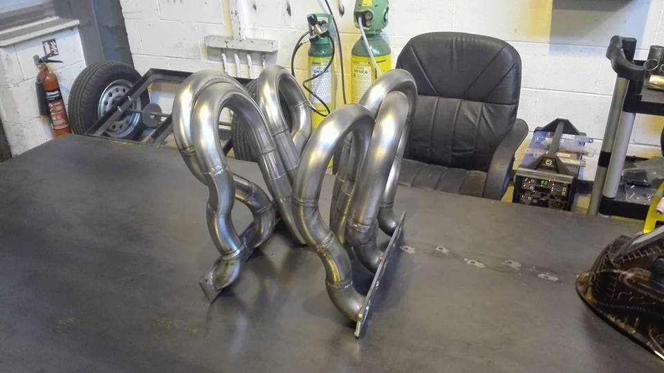

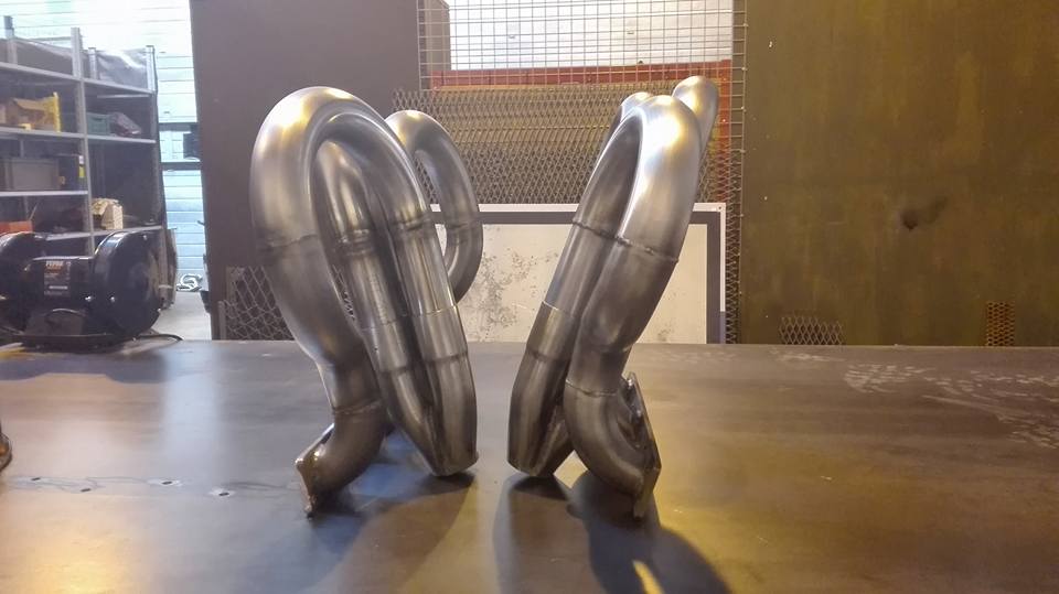

I won't go into too many details but before anyone asks yes I did back purge.

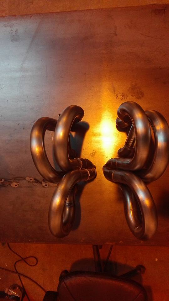

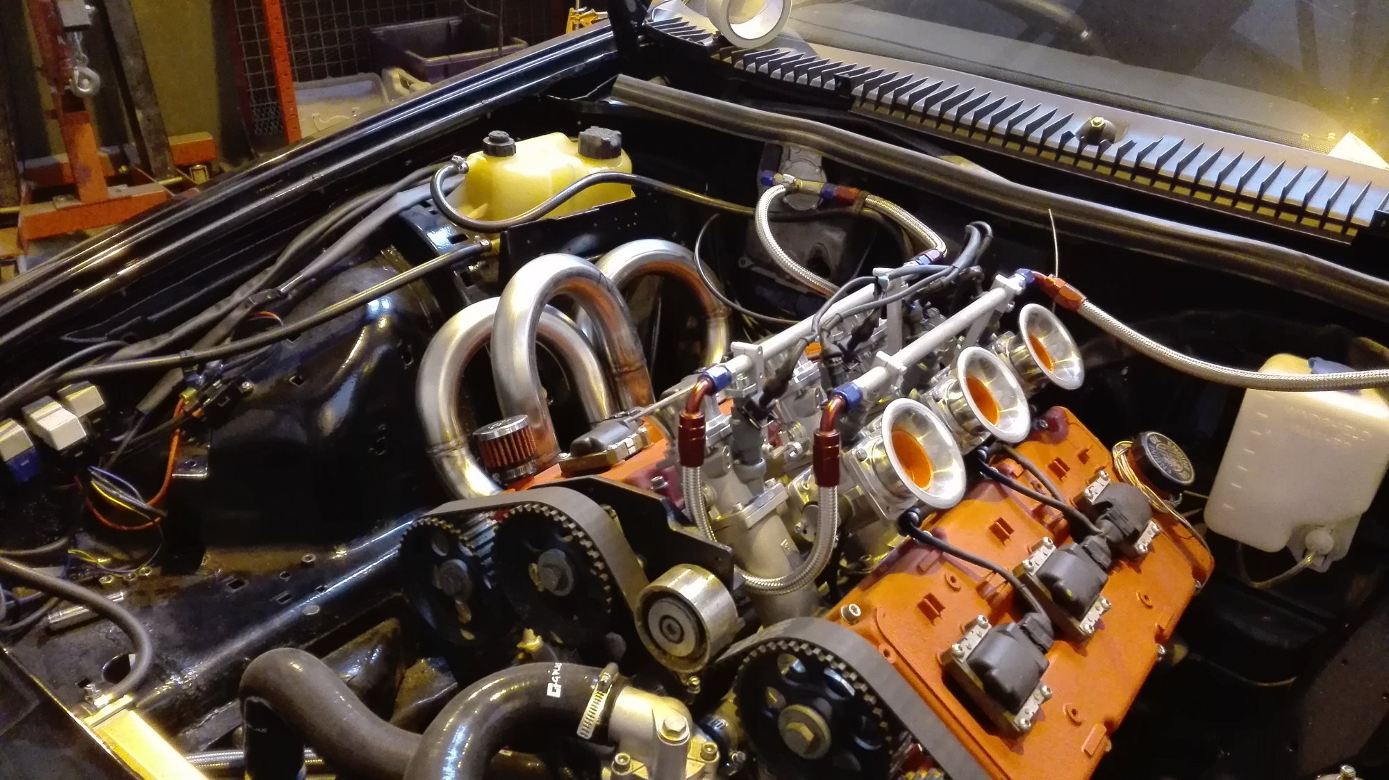

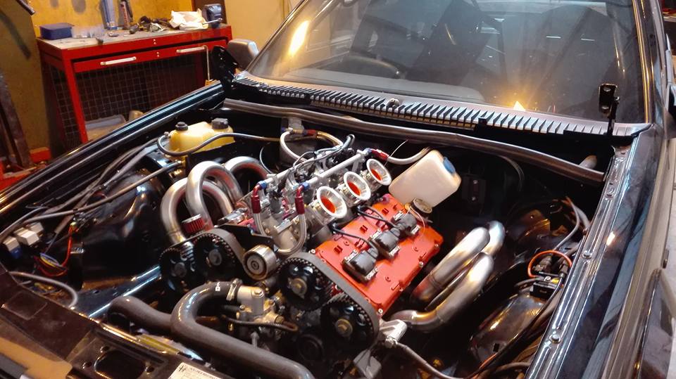

So far I have made 1 manifold, slightly different to my original plan as I wanted to keep the design as simple as possible. Again before anyone asks the reason why I choose to bring the primarys up rather than straight down is due to space restrictions down low. I wanted to keep the primarys equal length and this wasn't going to be possible if I went straight down. Also this engine responds well to longer primarys, it unlocks a little more torque low down in the rev range.
