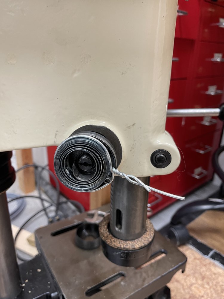

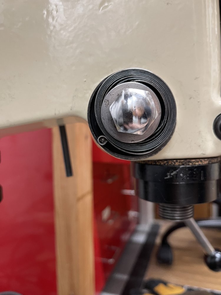

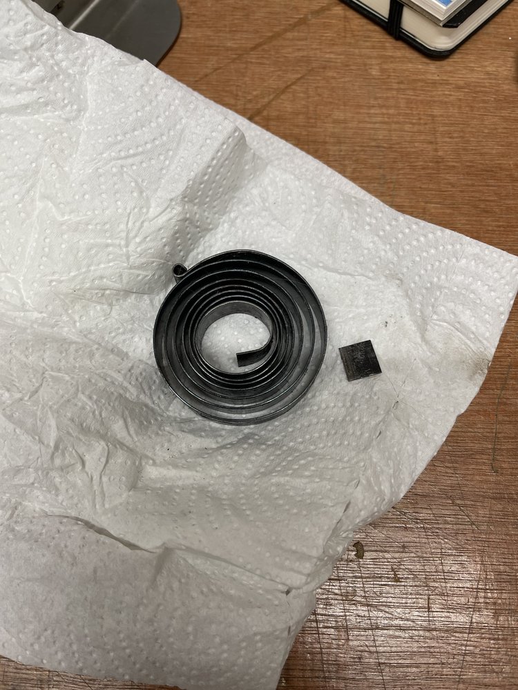

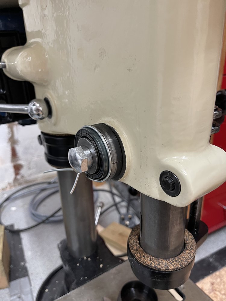

On my calamitous learning experience that is my fobco star restoration I’ve managed to put the quill spring in the wrong way round. At least I assume that’s what I’ve done as the quill locks up and won’t extend more than a couple of cm.
Im wondering how to safely remove the spring, flip it over and put it back in. With the outer cover removed about half the depth of the spring is accessible so am I right in thinking I can get some wire around it tightly and then just pop it out, flip and reinstall?
