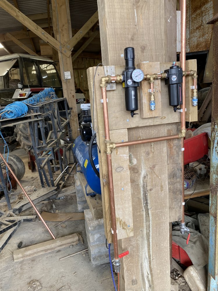

Airline setup completed … just one connection to remake…. Probably need dowty washer or something, probably should do both, on the XF outlets to copper.
Included 12m of 22mm copper with 3m drops and water drains.
All pressurised and ok. System at 10 bar upto the regulator and 100psi thereafter.
Yeah yeah. Mixed units
Coarse filtered outlet for run of the mill tools and .01 micron filter for spraying.
Can’t wait to try it out in anger …. Blown up every one of the couple of hundred tyres on the various toys …….
i wouldnt bother with it . never used one in 50 years and have a fair few air tools just 3 drops of oil at start and finish and a quick run before putting away
