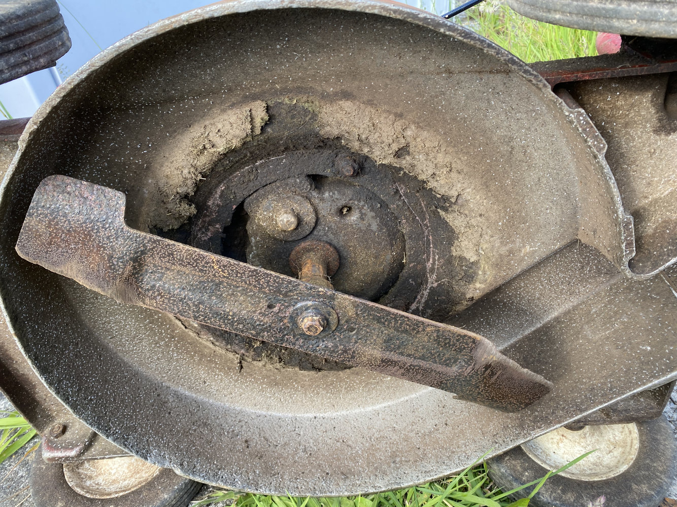

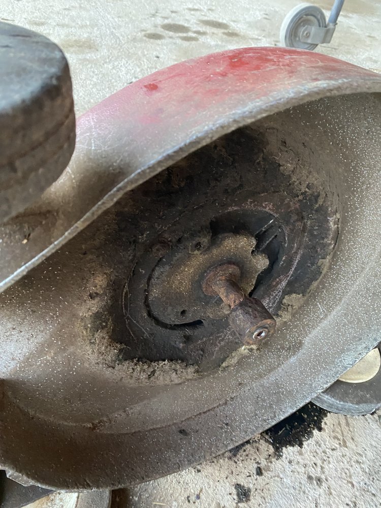

Right handed. Paint it with 3in1 or something first. (Not a Doctor)

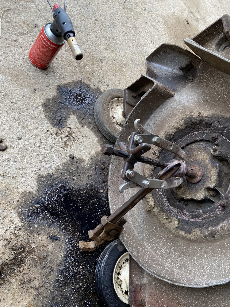

Warm it first a bit. there may be a locking glue on it.Yep right hand thread. Normal socket and ratchet should do the trick. Chock the blade with a piece of wood.

Hoping I might get enough heat in it tomoz with a blow torch…. It shouldn’t need a huge amount …… probably….. hopefully …. Else it’s off to our neighbour who does have oxy…..There are times in life when you need the blue spanner.

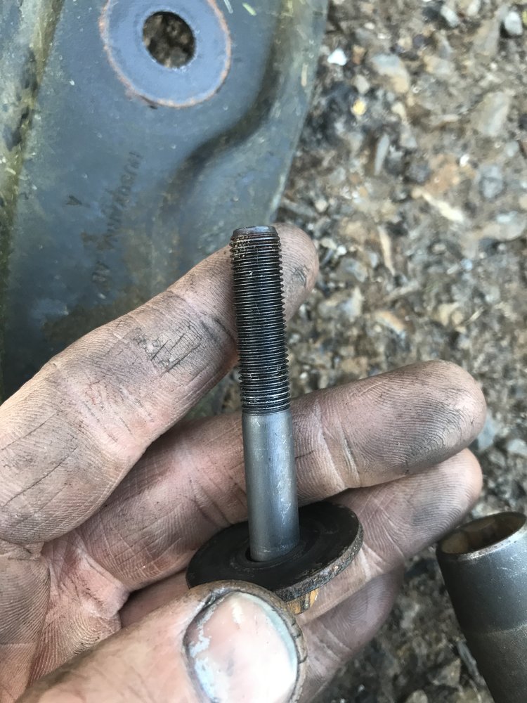

I couldn't get the bolt out of mine either after 20 years of corrosion, had to grind the head off and buy a new one.
