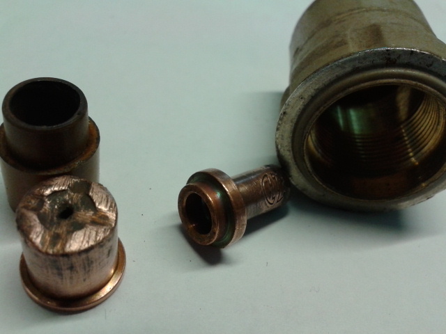

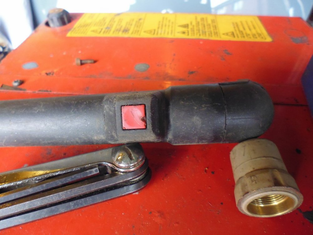

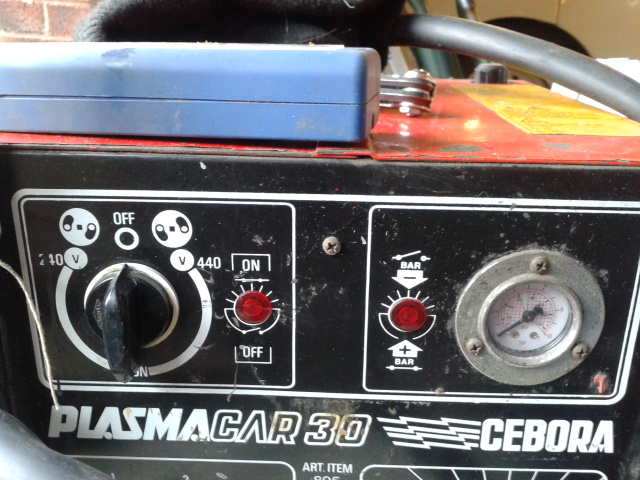

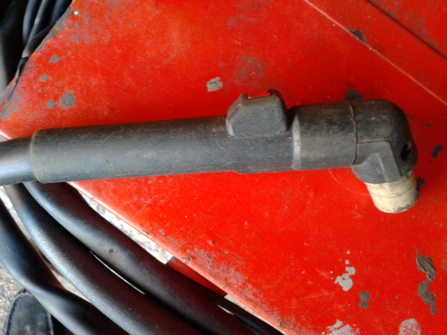

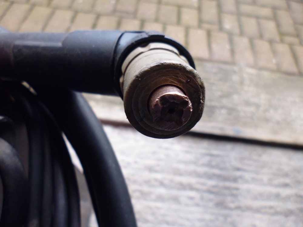

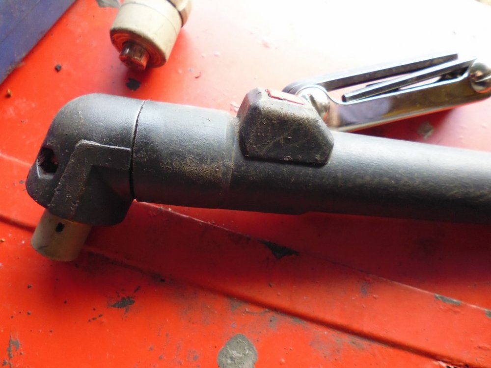

Something that springs to mind is that when I tested it this morning the air was on all the time?Is this correct or should pressing the button open the valve?
Looks identical to the tip set on my old Cebora Prof35, except that the button was different. Pushing the button started the air, then bumping the torch got the arc going. Releasing the button stopped the arc, with the air some 15 seconds later to cool the tip.
