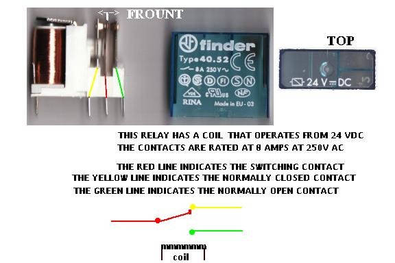

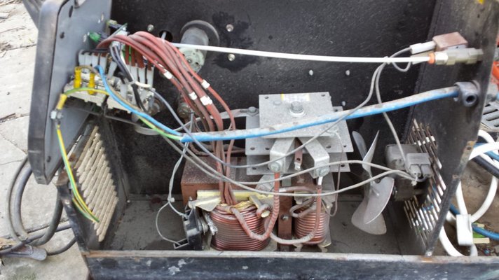

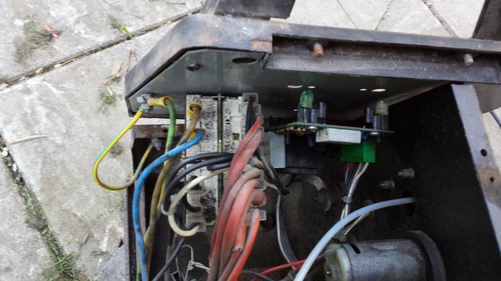

hi all.
my machine has just developed a problem which is baffling me somewhat.
when I switch the machine on, the wire is always live and the gas comes on. the wire feed still works with the torch button.
the torch button must be ok for the wire feed to still work, so I am wondering if it would be the pcb or the main mechanical switch? anyone had any experience with these things? any help would be appreciated. also any ideas where I could get spares from?
thanks guys.
