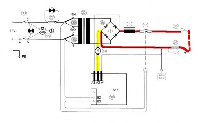

hi all i have got a non working snap-on 130 mig and after reading through the forum i have tried various things to to diagnose the problem.to start with only the power and the fan came on.and no transformer hum or voltage on the out side.i then connected a piece of wire in the two pins of the plug i pulled from the board going to the contactor and i now hear the humming noise and i get the following voltage on the dc multimeter.both leads coming from the transformer to the plates 29v , contractor 40v, tip of gun 29v and goes down to zero when i press the trigger.but the feed motor does not turn?.also is it usual for the transformer to be rusted.has anyone any idea so i can get it working thanks for any help.
