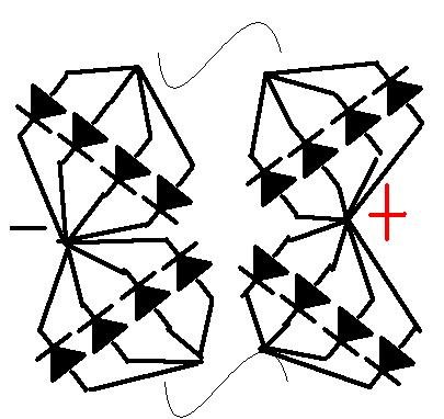

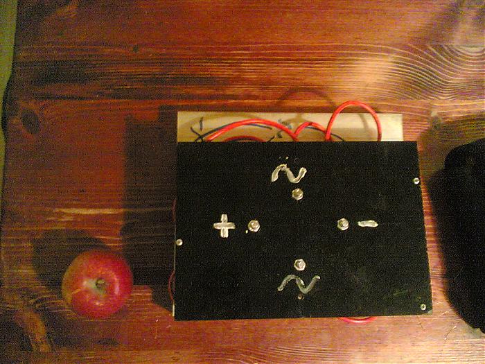

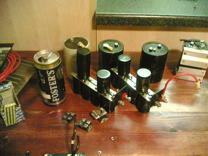

Thought some of you may be interested in the the progress of my project :
After dismantling loads of equipment on the way to land fill i managed to recover 60,000uF worth of capacitors and some really big diodes.
Made my self an Uber rectifer capable of rectifiying about 400 amps which turned out to be un-needed because the SIP manages full wave rectification with only 2 diodes which is novel.
Then i build myself some rather large capacitence packs (48,000uf) and installed them today, havent manged to weld yet because of lack of migwire, but intial tests seem positive and will pick some mig wire up tommorow to properly test and maybe add some more capacitors.
Also got a gas solonoid for a euro conversion later on maybe.
