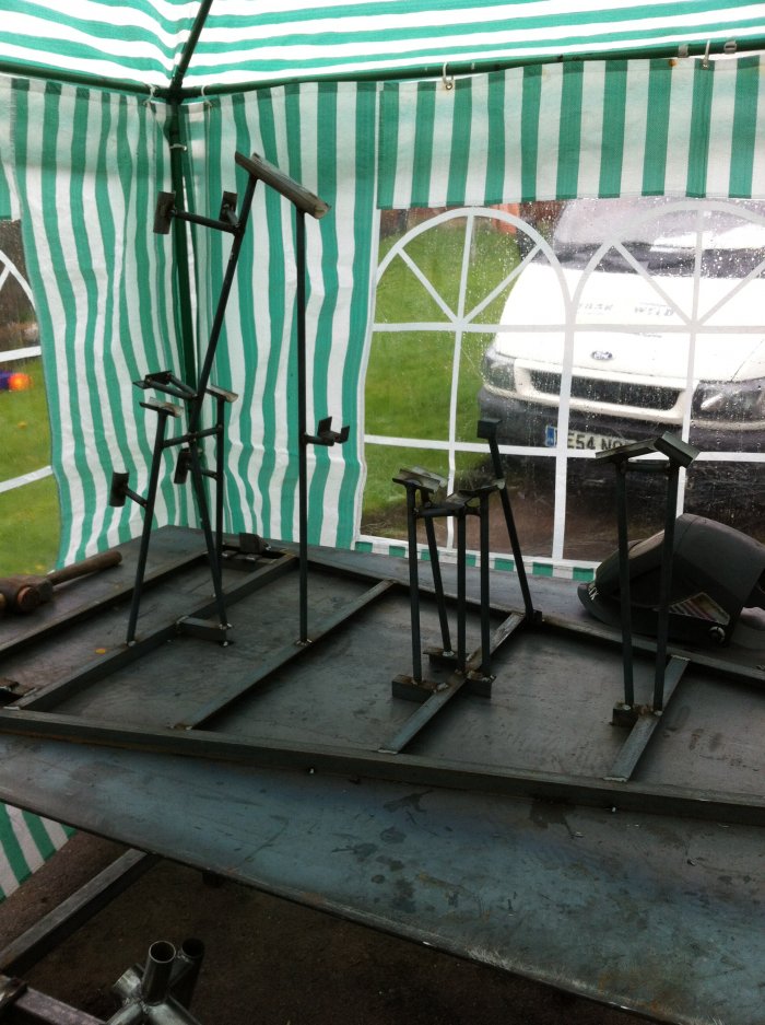

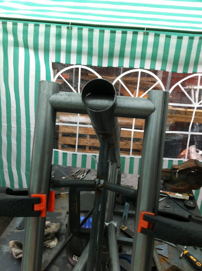

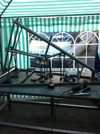

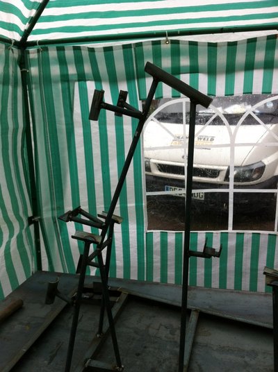

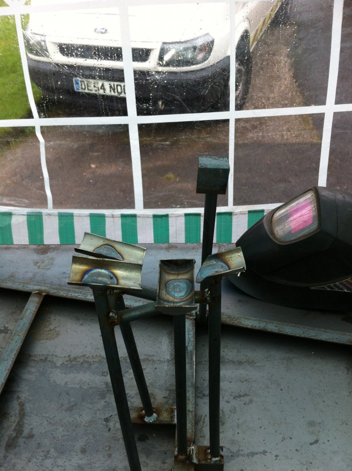

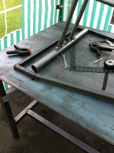

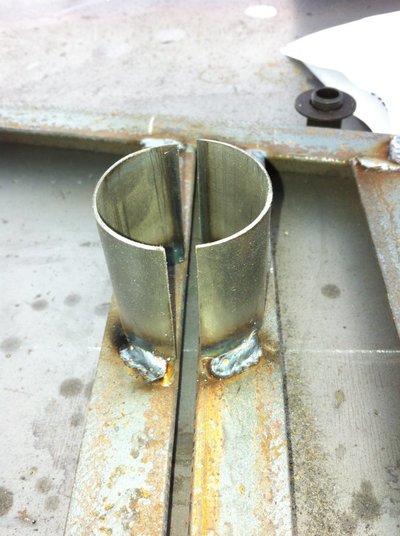

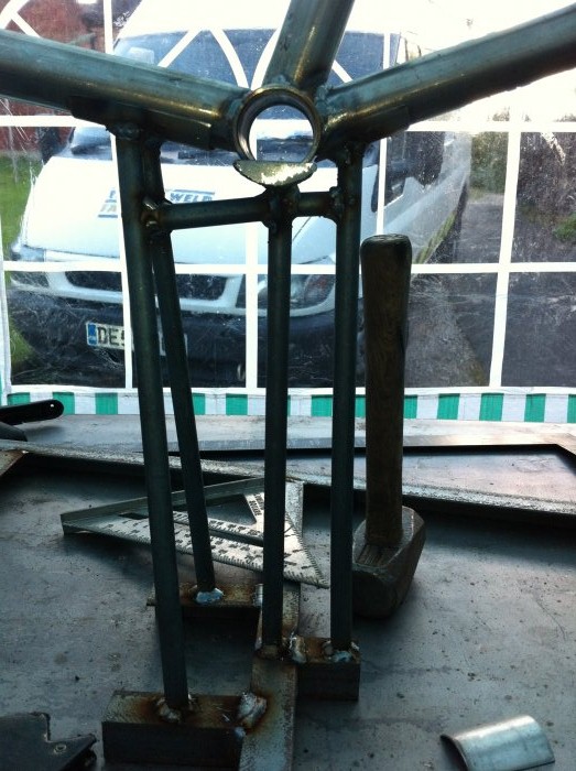

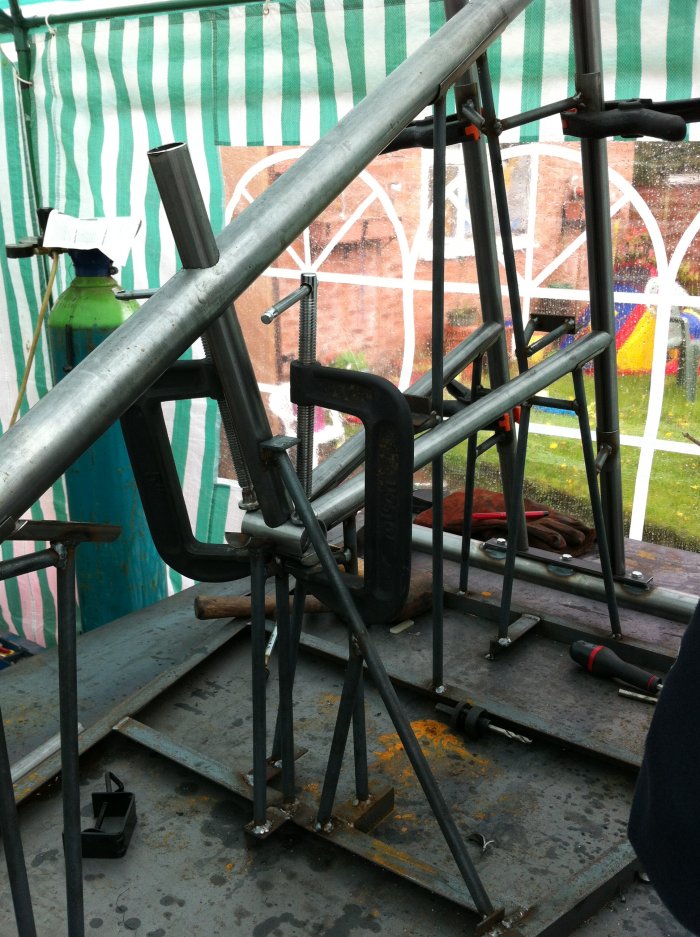

Ive just started a job for a customer who builds smoothie bikes (a one wheeled bike that powers a blender when pedalled). His company has taken off and now he cant find the time to make them so thats where i come in. He didnt even have a jig to go off so each one was taking him four days to make.

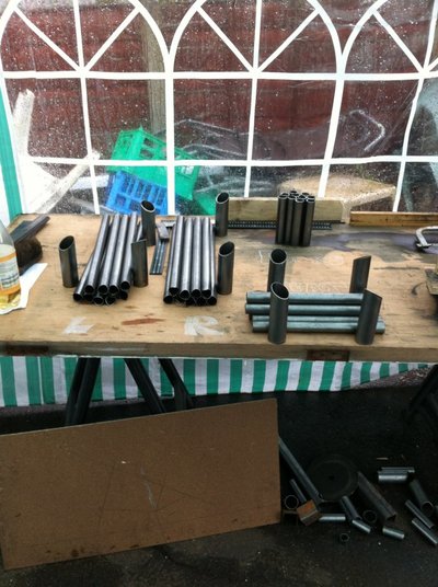

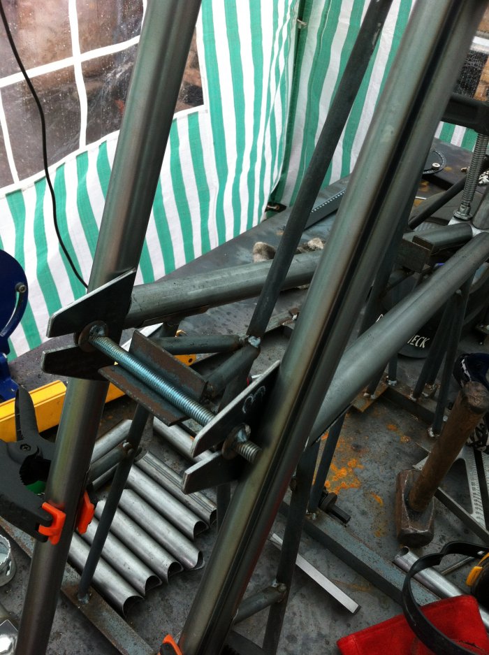

Today i made the jig using one of the bikes already made by the customer. Its made out of 1" angle, 12mm round bar and tube split down the middle to use as 'cups' for the tube to sit in. Havnt finished it yet and took longer than i thought it would but i suppose it needs to be right as i have to make ten to begin with then more as and when the customer rings me.
This gave me the chance to use my new bench which i built on sunday and it has come in really useful to tack the jig frame to. I will post more pictures as i make progress.
