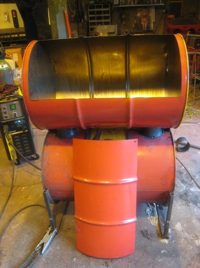

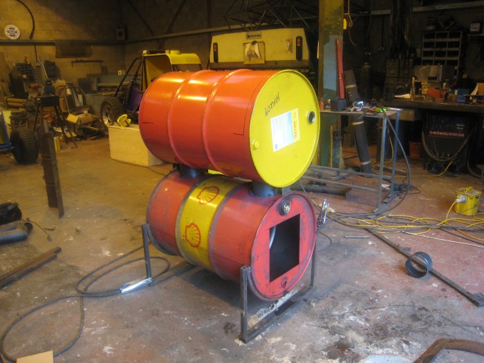

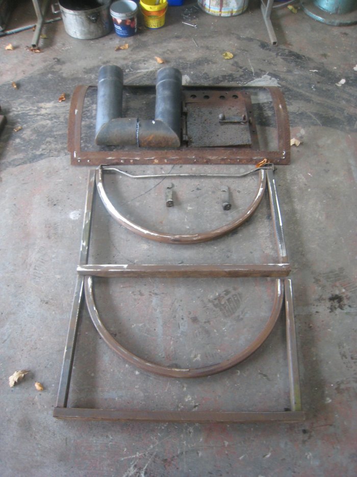

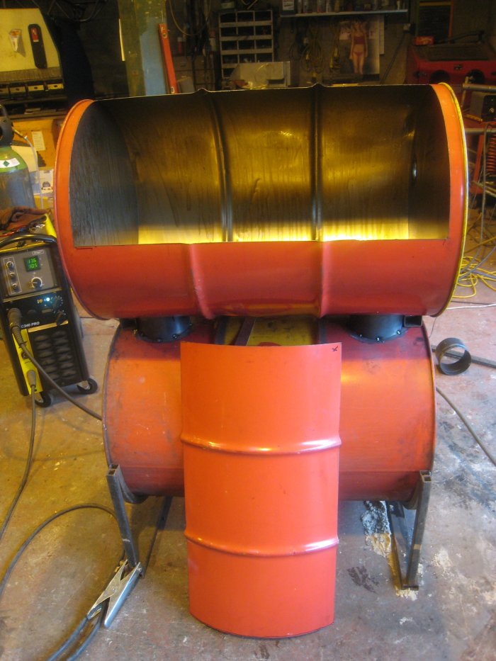

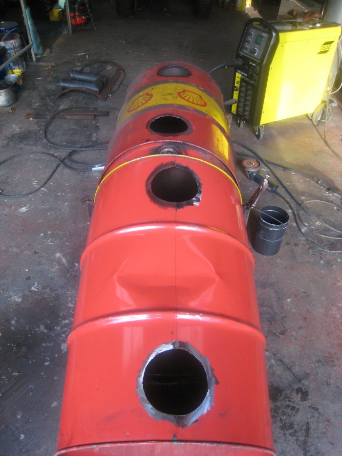

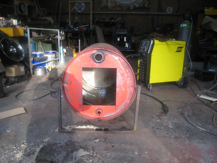

My old smoker has seen better days so seeing as the kids are off for a few days though I would get them working or hindering as the case has been. Set about the old one for a few donor parts managed to save the firebox door legs and flue outlets.

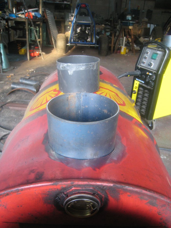

). Had a cutting of 150 dia flue but did not realise how hard the enamel was to remove so ended up rolling some 3mm sheet.
