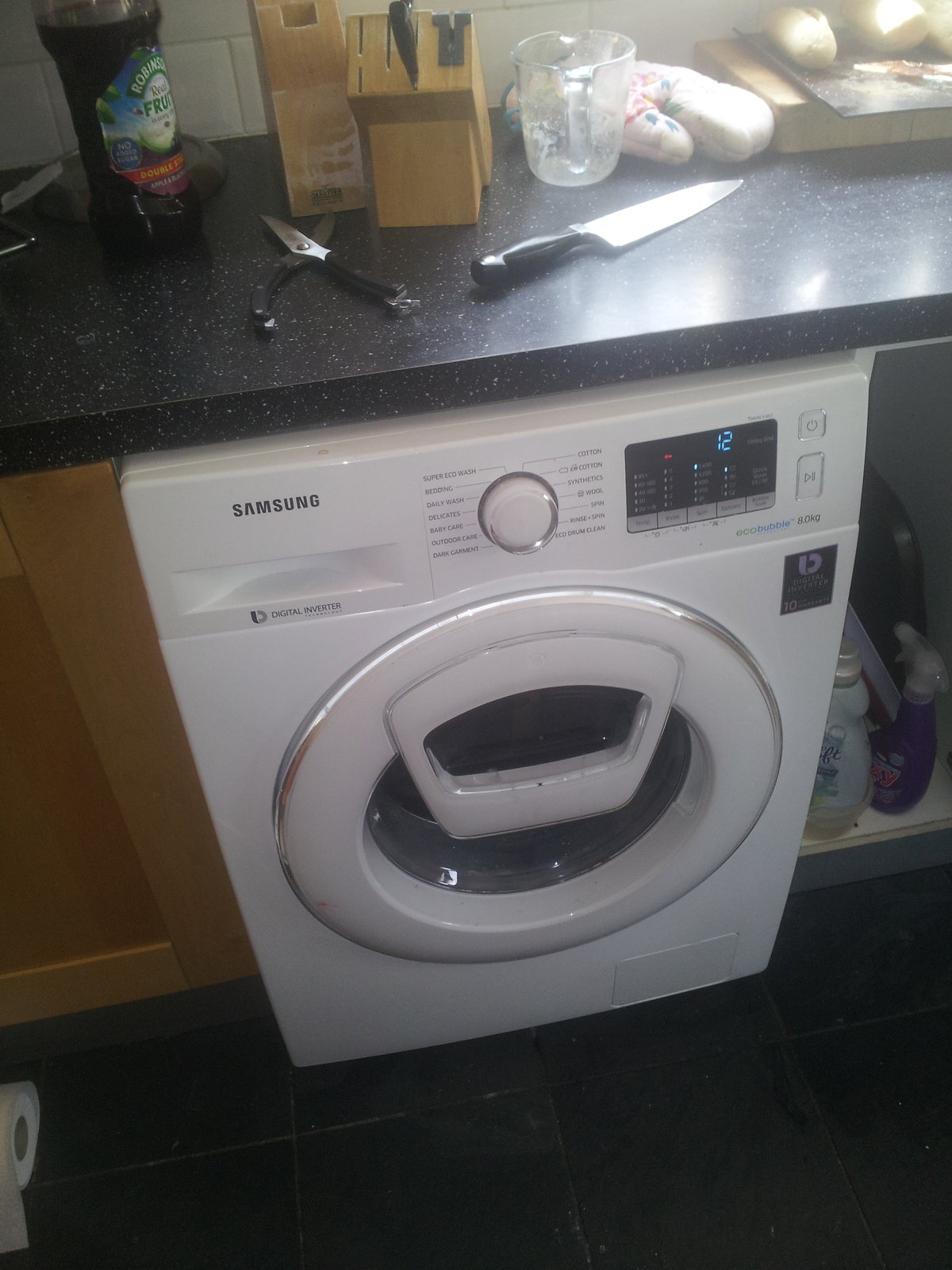

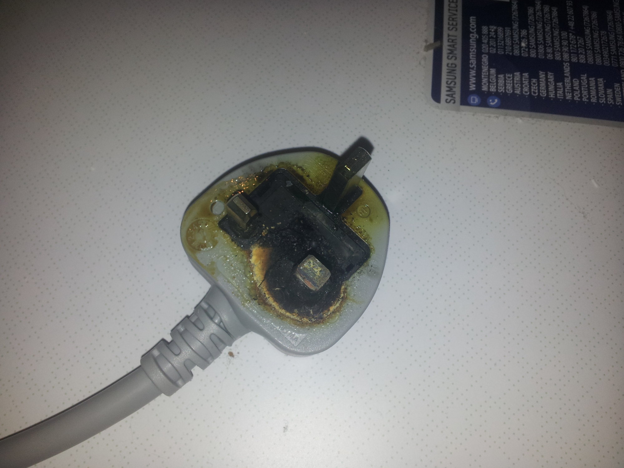

So today my mums complaining that there's a horrible smell coming from the washing machine, so i go down and kitchen smells like rotten garbage/sewage, google the symptoms, get clean filter and stick in on drum clean mode.
Fifteen minutes in to clean drum mode and the smell is getting worse go and investigate, poof the mcb trips

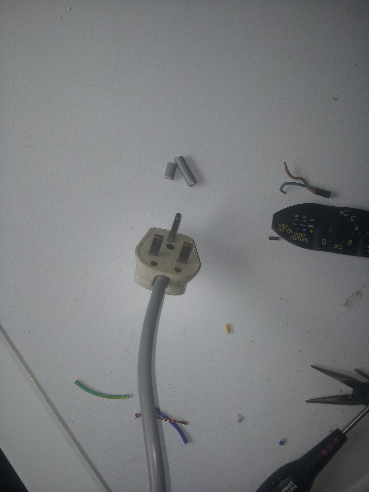

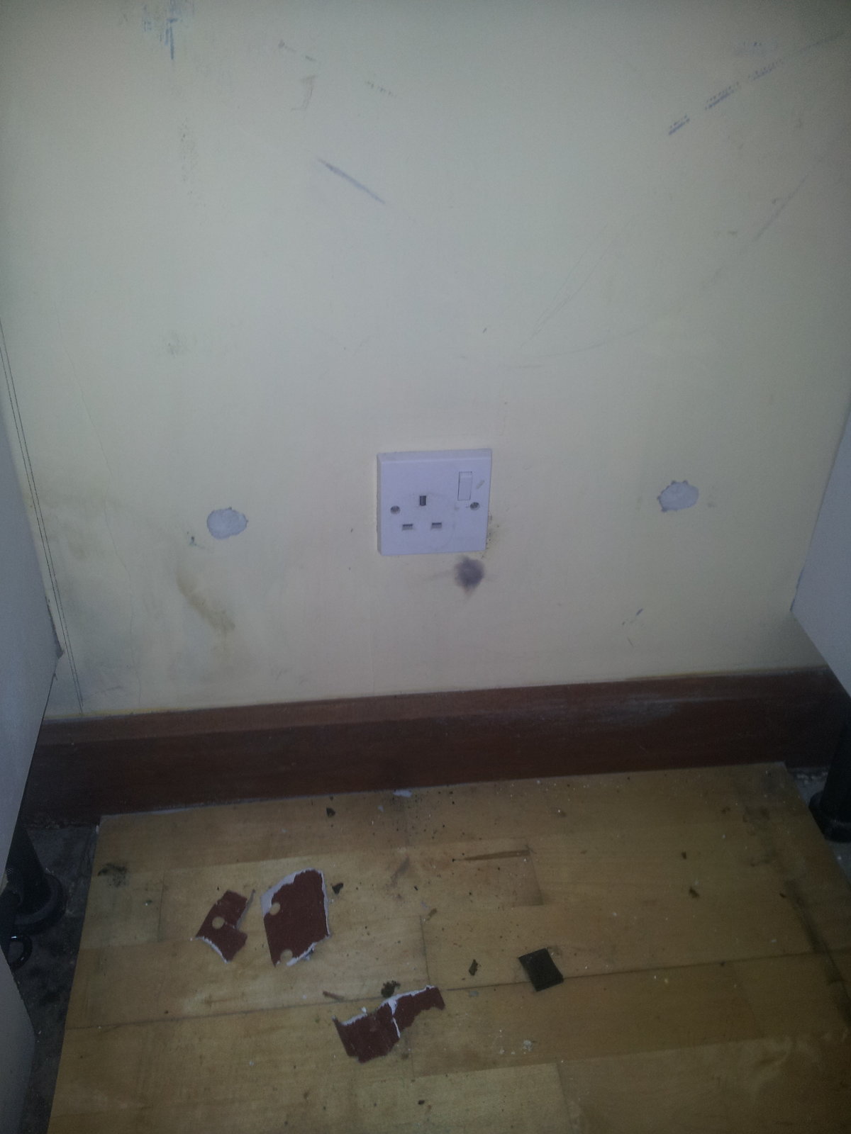

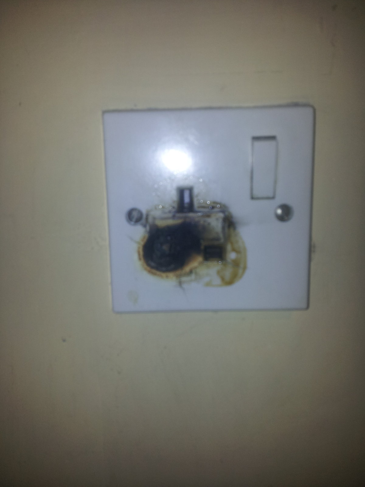

. instantly man handle the machine full of water out and there's smoke emerging from the plug/socket.
Best part parents left not long after telling me about said funky smell and going off for a few days away. So i can see this being a pia to sort out. who ever knew burning plug socket smells like sewage
. instantly man handle the machine full of water out and there's smoke emerging from the plug/socket.Best part parents left not long after telling me about said funky smell and going off for a few days away. So i can see this being a pia to sort out. who ever knew burning plug socket smells like sewage

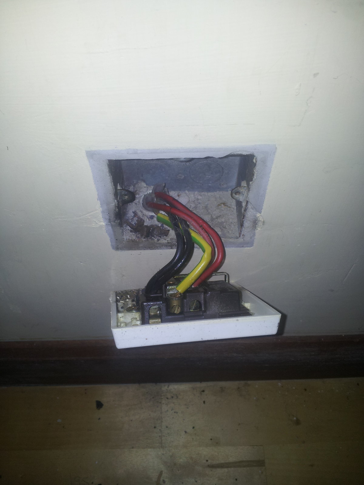

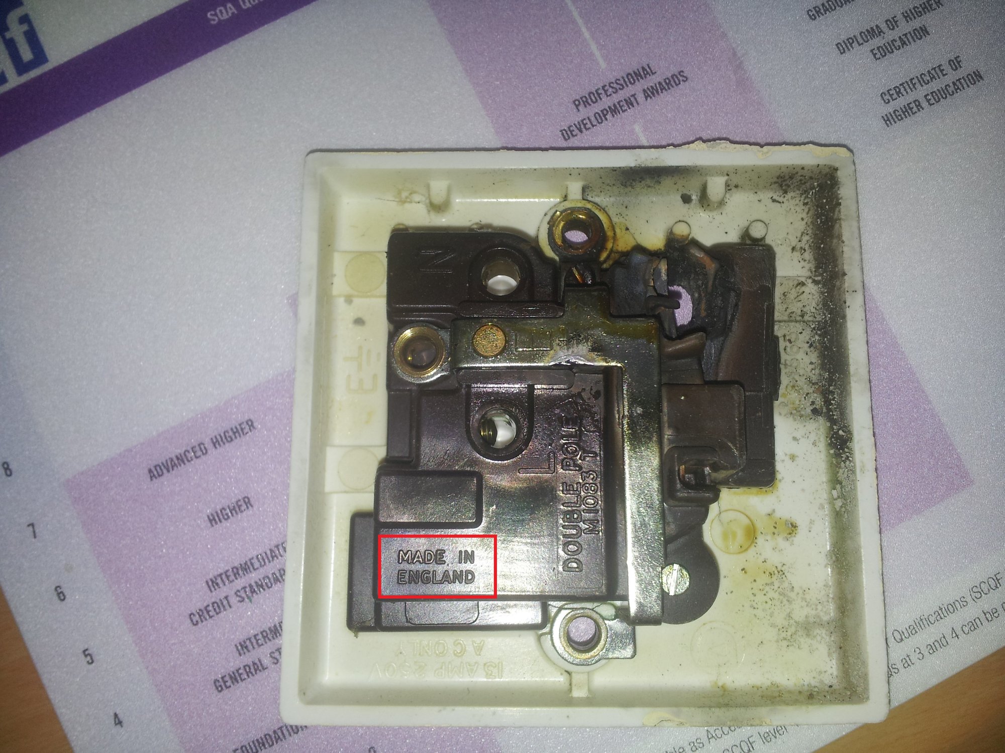

if one goes best change the pair even if just gets a bit warm . I just changed a socket at the school I do work for. plug on heater welded in to the socket and wouldn't remove
