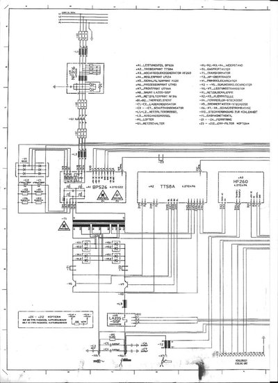

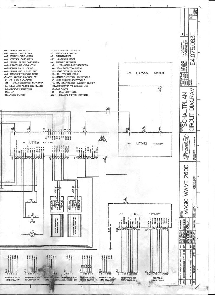

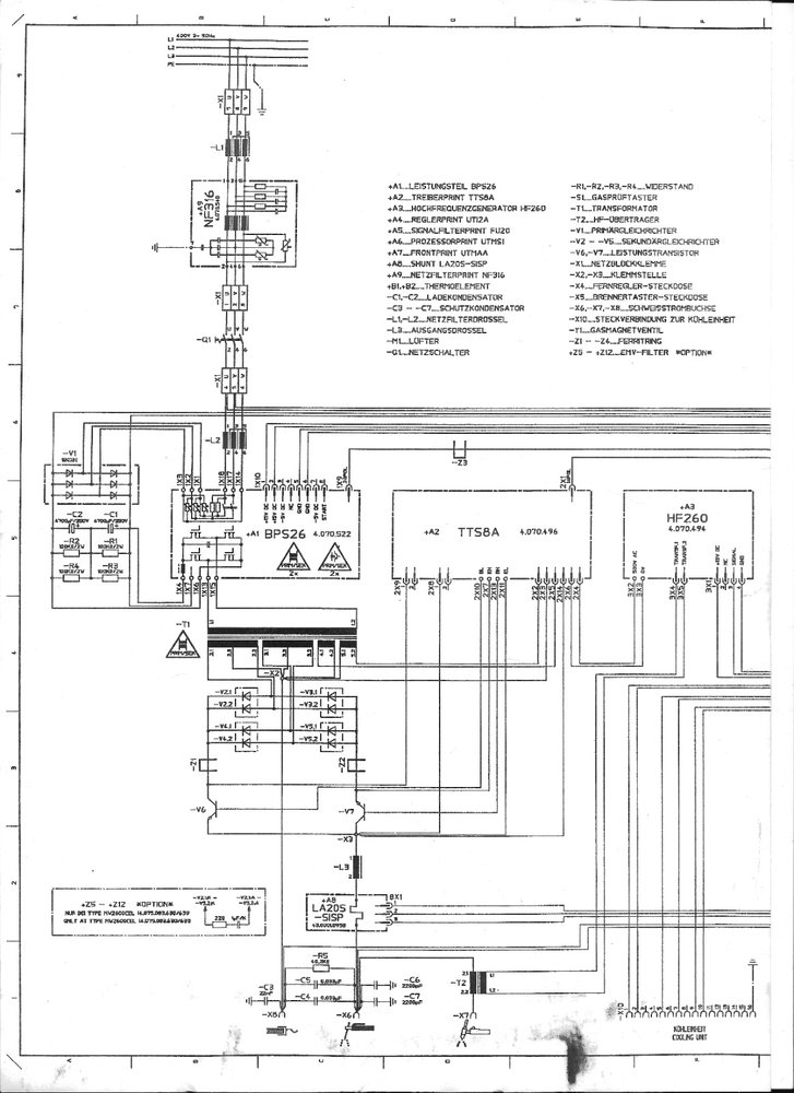

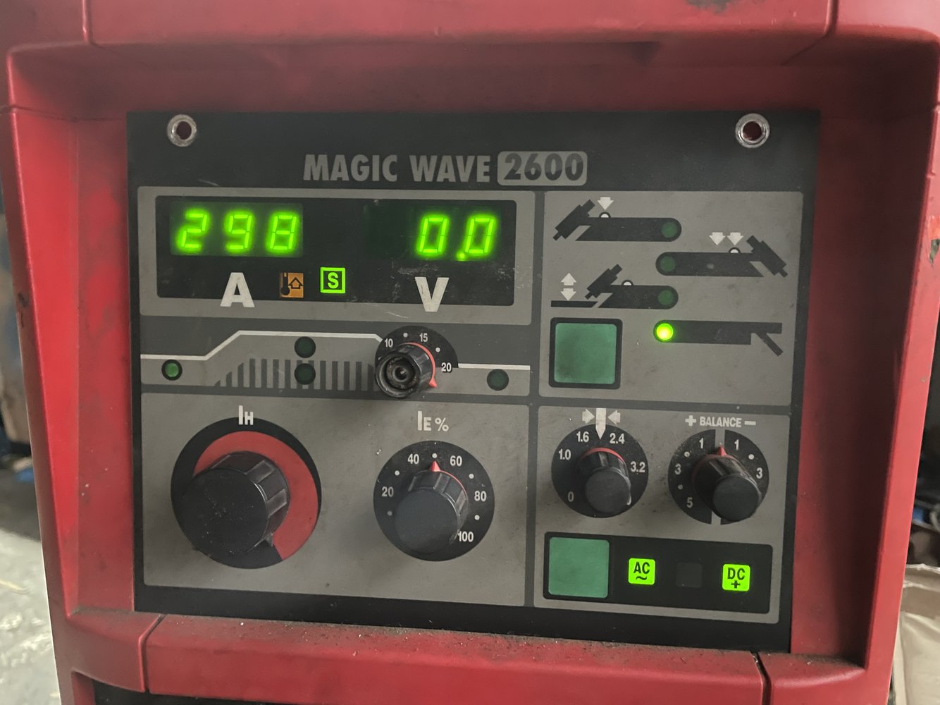

I bought a defective Magic Wave 2600 the other day.

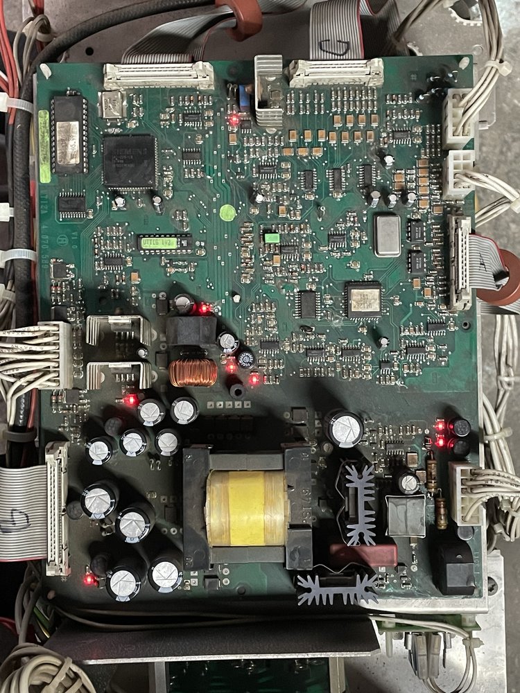

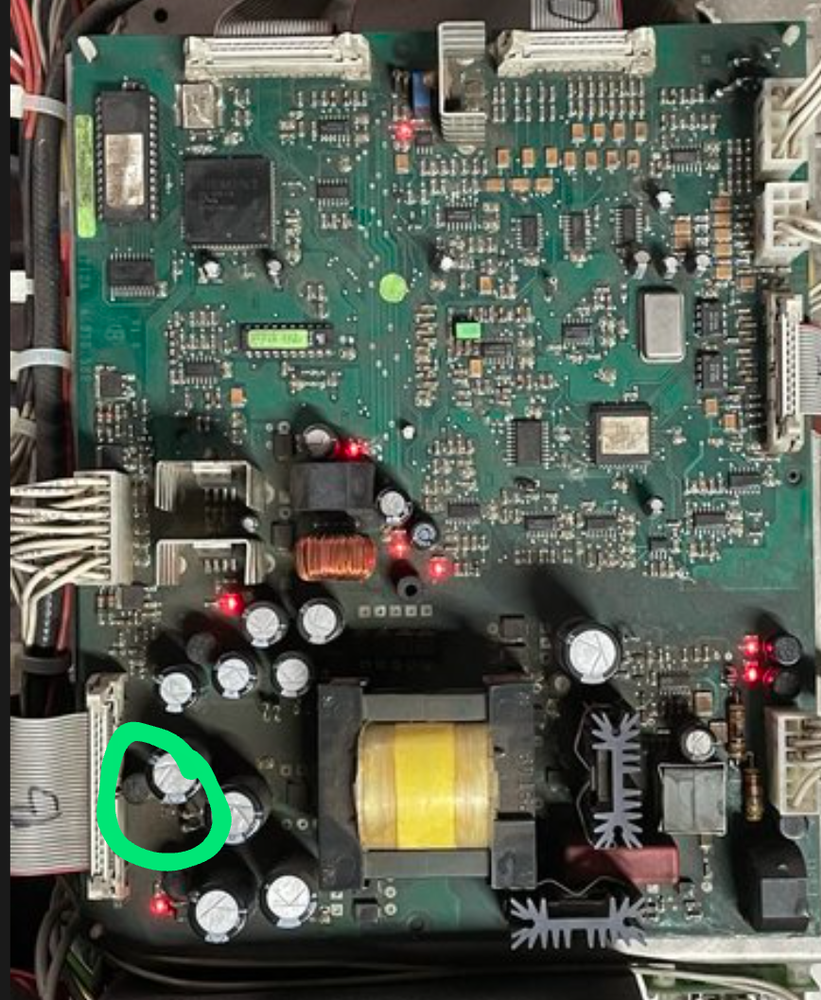

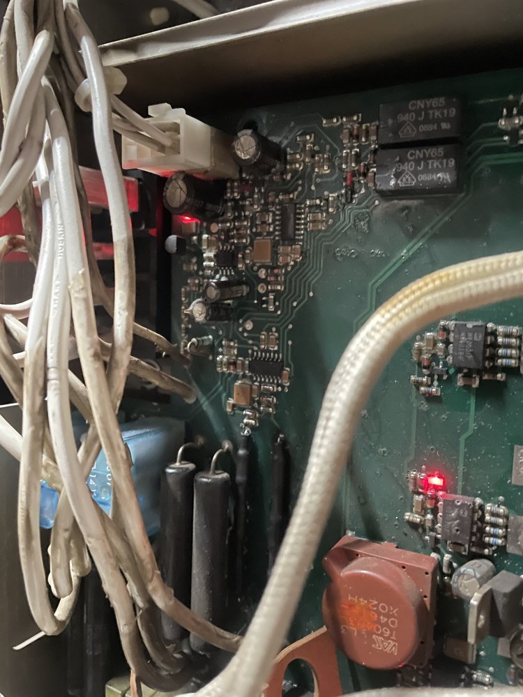

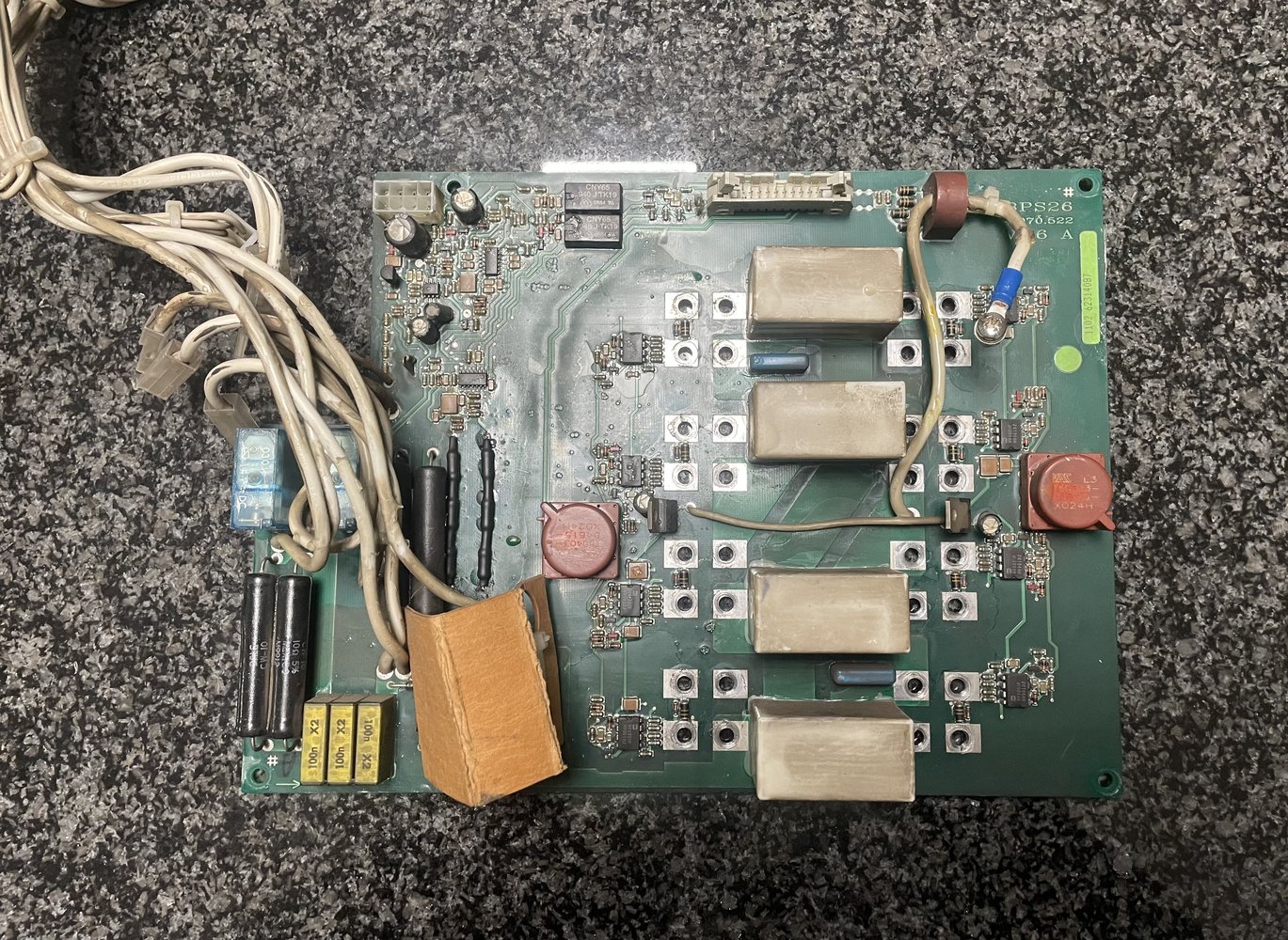

At first startup the machine seemed to turn on normally and the coolant pump squirted a bit before stopping (startup sequence i guess). The display operated however the ac mode light was always on, a bit dim but on. If i tried welding i had zero output, nothing. I took apart the machine and noticed that the resistors on the BSP26 board got quite hot some time. I found an old thread here where a user pointed out that these resistor often get bad.

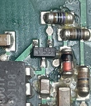

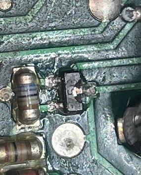

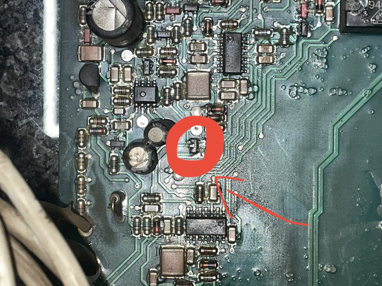

After i changed them the display now shows UP as an error and locks up the display. I am not sure how the machine is supposed to operate but on the BSP26 board there is only one red led working (far left one, 15V indicator perhaps). The other leds for over-/undervoltage don't seem to light up. I was able to find a broken SMD transistor which i wanted to replace. Unfortunately I can't read off the part code that is written on it. Does anybody has the ability to check or knows what kind of transistor i need ?

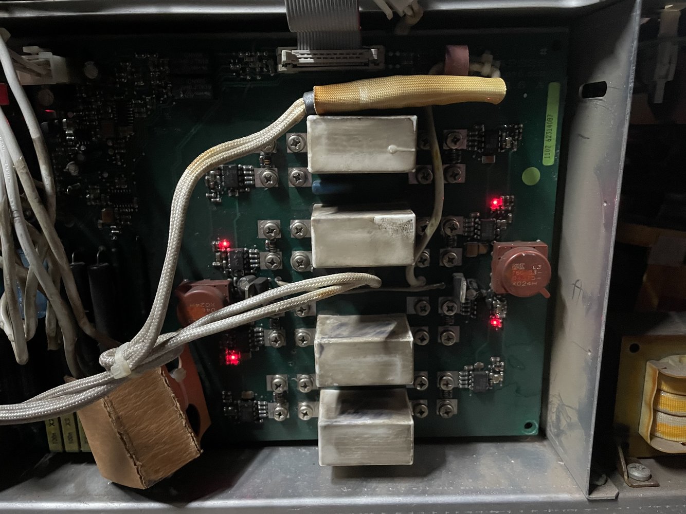

Some other facts about the machine are that the input rectifier seems to be working and outputs ~580V on the capacitors. Also the diodes on the heatsink seem to be just fine eventhough I measured a voltage drop of about 0,4V on a couple of them and ~0,33V on the rest.
I would be thankful if somebody could help me out.
