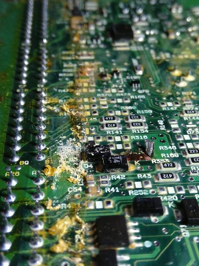

I know we have some electronics whizzes on here so thought I would ask. I'm new to the whole arena but learning fast.
2006 L200 ECU up for fixing, dead short on the power/gnd pins. Looking at these I assume they are diodes from markings and D3, D4 written next to them. They are continuous to board ground on both sides. That seems bad, other identical components are continuous only on on one side.
Searching for 14 2C does not produce much except a polish forum and from translate the poster does not seem to get an answer.
Pins A26 and the next nearest set are Gnd and B+ respectively.
Anyone any ideas, I will find the verniers and get dimensions shortly if that helps.
