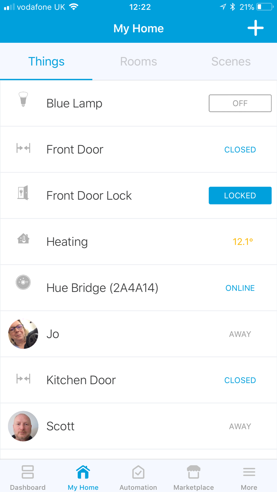

Which brings me to the point of this thread! My daughter bout me an Echo Dot for Christmas and rather that just linking to Spotify, I thought I'd see what else I could do. The restriction from my wife, was that whatever I automated had to have a "manual" backup, so if it went wrong when I was away, things would still work (bitter experience of domestic crises whenever I've been away in the US and Australia!!)!
I decide to try a light in the dining room. I bought a Smart controller from Sonoff and it requires a live and neutral input and provides a switched live (through a SPST contact). I had to load an App onto my phone (eWelink) which communicates with the Smart switch and then link that to Alexa (Echo Dot). To meet my wife's requirement I used the Sonoff output to drive a mains coiled relay with a SPDT contact that effectively became a second switch in a "two way" circuit, so if all else failed the switch could be used. This can be repeated in an existing 2-way circuit, but the retained switch would need to be changed to an "Intermediate". It all seems to work, so far! The current set up is chunky and the Sonoff and relay are in a cavity in the stud wall. I have dismantled the Sonoff and using a small RS mains relay I can fit this all into a deep metal box.
So far so good, I'll give this a month and see how reliable (and useful it is) and that will determine whether or not I extend the experiment further!
Notes of caution:
The downside is that the Sonoff needs a neutral (which is not present in most light switches) so you either need to have it near the rose or run a neutral to the light switch.
Be aware that that there is a button on the Sonoff you need access to in case there is a need to re-register, although I have found that turning the power on and off does not deregister and it will reconnect quite happily.
Finally, if the switch is used, then the Sonoff is out of kilter with the switch so unless the switch is put back to its original position, saying "turn on" will turn it off and vice versa!
Thanks for all your help in the past and I hope the above is useful.
