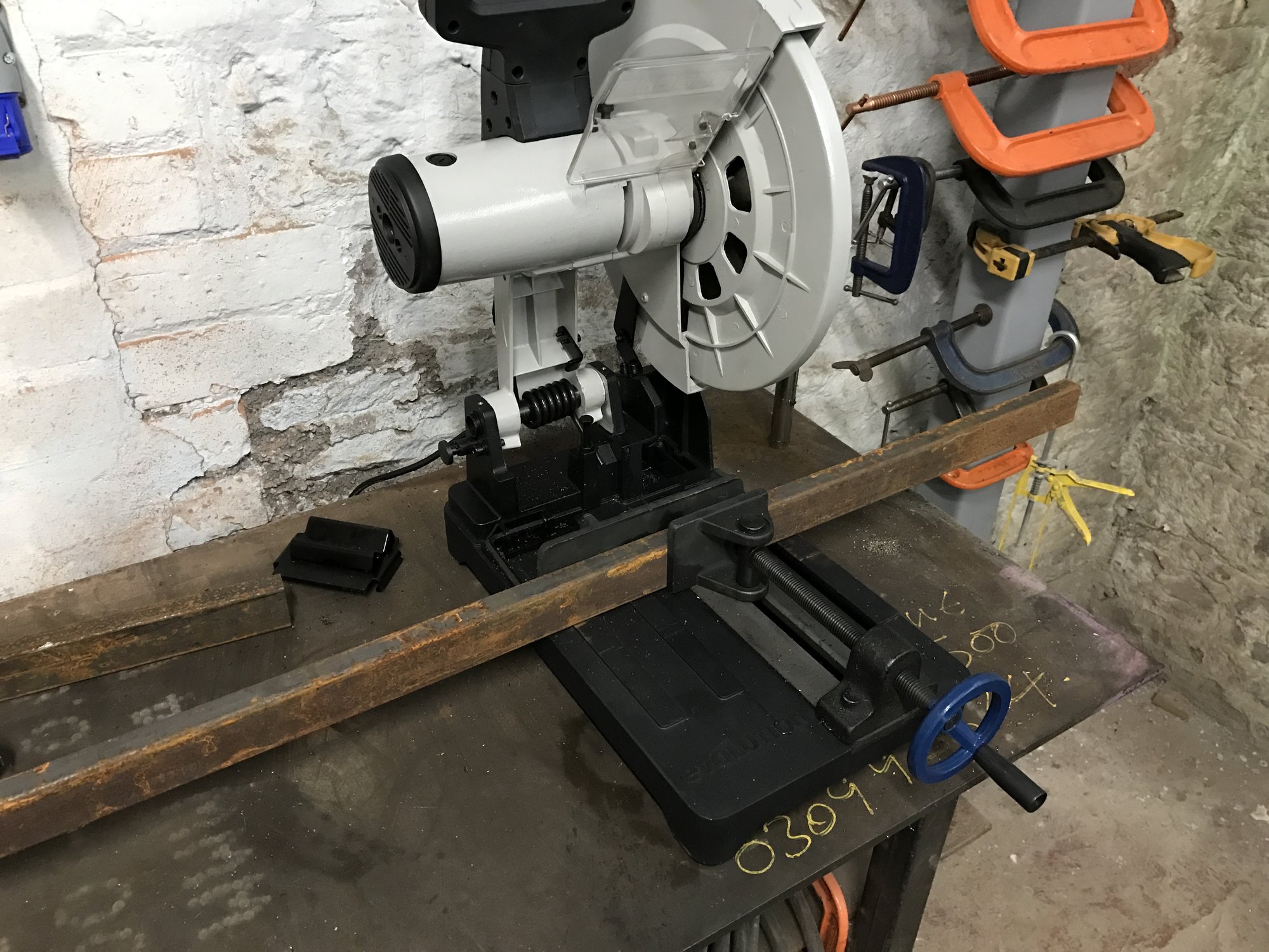

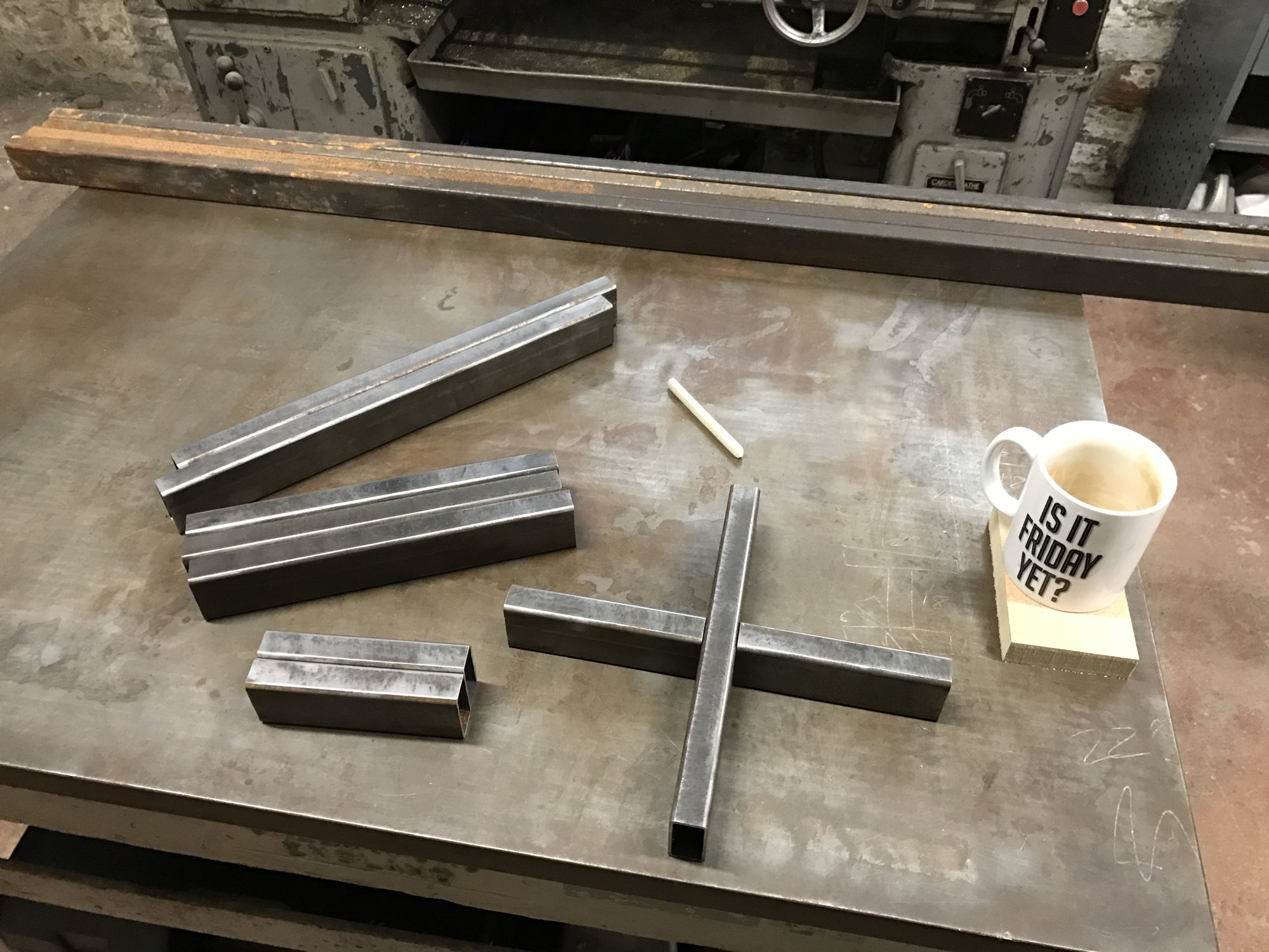

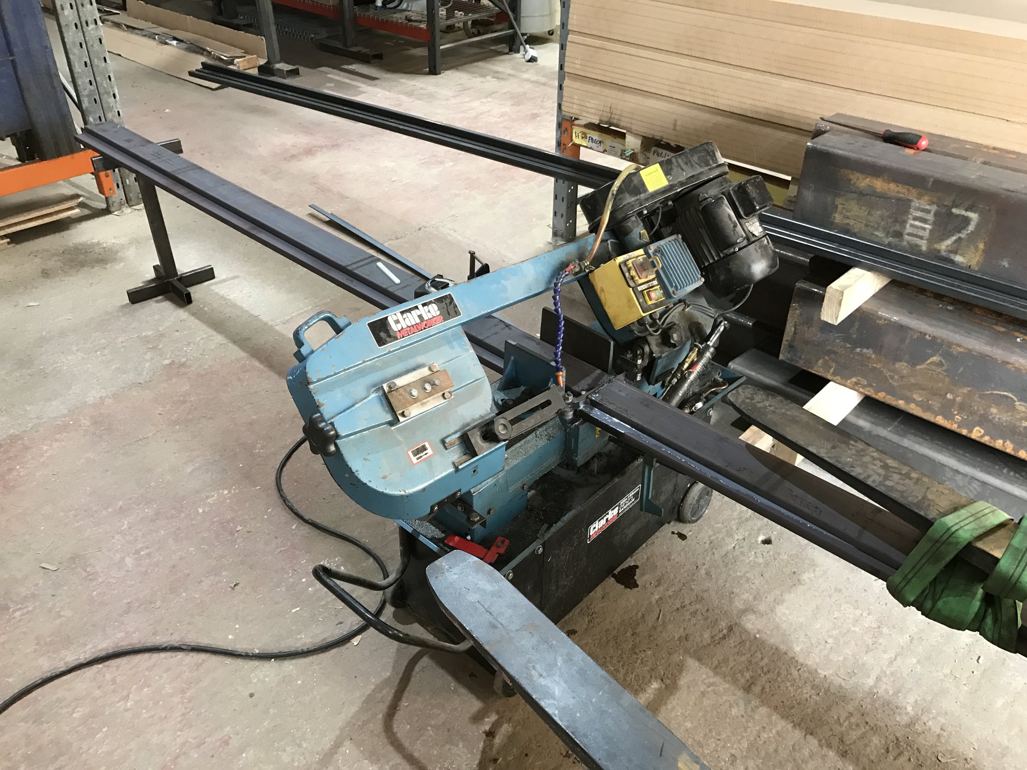

I need to cut up some 250mmx150xx RHS in my bandsaw but I don't have any stands.
My workshop is slowly coming together so I decided to knock some up with some 1" x 2" RHS.
I used my new EVOsaw to chop up the RHS and then cleaned it up with a wire wheel:

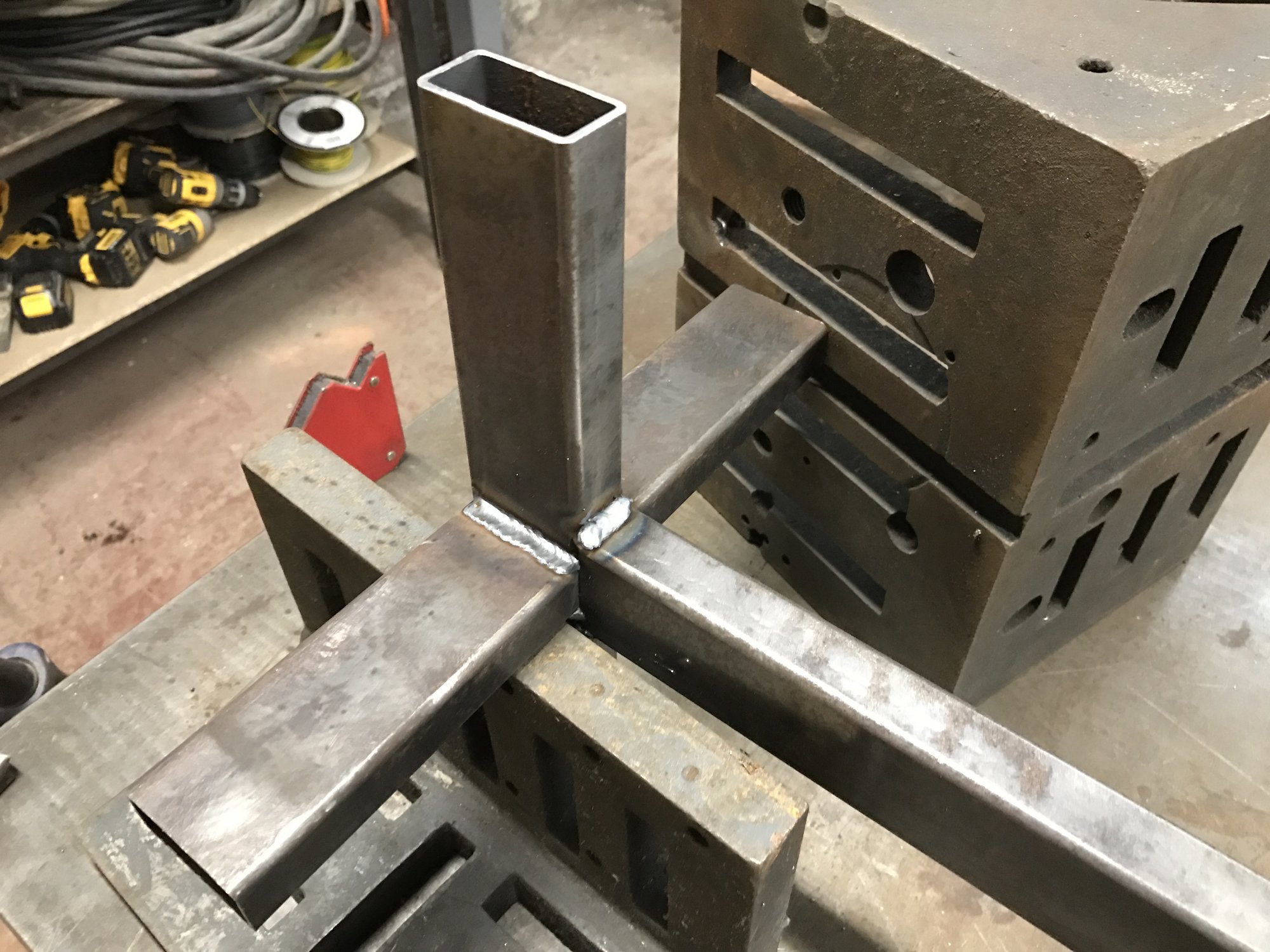

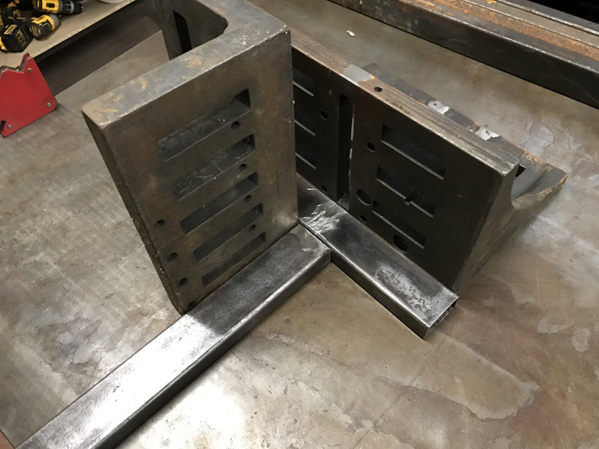

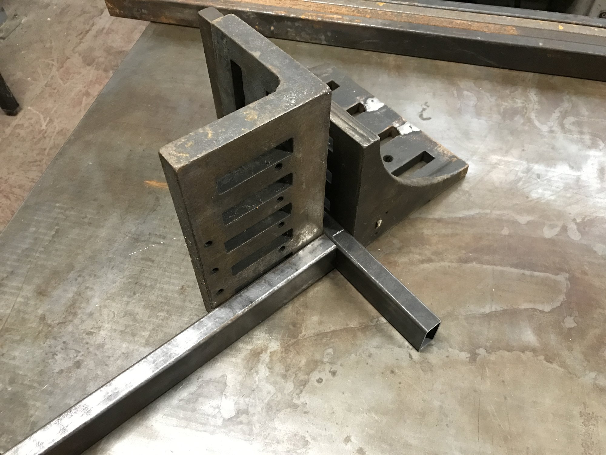

Got my settings right on some off cuts:

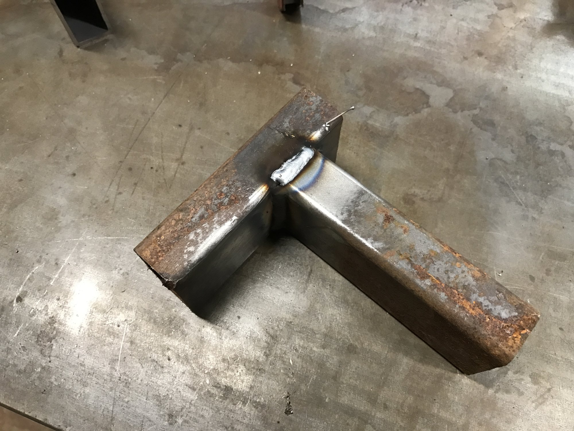

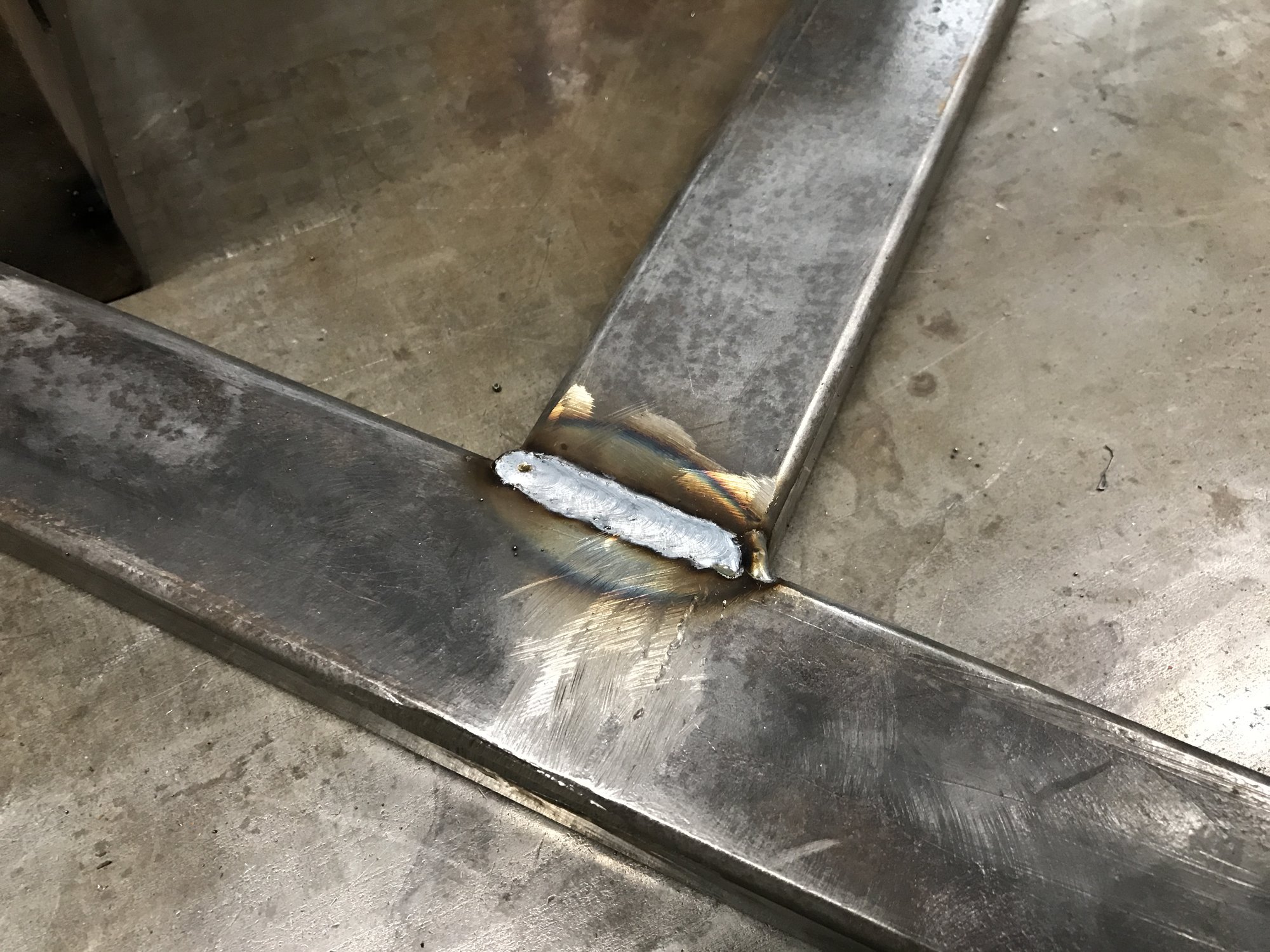

And then proceeded to mess up the first welds:

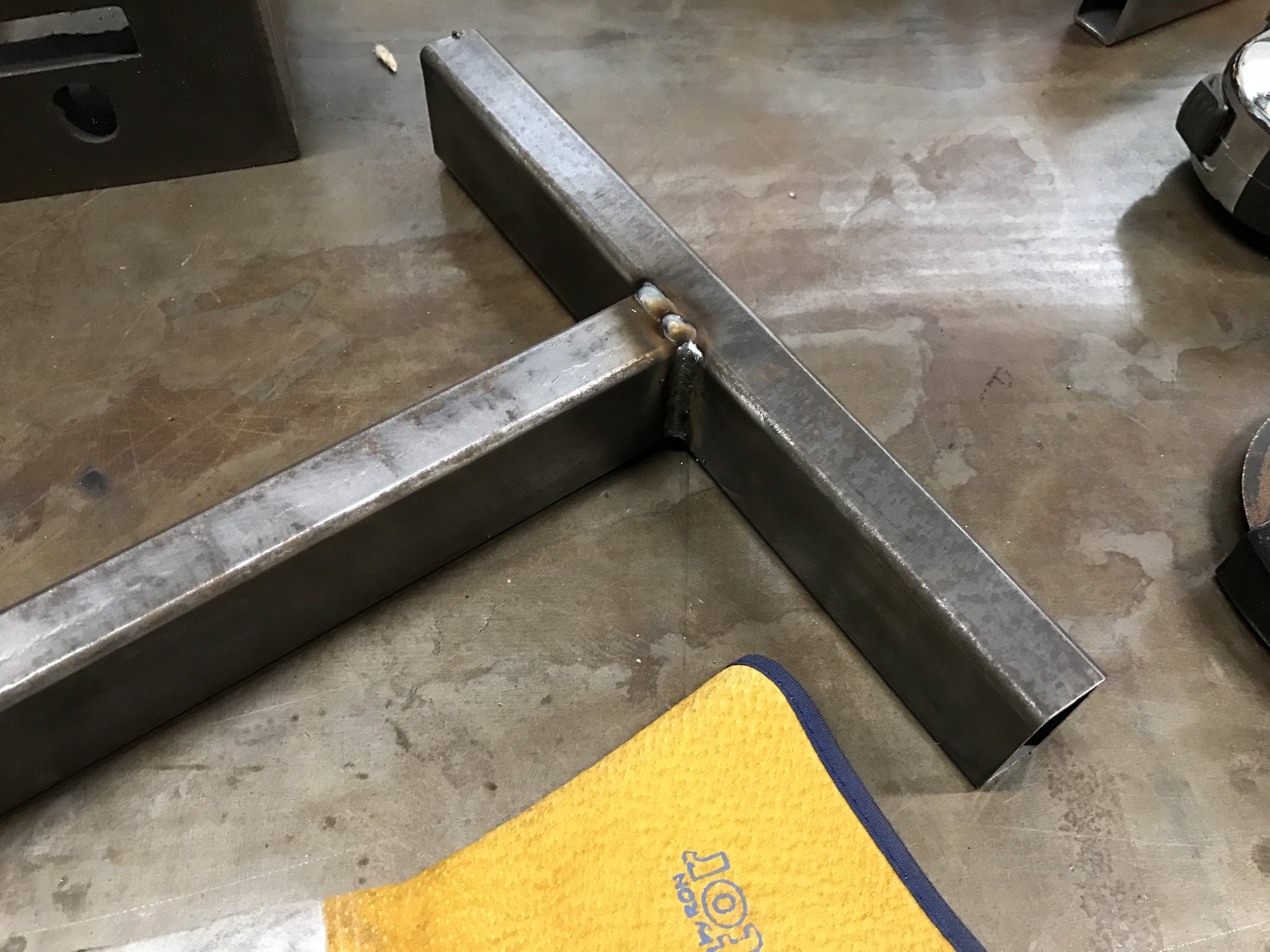

After some cutting and grinding:

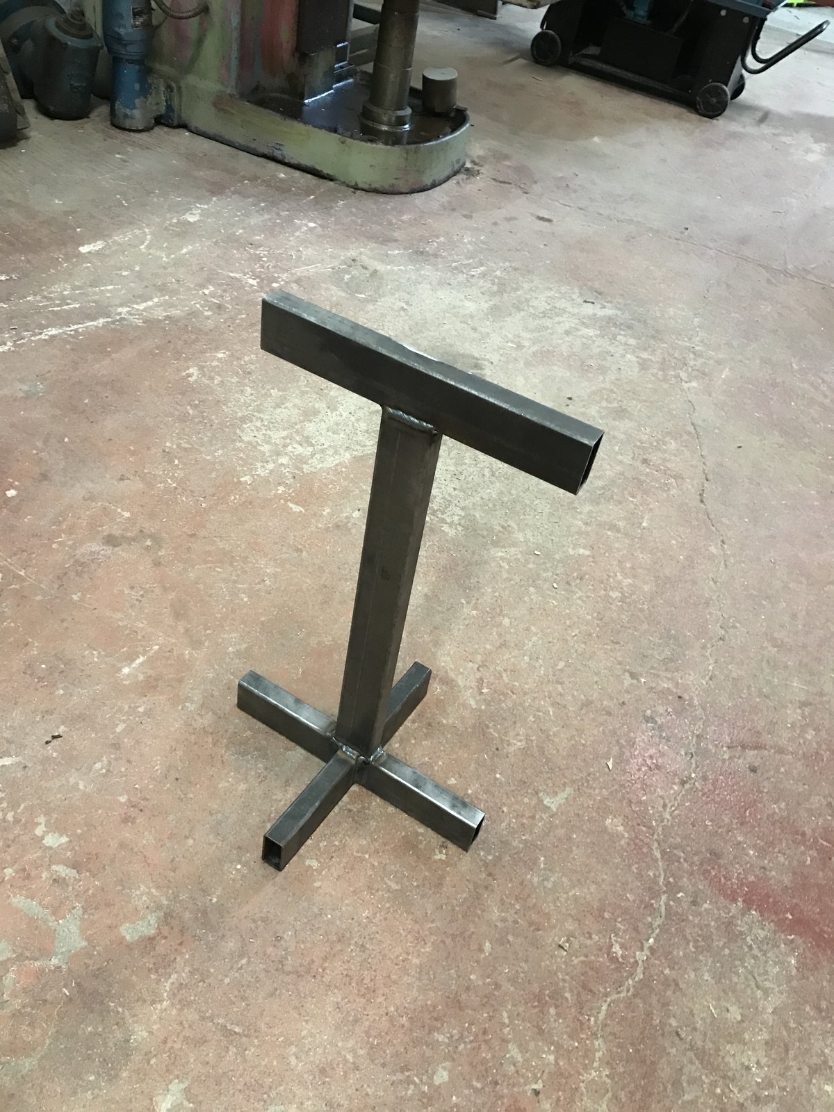

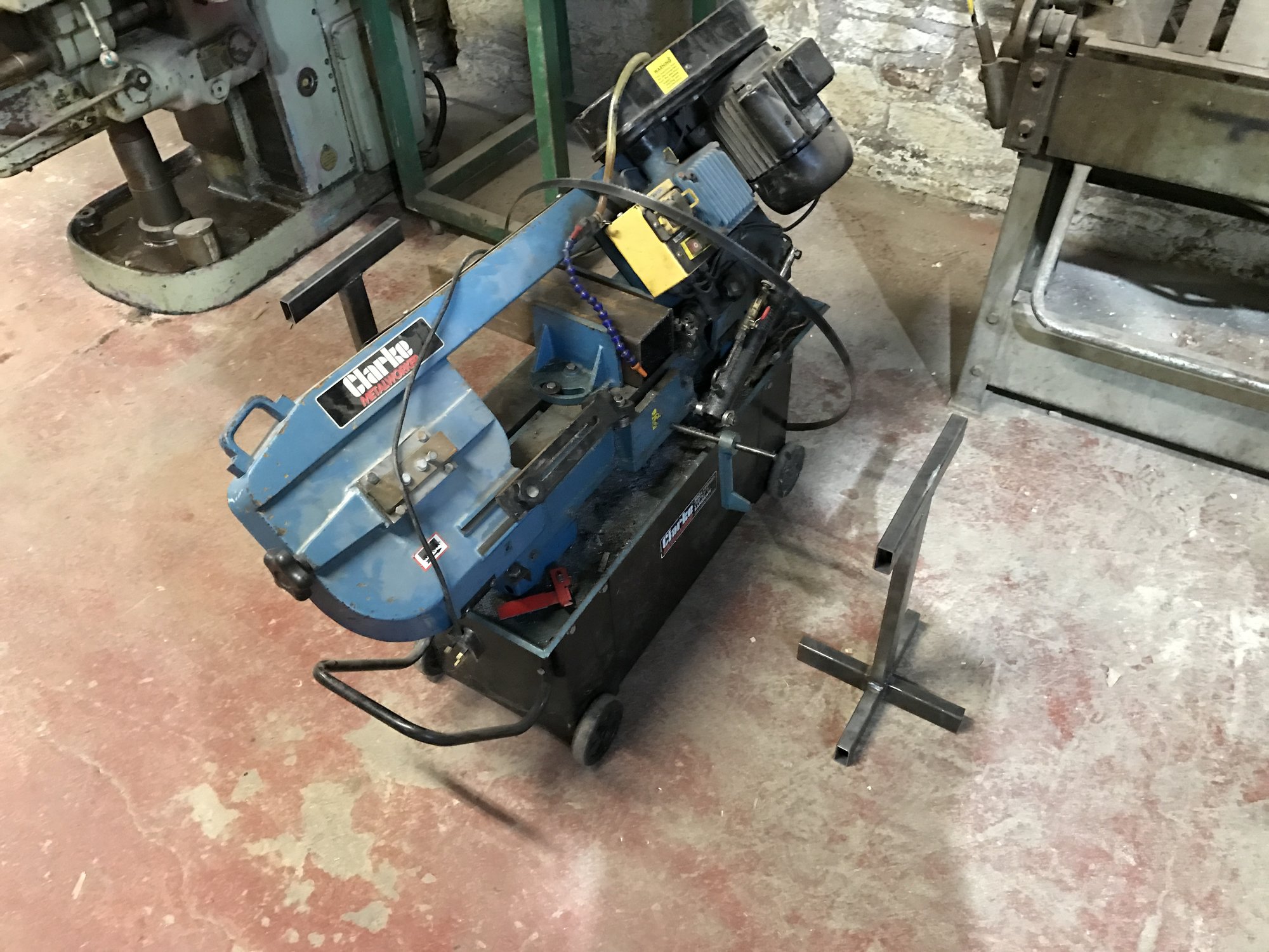

Finished stand, now to weld up the other one:
