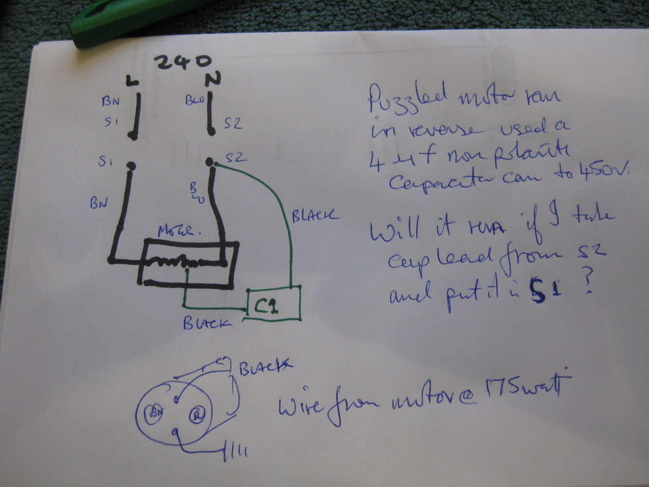

Been trying to sort out a wrecked wet wheel water bath gringd stone. Someone has been at it with a bloody gert big soldering iron & melted lots of insulation ..it was dead when I got it . So replaced the power cord with a more sutraable one and slipped a 5 amp fuse inthe plug . Purchased a new 4uF motor drive capacitor to replace the 30 yr old alu can one as suspect that it was the initial cause of the problem ,
Popped it in the protected socket switched it on ...It lives .
Only problem is it was running back wards , yes it is the original makers Swedish 175 watt motor .
I 've had a couple of strokes and four lots of covid , my memory is not as good as it used to be .
Question

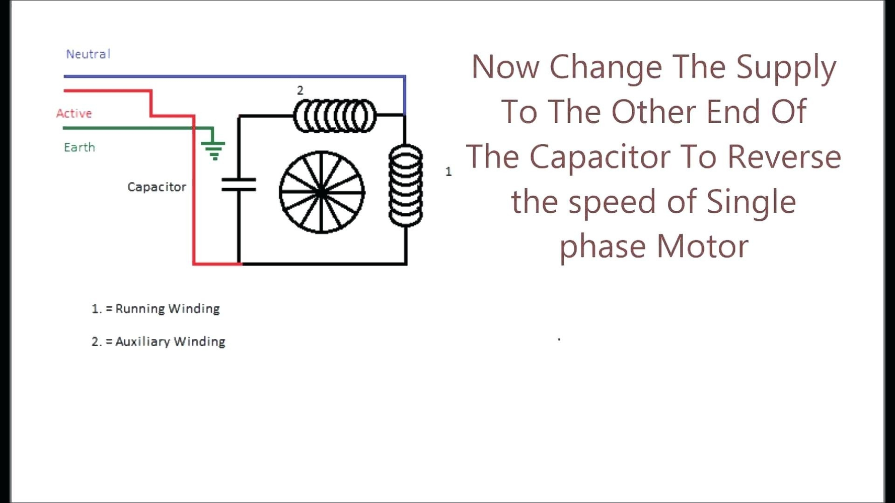

If I take the S2 switched capacitor wire out of S" and put it in S1 switched should it run forward
I don't fully follow this ( BELOW ) diagram instructions
