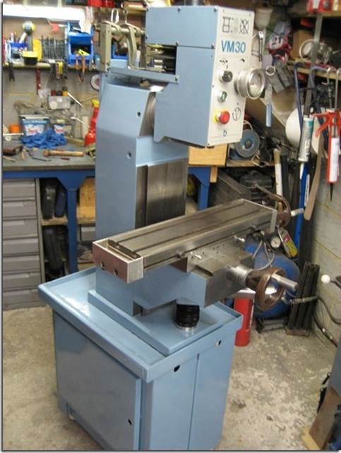

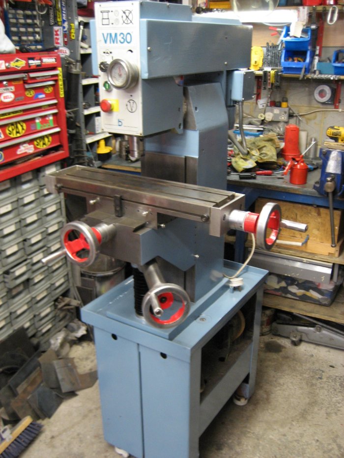

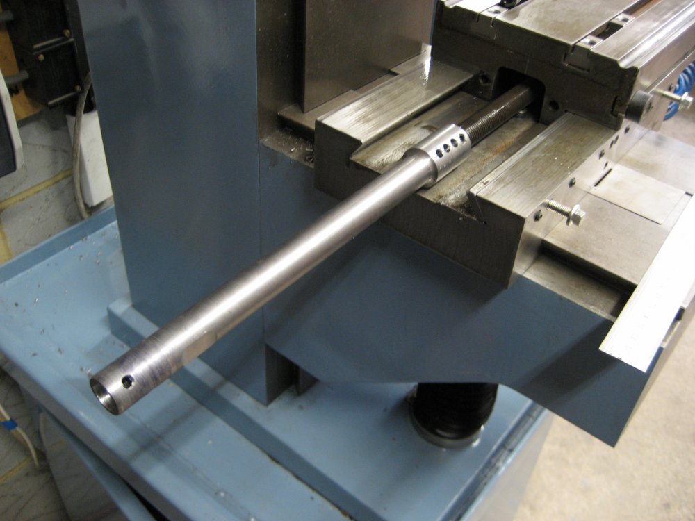

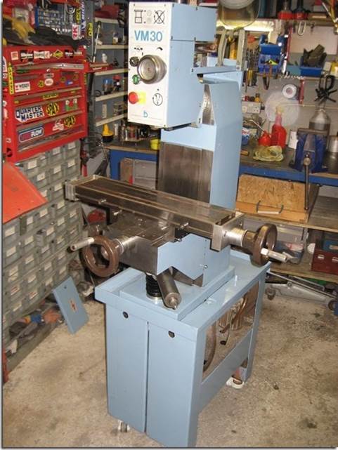

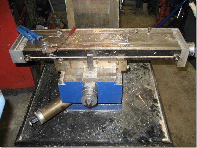

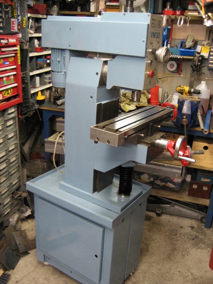

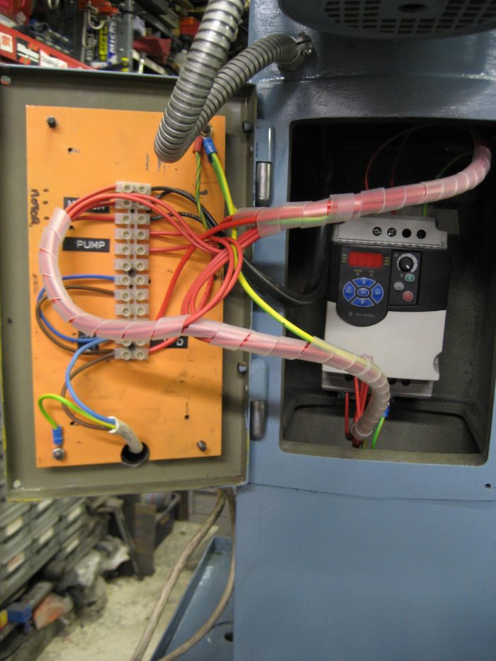

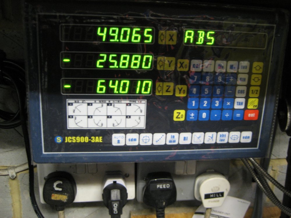

Just a few pics of the mill I'm working on at the moment. It spent its life in a school workshop mostly milling "wood" by the amount of sawdust that was packed into the slideways!!!!
Its an old Boxford VM30. Typical British construction when they did'nt mind pouring a bit more cast iron into the mould

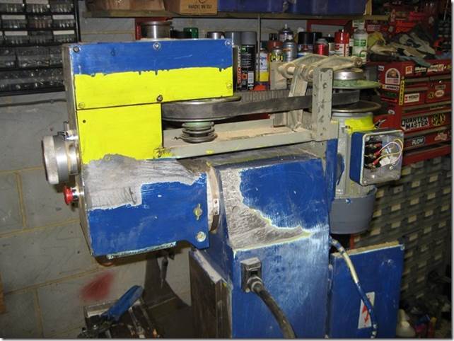

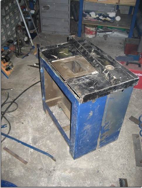

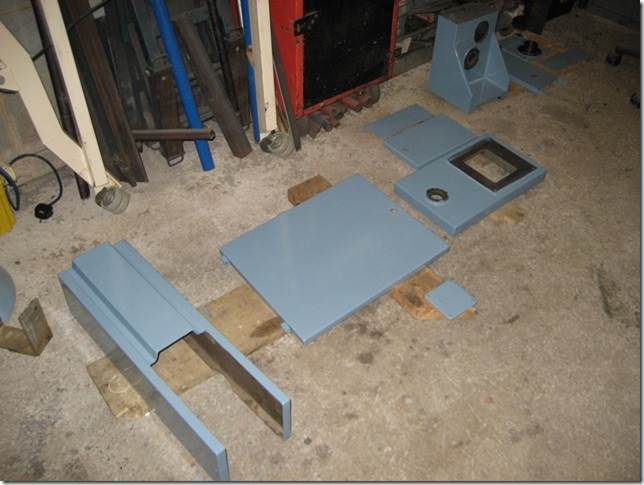

Teacher must have let some of the pupils loose with the standard botchers paint........ Hammerite. Various colours its been, grey, blue, yellow even a nice coat of black hammerite on the table

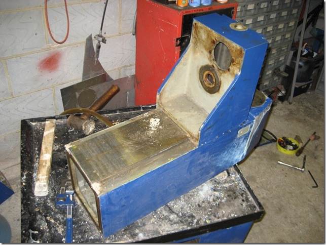

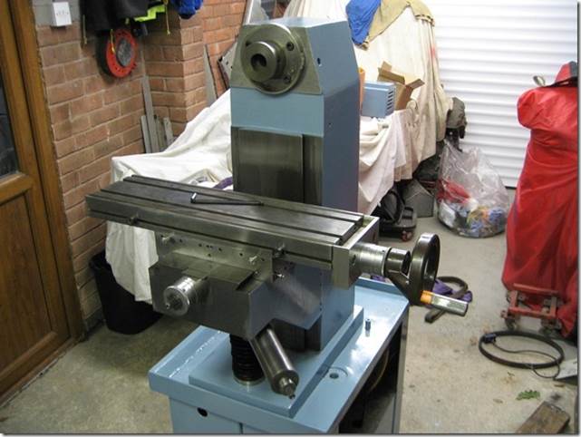

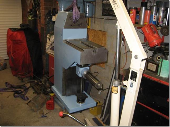

So far I've chopped the base down to a more manageable "limited space in the garage" size. Typical British engineering it was fabricated to last 200 years, and took a few dozen slitting discs and a good workout for the plasma

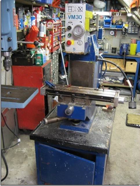

With the help of the forum I've managed somehow to convert the 3-phase motor from star to delta configuration. This has allowed me to use the inverter I picked up off evilbay.

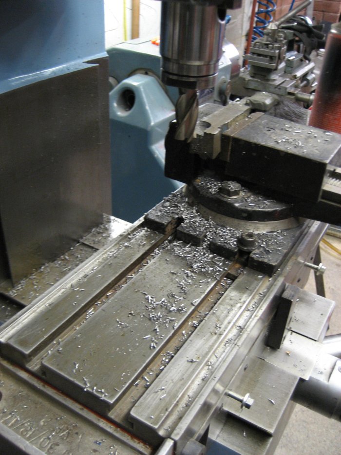

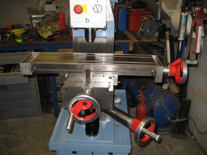

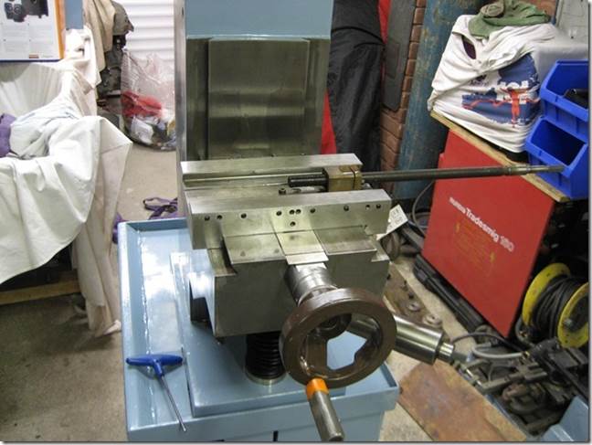

Its been a bit more than a paint brush make-over. I've tidied up the slides and gibs, stoned and scraped where needed. Removed the molasses from the gearbox and put some fresh oil in. Got the high/low ratio selector working (fully gummed up with hardened PVA !!!) Straightened some of the leadscrews which had been damaged during transit.
Next stage is to fit some sort of coolant system to the exisiting tank and a worklight.
Got to find somat to make on it then
