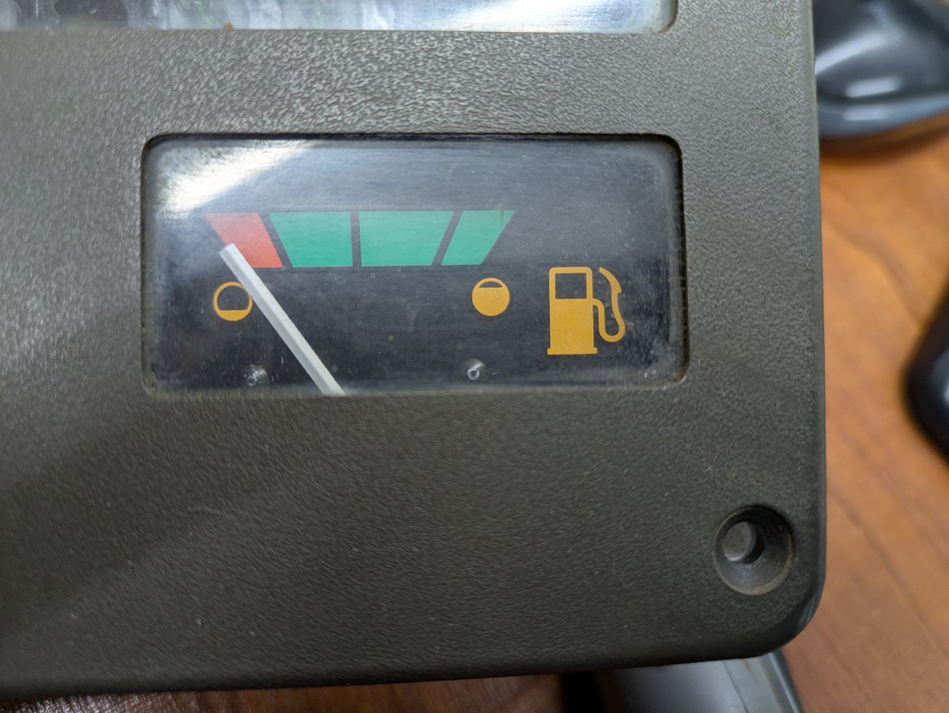

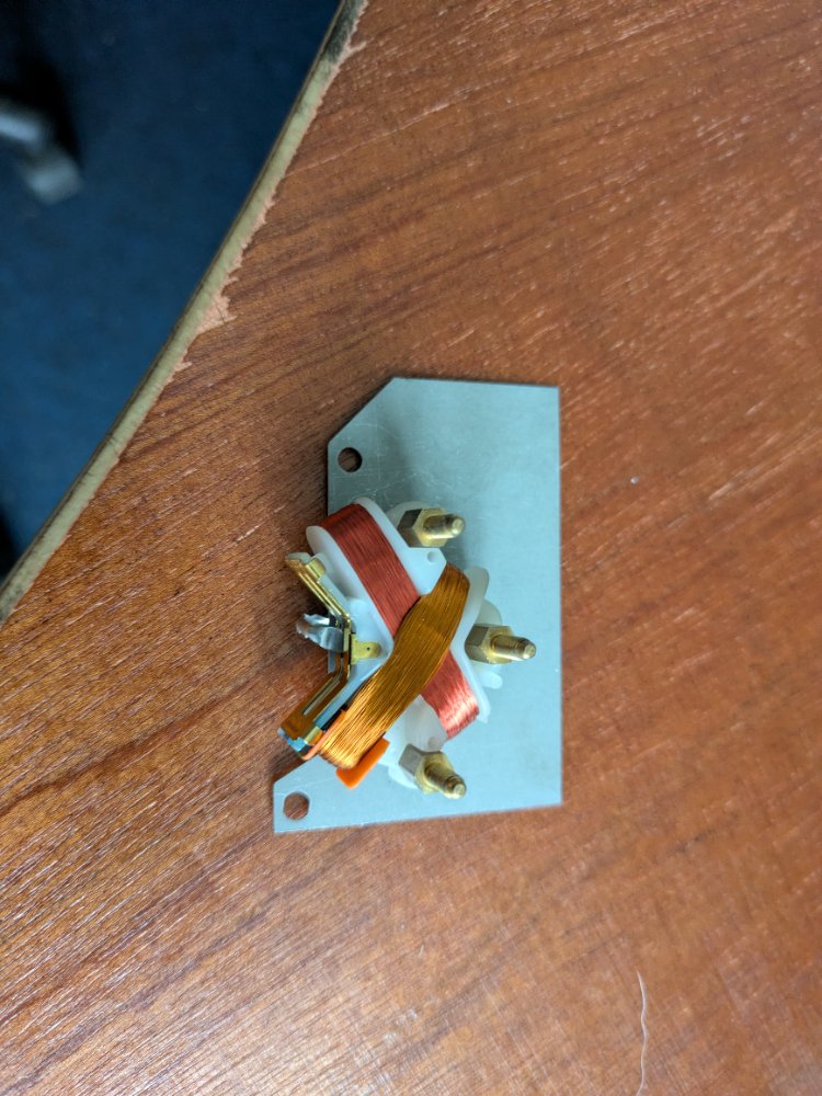

Essentially I've been tasked with fixing a mates Ford 655D back hoe's fuel gauge. It's an odd moving coil setup and one of the windings is broken. I've got an X27-589 stepper motor (which is used in a lot of instrument clusters) working but it's too big or rather wrong shape. It's an old Jaeger fuel gauge that is no longer available and was only used for a very small run of machines by the looks of it.

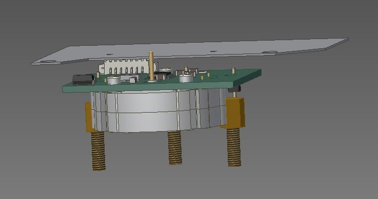

There's not a lot of height to play with the grey board up the top is the decal plate. The M3 standoffs sink into clips on the carrier board so everything needs to stay above the threaded portion. A grand total of 16.2mm to play with.
Now the above has been designed and would work except...

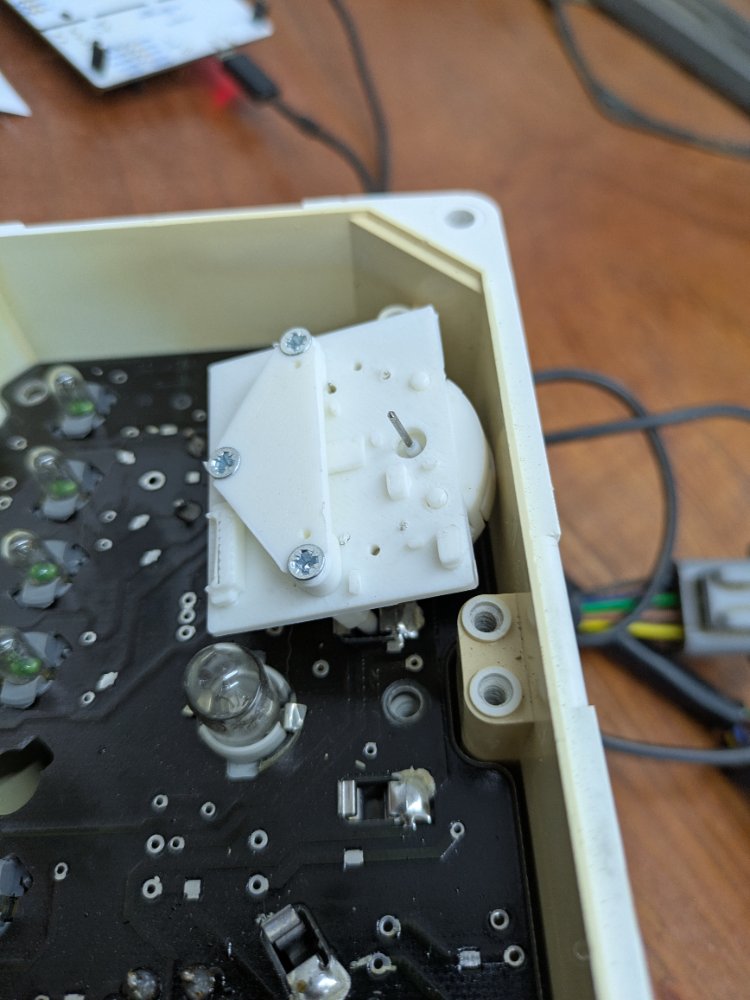

The motor sticking out past the PCB means it doesn't slot into place. The pivot point has been kept the same to keep the geometry the same
So does anyone have any bright ideas? The mechanics of things means that the whole thing needs to fit under the decal plate (there is a bit of leeway but we're talking millimeters).
Currently winning is to come up with some tiny linkage to relocate the motor (that in itself is no mean feat because of causing clashes elsewhere).
