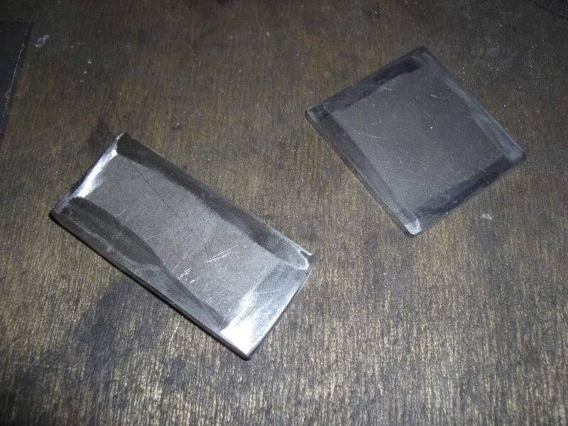

Background - My 306 HDi keeps snapping engine mounts due to excess movement as there is too much clearance between the mount buffers and chassis, the pic below shows this but after I have welded the plates in (imagine the clearance if they werent there)
I decided to weld in some plate to fill the clearances, ~5mm at the front and ~3mm at the rear, the chassis panel thickness around here is 3mm. THese are the plates

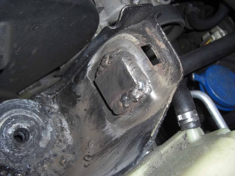

The front plate welded on

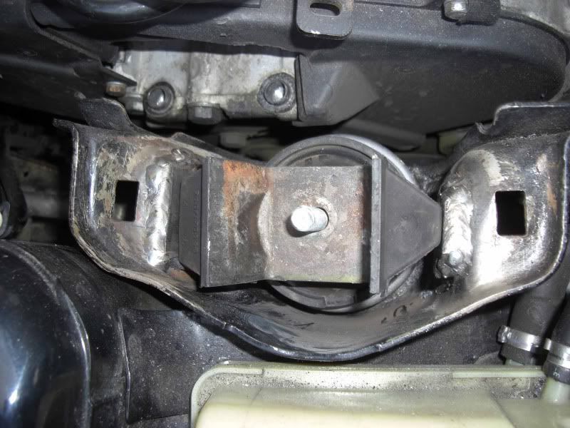

and the rear plate welded on
I did a test of 5mm onto 3mm prior to starting and I couldnt break it off so I went ahead. I'm pleased with the top welds but getting to the sides was a right pain.
I finished it of with galv spray and top coat, the final assembly turned out as above. I'm not sure if the breaking mounts are no more as the repair was only done a few days ago, but it certainly feels a million times better to drive!
