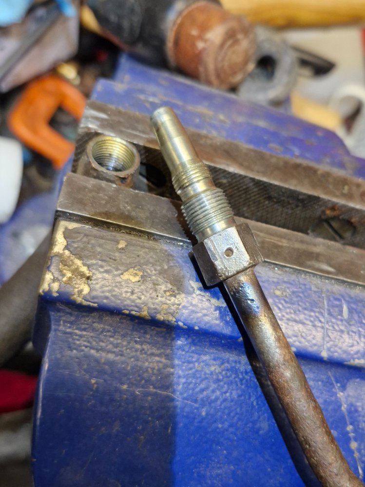

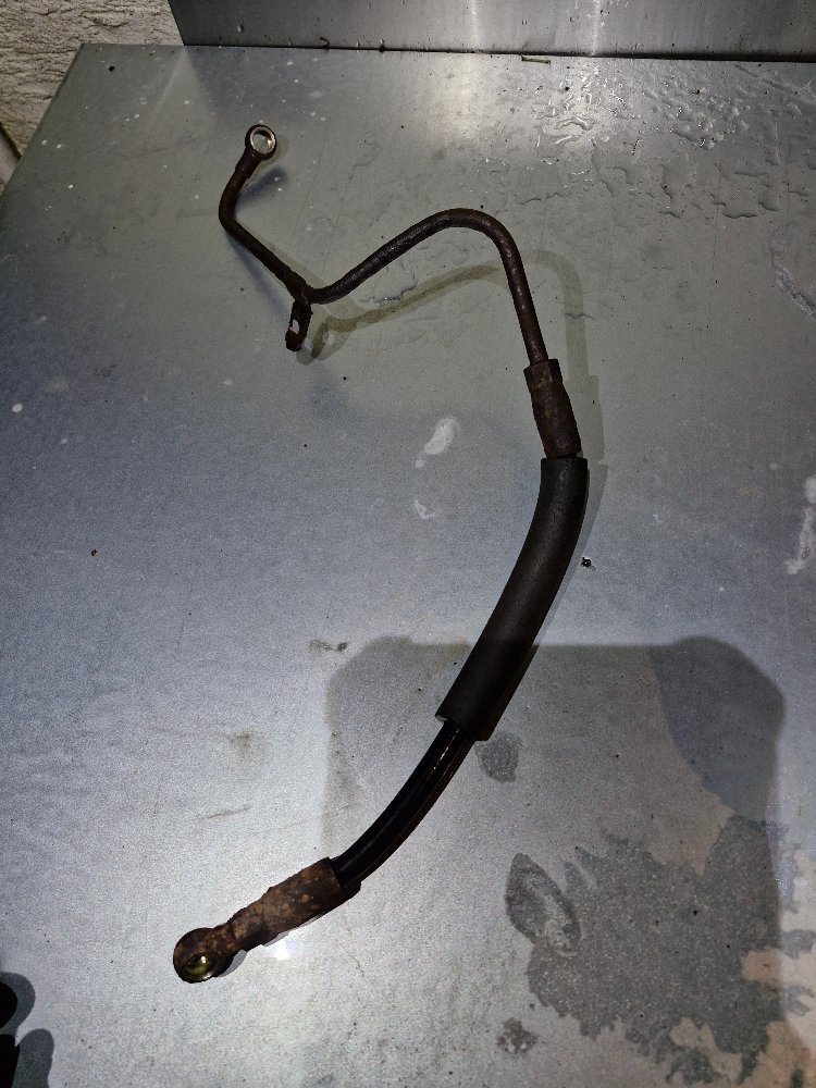

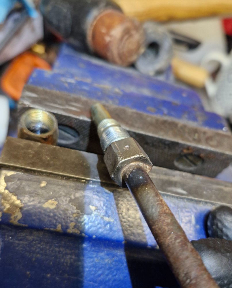

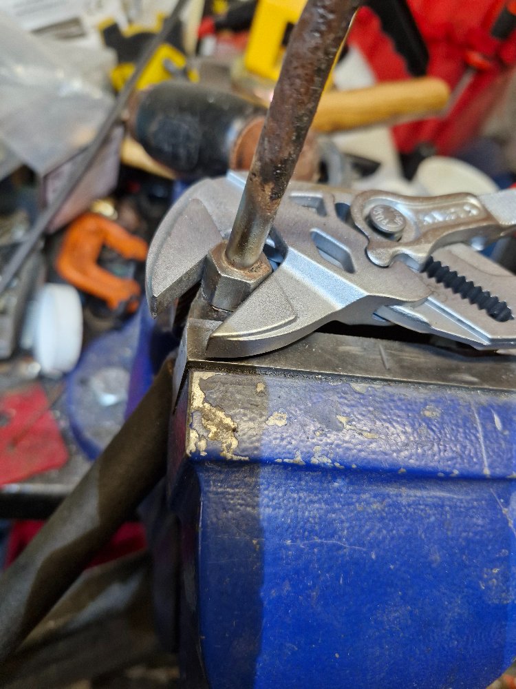

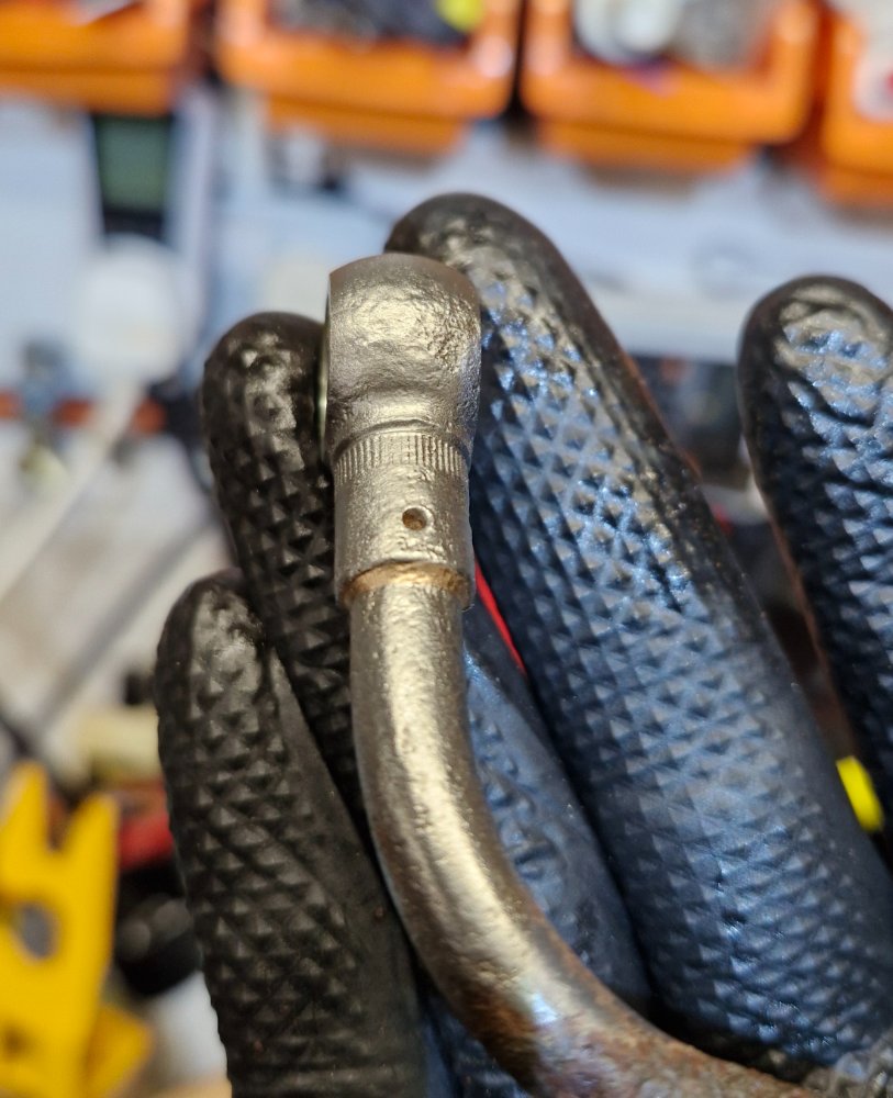

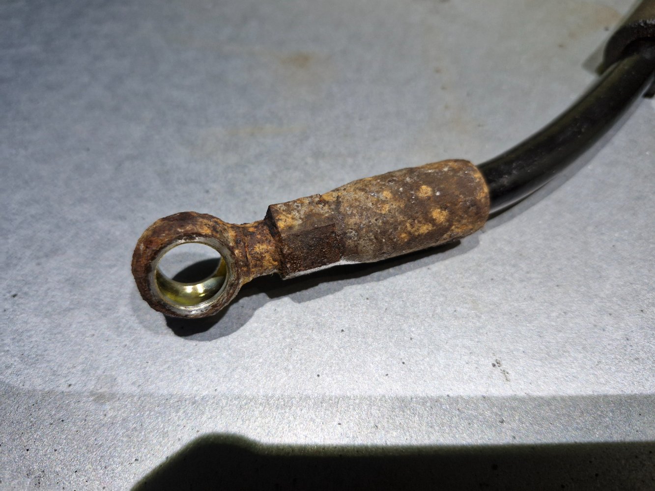

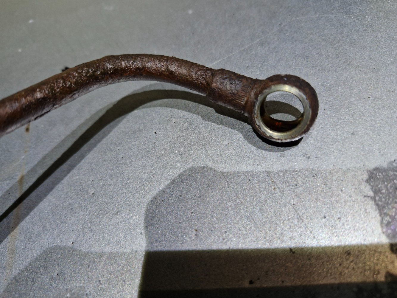

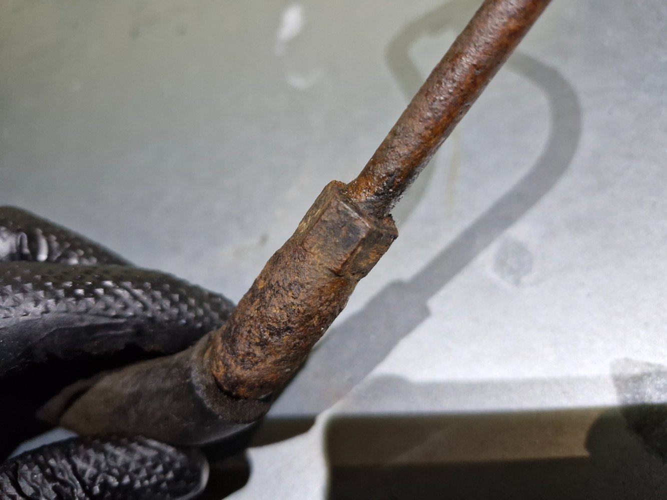

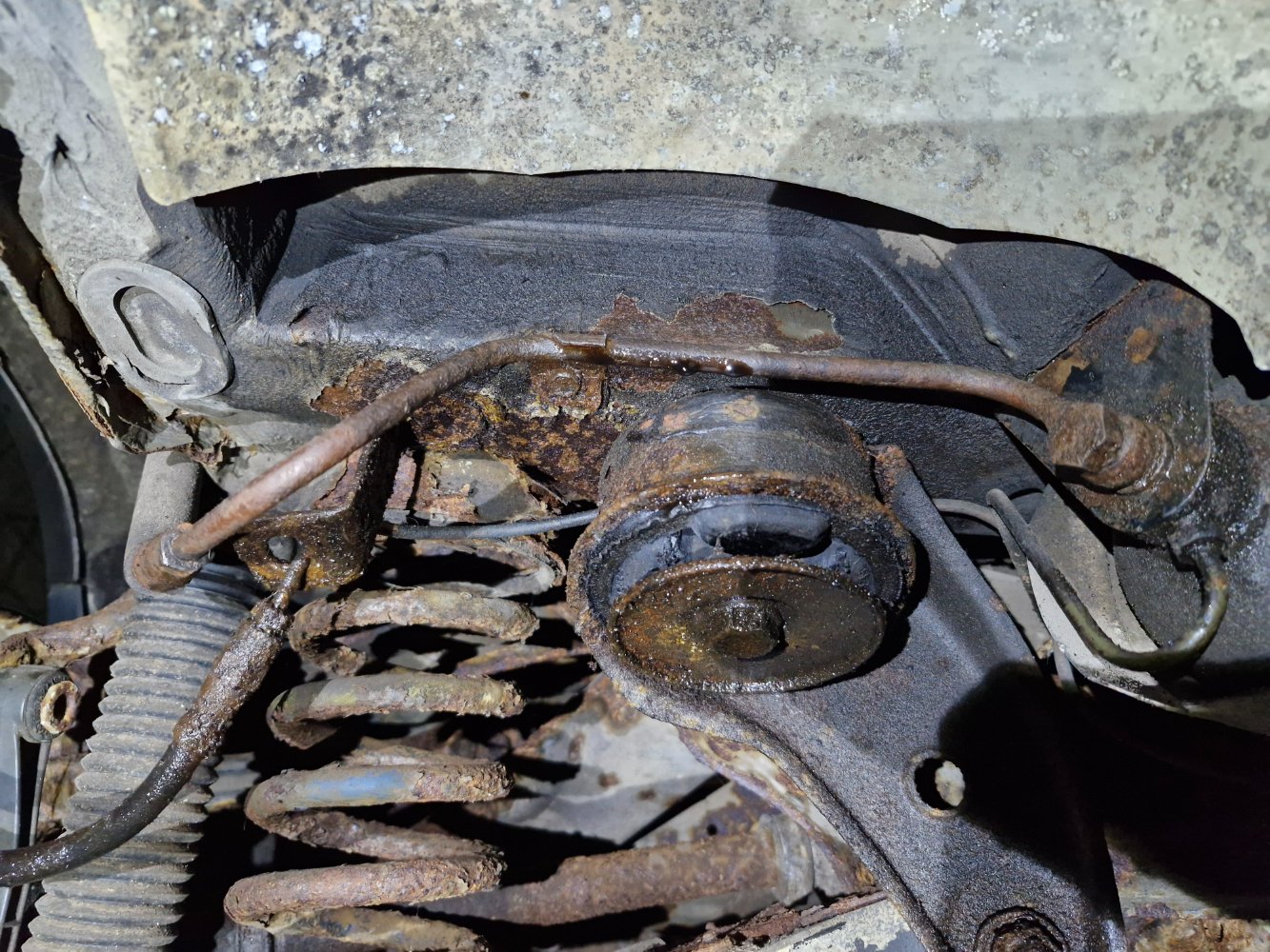

On my 1989 Merc cossie - one self levelling suspension hard line is leaking.
I think the part is NLA or if available sites are showing a price of £225+!
I am thinking of remaking that section with 5/16 Kunifer. The old steel tube is measuring around 8mm OD so thats very close in size.

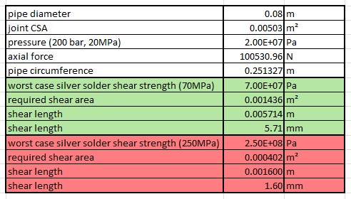

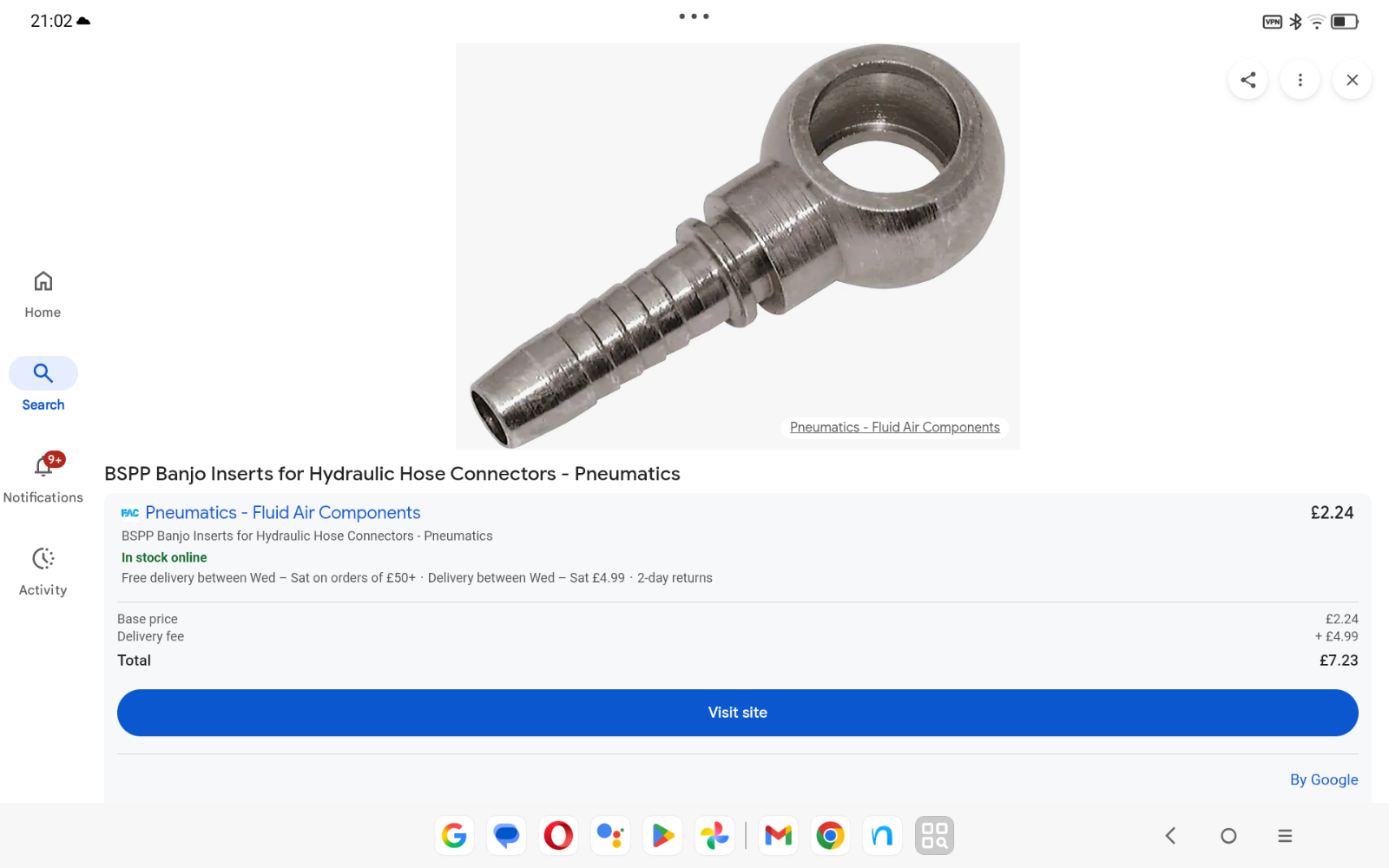

For banjo fittings can they be bought bare and maybe braze it onto the Kunifer? Silver solder from a google?
