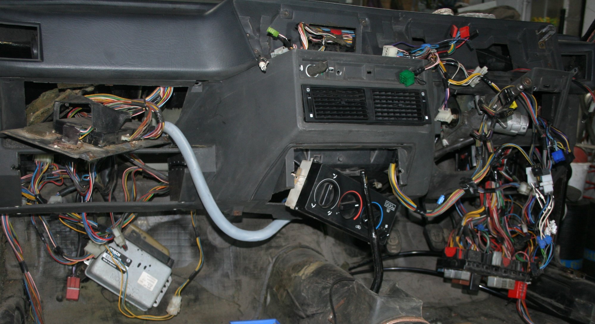

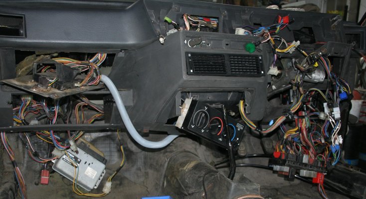

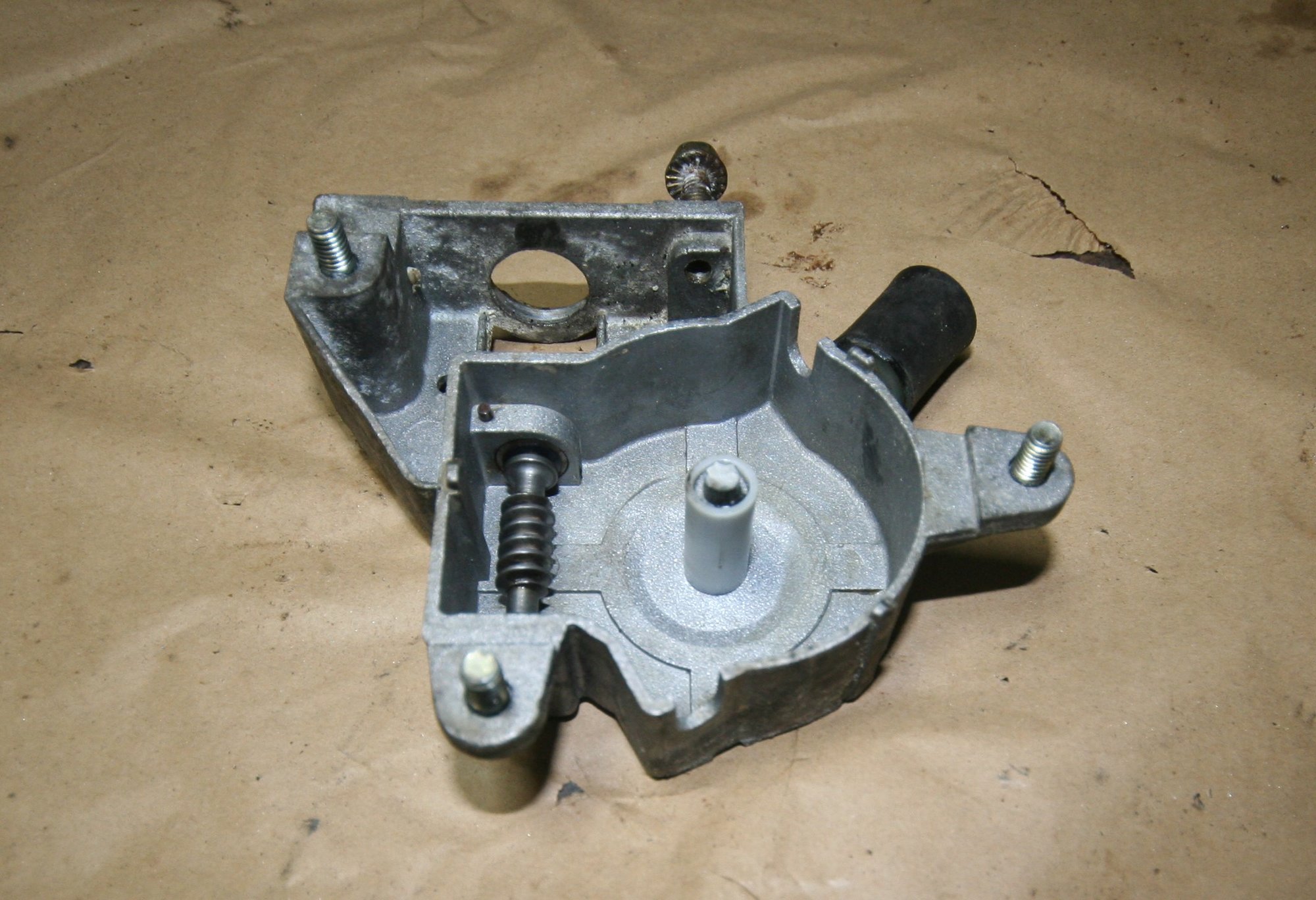

I’m putting my alfa back together and fixing the electrical gremlins as they appear. (There are lots)

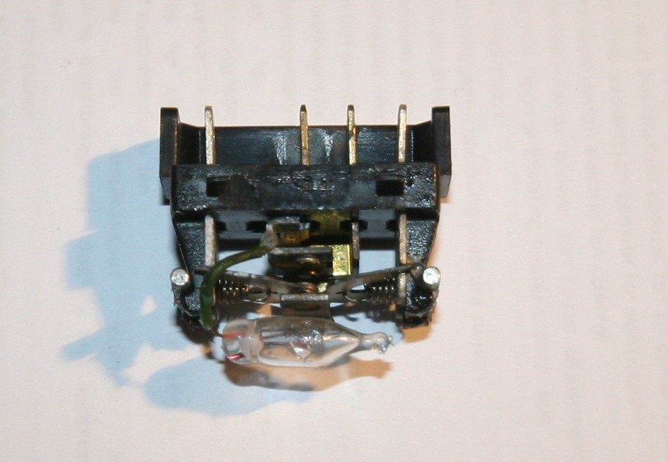

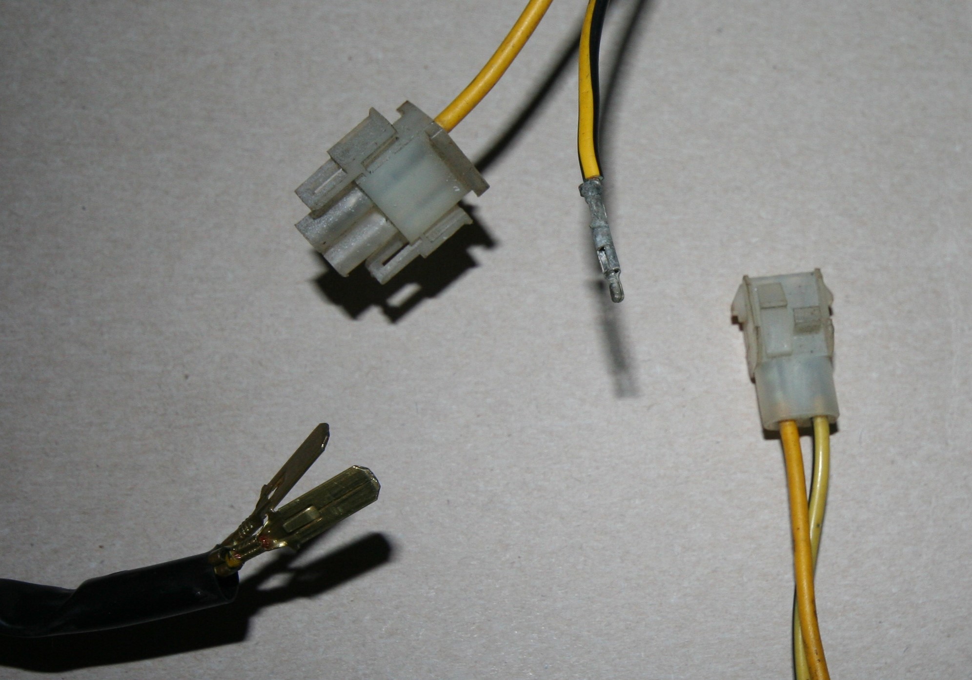

The one electric window motor I connected didn't work so I checked a few things and even took the switch apart but it looked ok.
I found the problem was in a connector block breaking down under load.
There are lods of pin connector blocks, is there a way of improving the connections without replacing everything?
Anyway I fixed (cleaned) that duff connector and it worked but the motor was dead slow. It was also pulling 13amps!

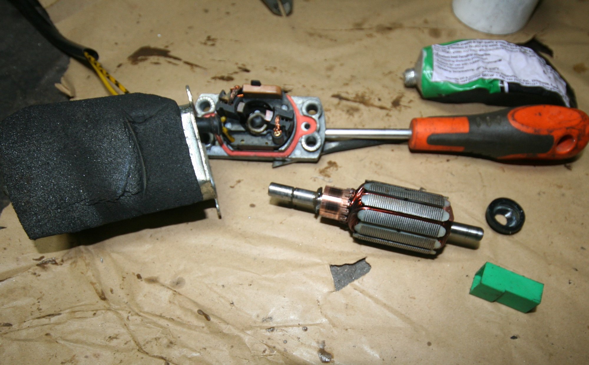

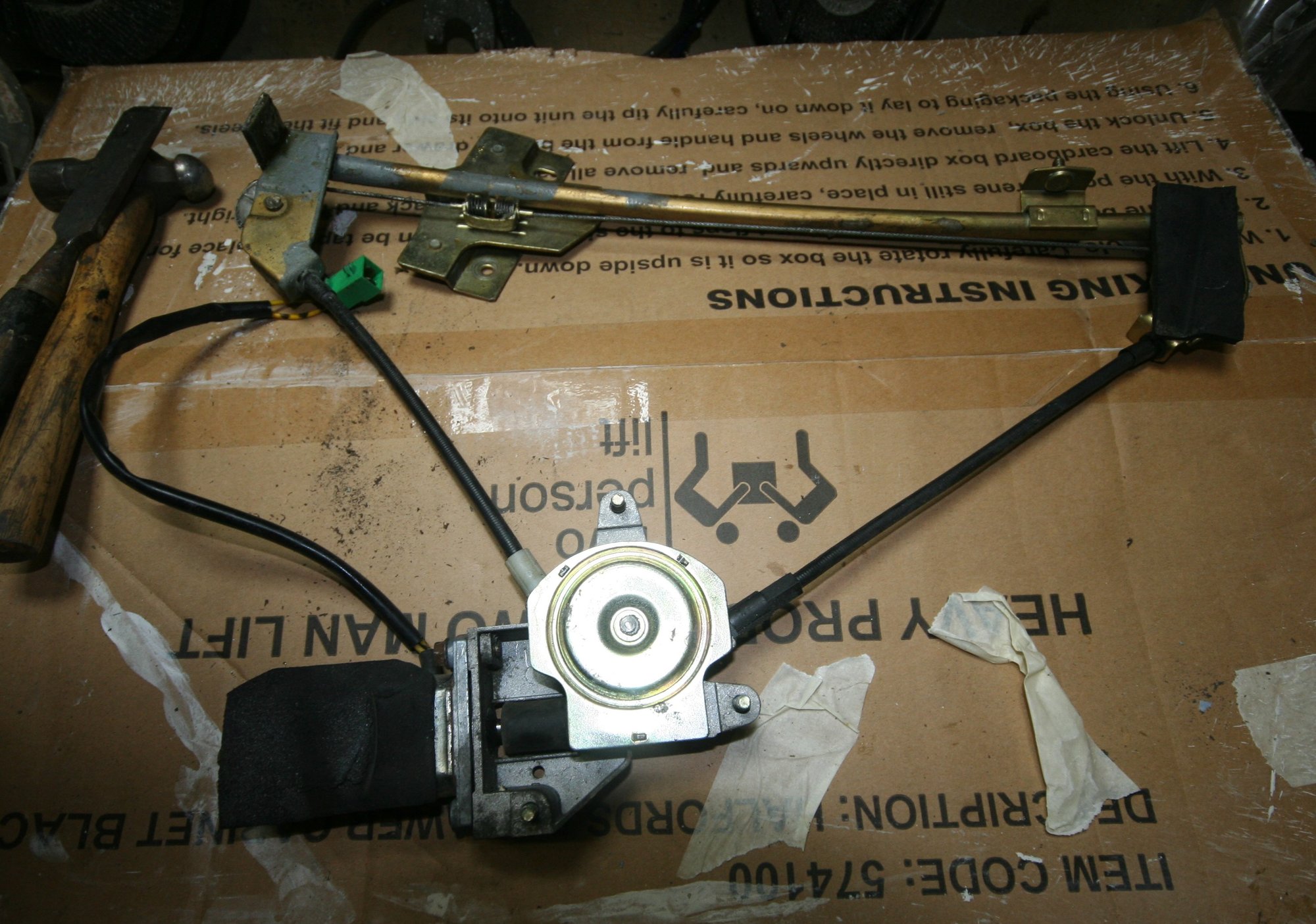

I had greased the regulator before I rebuilt the door and it seemed to be working fine on the bench but I pulled it completely apart, cleaned and greased everything in the mechanism with silicone grease.
I even pulled the motor apart to see what condition it was in but it all look good, I didn’t even need to clean the commutator.
So I rebuilt everything and when I reinstalled it, it worked great and pulled 5.5 amps dropping the window and 6.5 raising it. It was also far quicker in operation.
Does 5 or 6 amps sound about right?
It pulled about 3.5 amps on the bench when installed in the regulator.
While looking for the fault I ran a couple of 6mm2 wires from the battery direct to the motor and it did help a lot, however now they are working better the difference in shorting out the switch and wiring is minimal.
So job done?
Well the issue I have is this is a 25 year old Italian car and the switches are no longer available.
The only switch I found was in America and it was over $70 but they wanted $200 for postage.

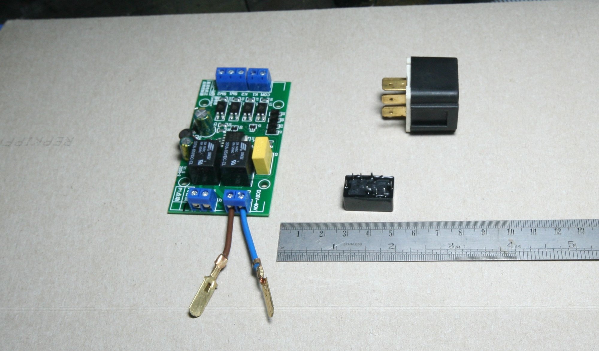

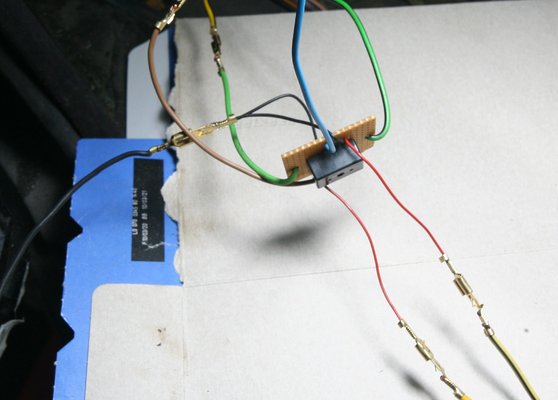

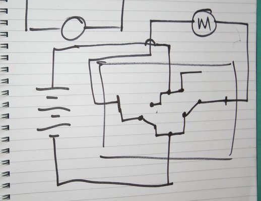

I want to install relays to take the load off the switches and hopefully help preserve them.
I need a relay on the live and return and think I could do it with 2 change over relays but is there a better way of doing this?
There are only motors on the fronts regulators so a few relays is no big deal but I would also like to put relays on the sunroof as well and there is less room there.
Any ideas?
