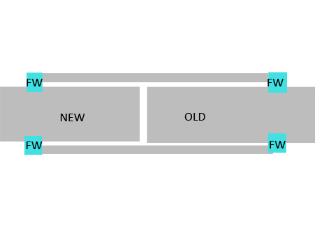

Im after some advice, our welding contractor is replacing some aluminium pipework and will weld old to new.
We do not know the old Aluminium composition so the contractor has proposed rather than a standard butt weld (old to new) they will have an aluminium sleeve over the top with fillet welds.
Is there any advice or risk to using the sleeve weld?
Also what is the risk with the old unknown grade of Aluminium?
