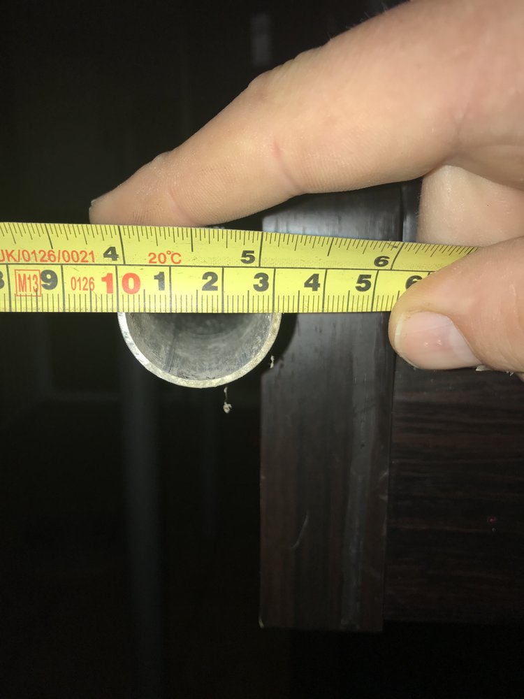

I wouldn't sleave it in Alloy.
Even if they don't react I can see the inside of the alloy condensating and growing corrosion. And aluminium corrosion can be nasty sharp pointy stuff.
Why not just stick the copper in, wrap a couple of strips of cardboard around each end of the plain copper and stuff them up in the hole to center it then fill up the outsides with sealer.
If you have to rip it out and replace it in 10yrs time it's not the end of the world.
Or, I might have some thin wall heatshrink that will roll up to go in the post
