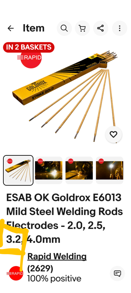

110A it's cold for meI found running a rod on the hot side will leave little slag to be chipped off, I assume it turns to splatter or perhaps some stays in the weld?
Running cold there is more slag to chip.
110a doesnt sound hot for a 3.2mm, but each machine is a bit different. Hotness also depends what thickness you are welding.
