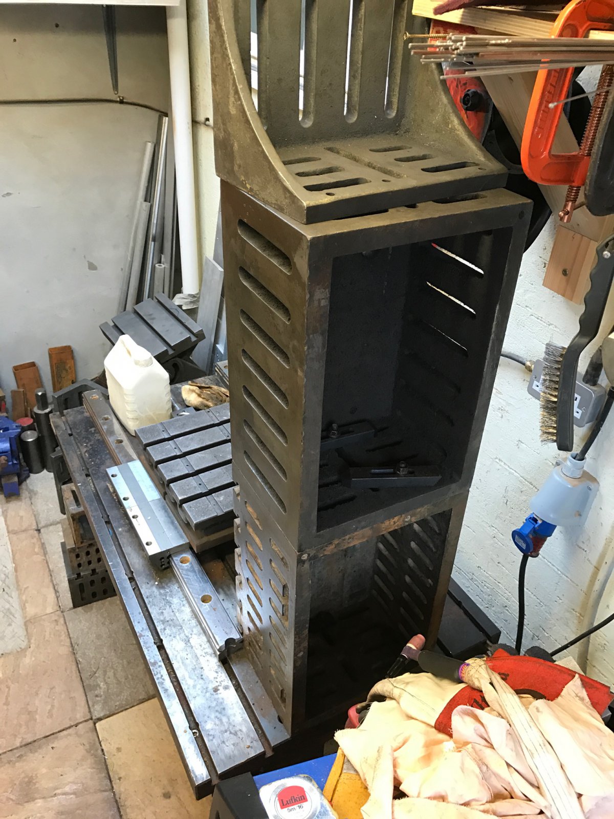

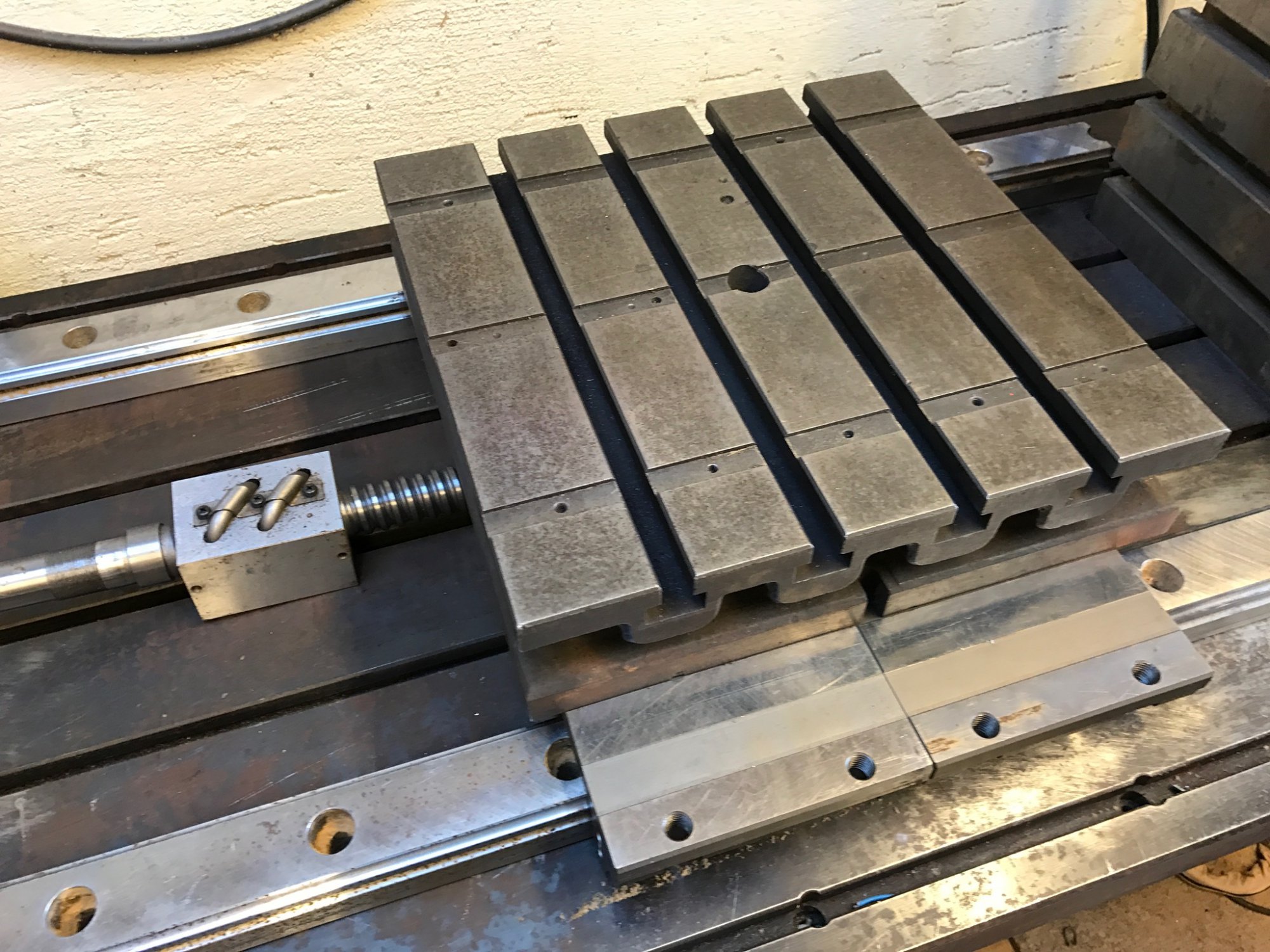

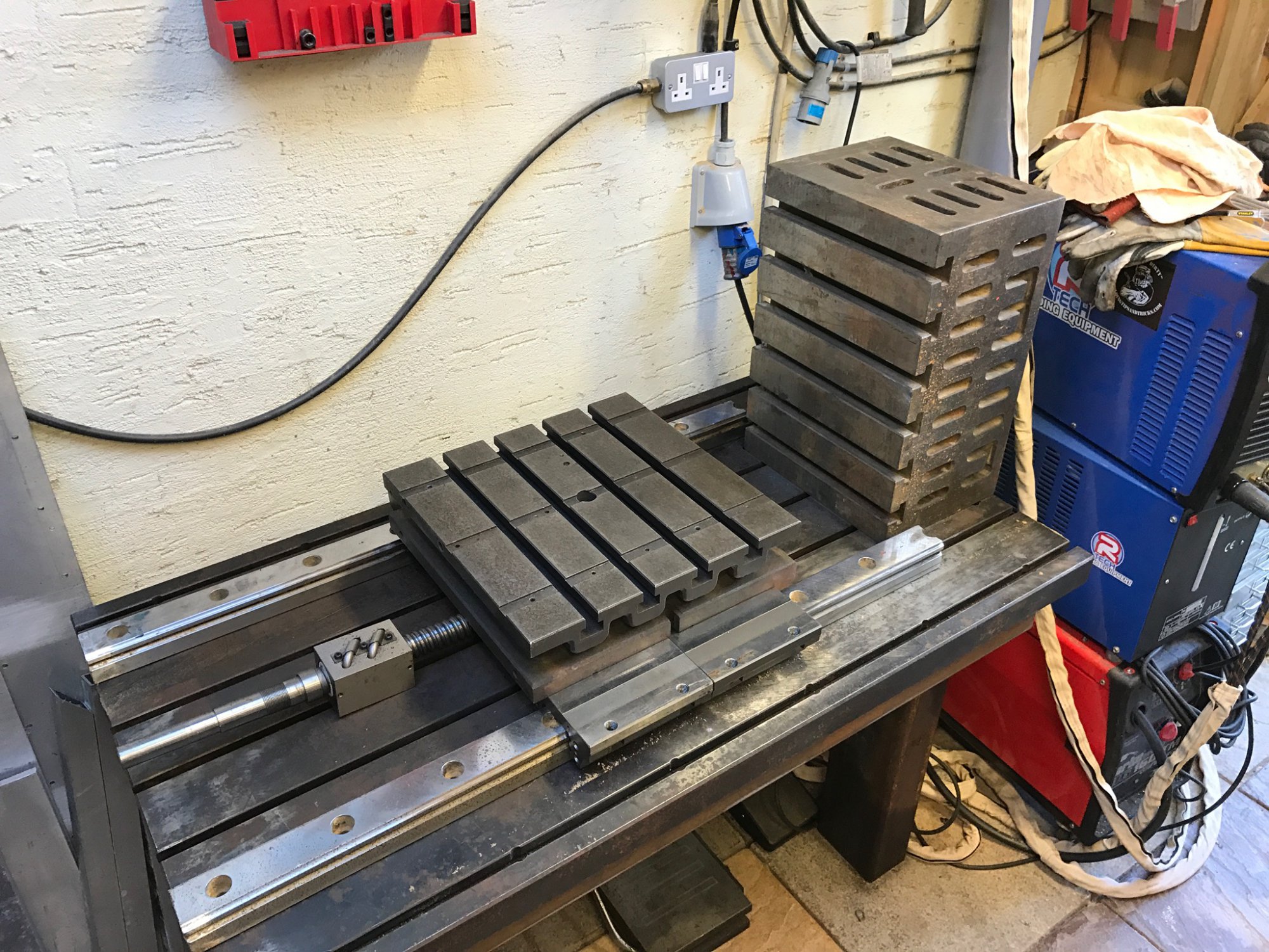

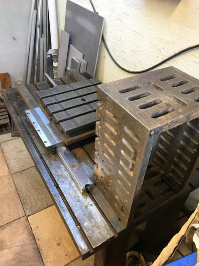

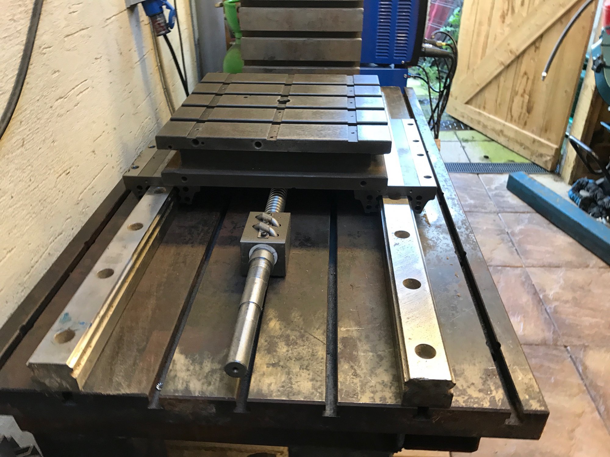

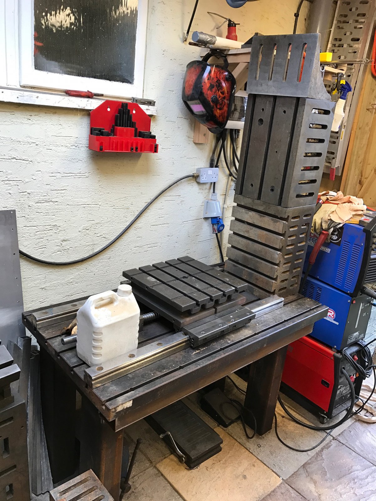

As a little side project I am putting together a solid little cnc VMC. I haven't really got any real use in mind apart from cutting some parts for my next CNC router build.
I have a whole lot more castings due to arrive soon including a second 18x12x9 engineers cube which will go on top of the current one to create the column.
I have more of the 55mm rails and a second ball screw for the Y. I have a huge 9' long 55mm ball screw for the Z which will be cut and turned down in the lathe.
Only thing I don't have at the moment is a plate suitable for the saddle, looking for something like 1" thick by 15" x 30".
Spindle will be the head off of an X3 mini mill converted to a power draw bar and 2.2kw servo drive.

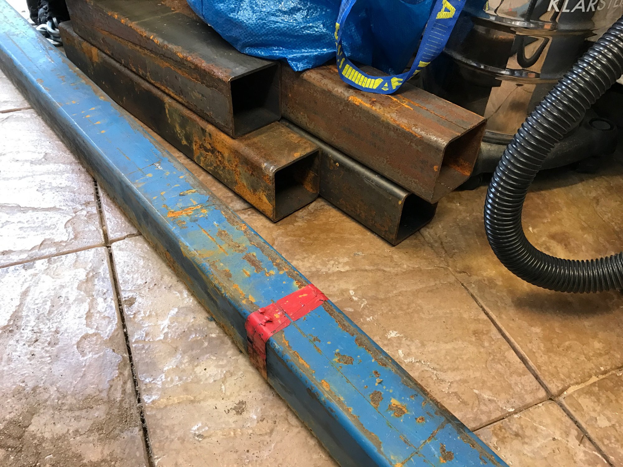

Got to rebuild the frame under the plate, I have a bunch of 80mm SHS 5mm for this which I will weld with the Rtech in MMA mode.
