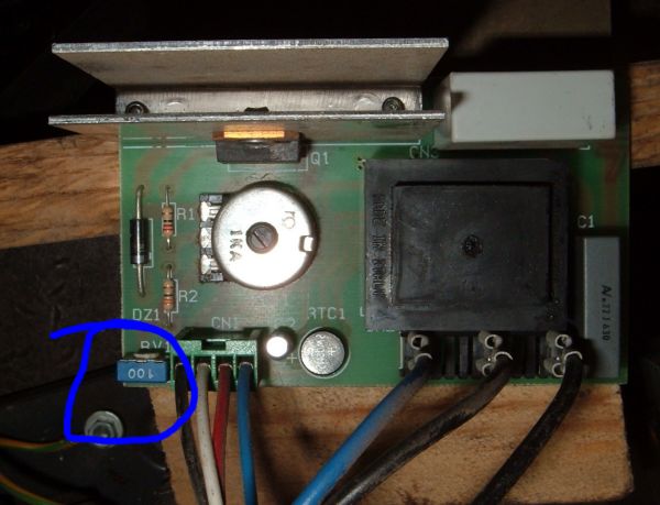

just fitted components to circuit board.motor still runs backwards.dc at tip
next time i used the mig the motor ran backwards.took the side off and swapped the motor leads round and did a weld on a bit of scrap steel,welded almost ok, `almost `coz although the wire speed adjusted fine the weld seemed too hot burning holes.
