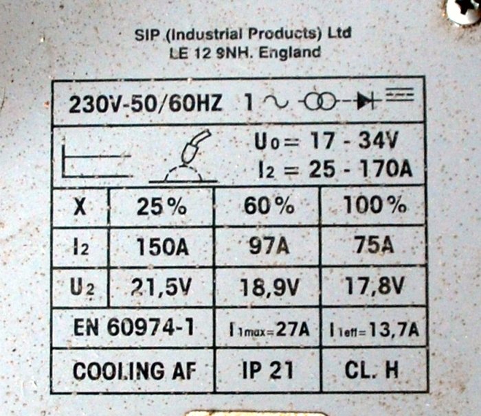

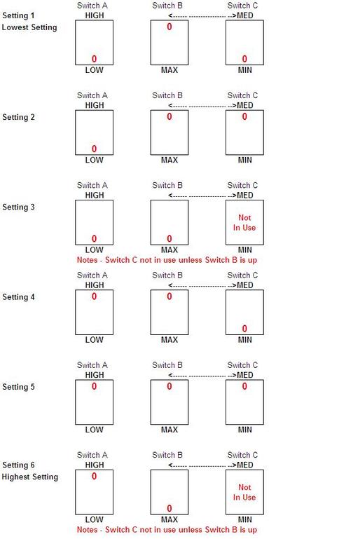

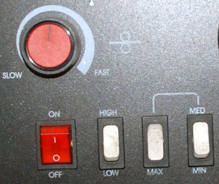

I'm new(ish) to welding, using for car body stuff mainly and have had patchy success. Obviously there's nothing like practice, but I need help with working out what all controls mean, as the leaflet that came with the welder was very basic and I suspect I'm wasting a lot of wire and gas!
I know that wire speed is crucial. But the control panel has no numbers at all and what's all the Max Med and Min about?
Does the panel on the top give me any clues as to settings I should use?
Thanks in advance
Steve
Thanks in advance
Steve
