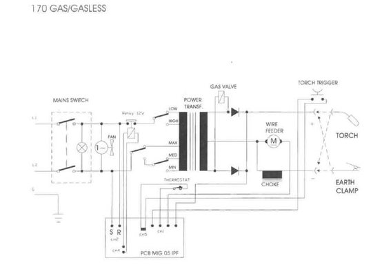

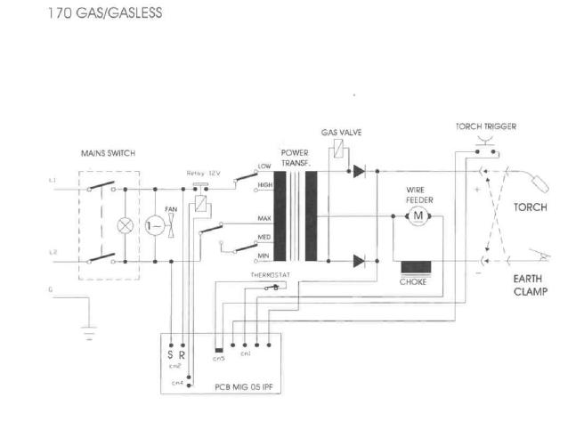

Hi. Can anyone help please. I have been given a migmate 130 by one of my friends with the gun in bits as he said it would not work. I have put it back together and it pulls the wire through fine but the swan neck part seems to be missing and I cant see were to connect the two wires to. I have connected the red one to the back of the trigger but can,t see were the white one goes. Has anyone got any ideas please.
