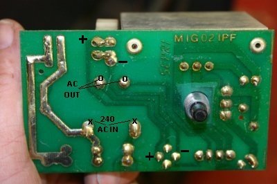

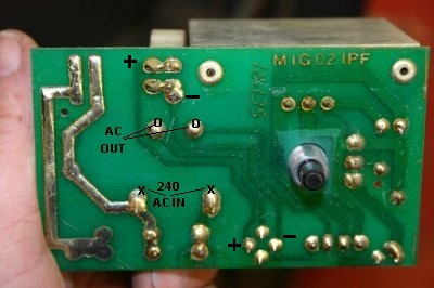

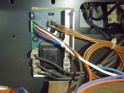

I’ve taken the pcb out of the unit MIG03IPF. I noticed the relay contacts looked dirty so I took the cover off. With the unit switched on I can manually activate the relay by hand and the wire feed starts working and the unit will strike an arc. It seems whatever is supplying power to the coil in the relay isn’t working.
Does anyone have any idea what it might be? Is there a cutout switch somewhere I could check? Is it the pcb? If it’s the pcb where can I get a replacement or old one repaired?

) that gave an RS number but several mentions of a 240 IN 12 OUT (ac in both cases!) There is nothing to stop you fitting a much larger one as you will find it difficult to find an exact match for the pin out of the existing transformer. Should only be looking at a lot less than £20 for a suitable one. Use to be able to rip apart an on radio or similar for the transformer but most have now shrunk there power requirements and so small transformer are fitted
