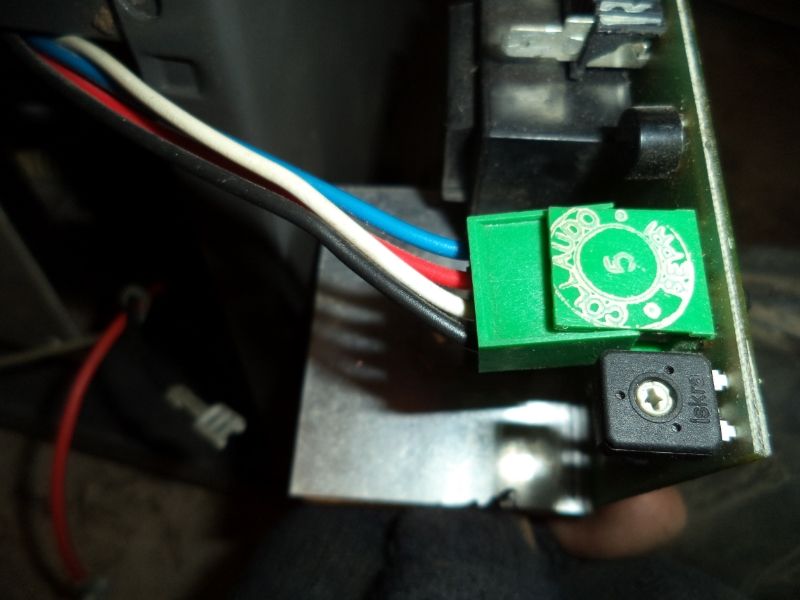

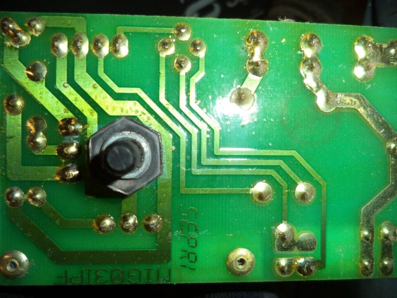

Happy to help , and the good thing is I had a look through my assorted parts and found a suitable relay so will repair that board and return it as a spare.

the relay is only a couple of ££ from maplins they dont last forever and its an easy fix
That's good to know Sean. masleeve said they were only a couple of £ but I wouldn't have know to try Maplins. If it's not on Ebay or Googleable I'm lost.
