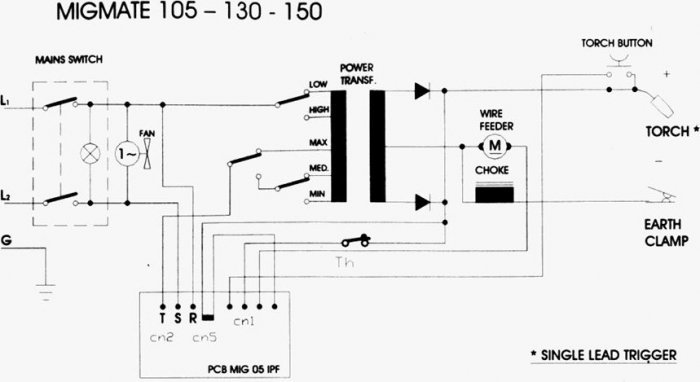

Hi ive got no motor feed on my mig ive found a wire has come loose its not the one from the circuit board to the motor but the other one not sure where it was connected
Take a look at the 3rd pic down. The RED from motor connects via a spade to WHITE wire then onto pcb. BLACK wire from motor connects via a spade connector to the stud mounted, left side of pic. Note also has the red sleeved wire going onto same stud. http://www.mig-welding.co.uk/forum/showthread.php?t=40097
