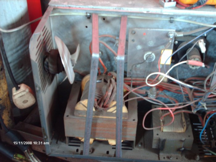

The main issue with fitting an additional power supply for the wire feed seems to be where to fit the tranny, I may have found a solution which doesn't involve chopping the casing, see what you think.
This is about the only free space inside the machine, so I think a couple of brackets are in order.

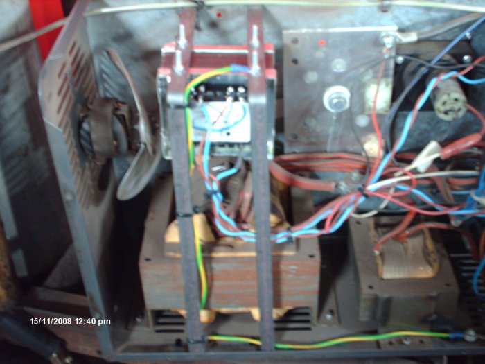

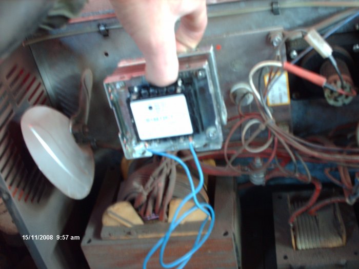

Now to fit the transformer.

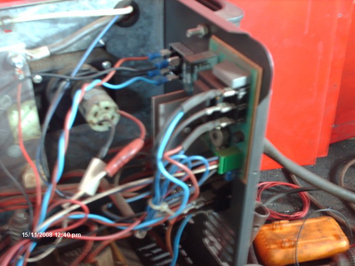

Now just wire up the feed wires and the rectifier and should be ready to go.

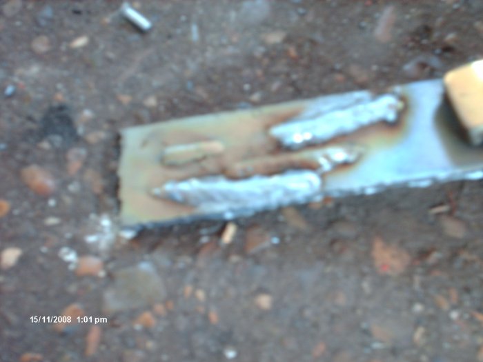

It works and this is the result, the tall narrow beads are on medium power with the wire speed to high, the shallow wide beads are at full power which I could never use before as the wire would burn back in to the tip.
