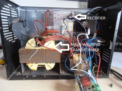

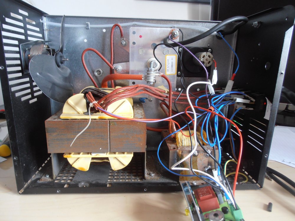

You really need to check the diodes and transformer output when your dad's finished using his multimeter.
The motor per-se won't prevent a spark happening. Going by the circuit diagram if the transformer/rectifiers are faulty neither the motor nor the arc will work.
............ if the diodes have gone and there is power getting to the main welding transformer it should be buzzing very badly when you pull the trigger,..........
very true, there are lots of possibilities without ant actual testsIf a shorted diode has since burnt itself out to an open circuit the transformer shouldn't buzz.
Hi Brian, welcome to the forum.Hi guys I am new to this forum group I have a problem with my mig welder SWP Proline 241 it's blowing the fuse 40 amps without wire or welding with it
any suggestion on this problem also anyone knows where I can find a wire diagram with the values of the compounds as the one, I have has no values at all
