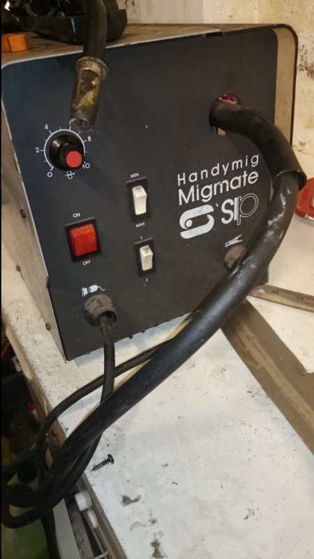

Borrowed an old sip handymate mig off my mate , hasn't been used in a while got it home , switched it on , lights up but nothing happens when I press the trigger , took the case off can't see any loose wires
Any ideas ?

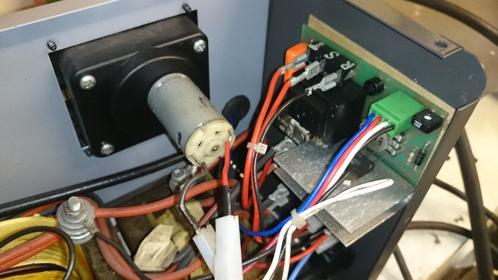

Do you have a multimeter? If so, put the probes across the motor wires with the meter set to "20-200V DC", pull the trigger and see whether you get any voltage.
If you get a reading, the motor is shot. If you get nothing, then the most likely candidate is the relay on the wirefeed circuit board.

Post a couple of pics of its guts, if you can, and we can hopefully point out whether anything looks visibly astray.

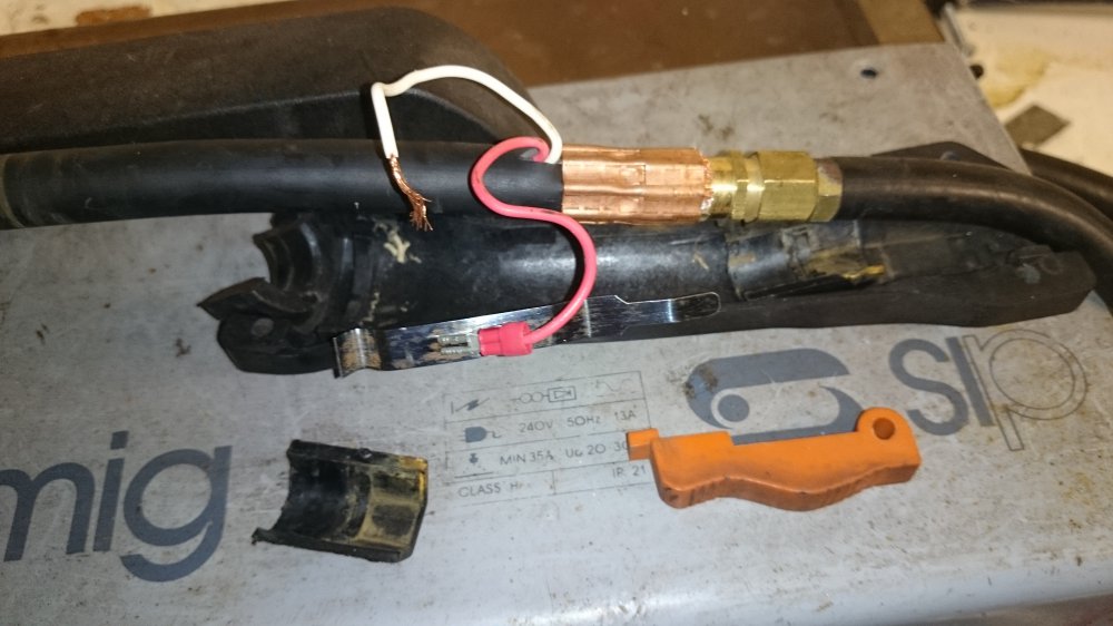

Stripped it down , white cable in torch was floating about , touched the red and white together still nothing , as I said light goes on but nothing else

I just refurbed my sip and the floating white lead bothered me as well but it's not actually used. It's either a spare for when the red dies (doubtful) or a hang up from a common manufacturing process. The circuit is completed by connecting the red wire against the brass ferrule which then travels back down the main copper in the hose.
