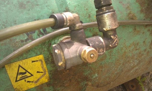

The NRV and safety valve

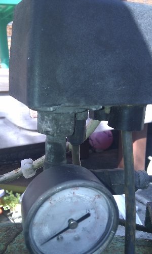

The Unloader and tank pressure gauge

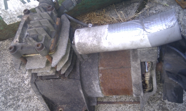

The motor - I am a little concerned by the condition of the windings
I'm confused as to whether the pump is not displacing enough air for the unloader to work properly, or the unloader valve is not working properly, or something else is wrong
